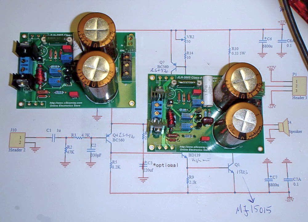

Waiting for transformer/PSU....
Arne K
I also have a lot of (about 20pcs) 63V 68000 uf panasonic capacitor. They are really great for audio amplifiers. But I don't plan to use them for my JLH since it's too large. I also don't have plan to list them for sell, because the shipping cost is too high. If one day I build a 80W JLH they'll have place to go.

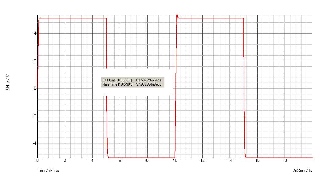

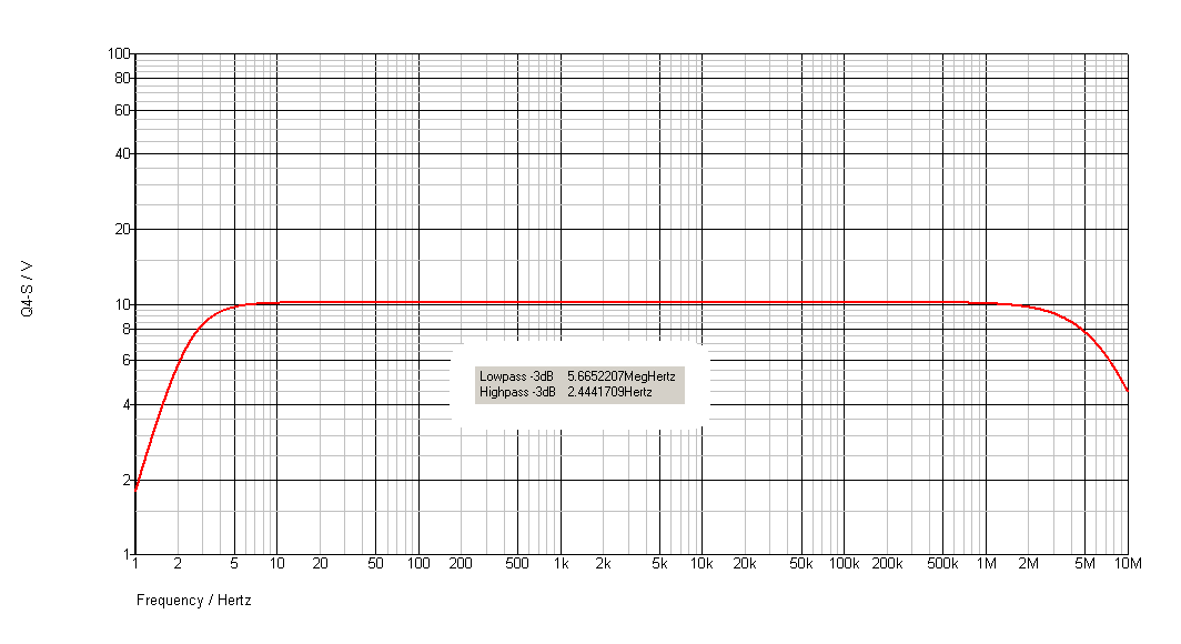

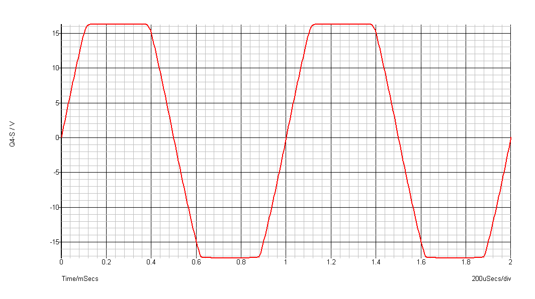

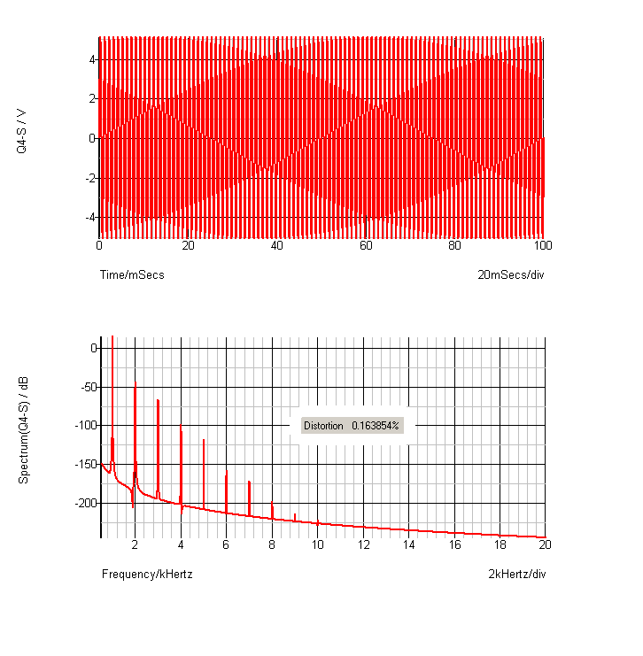

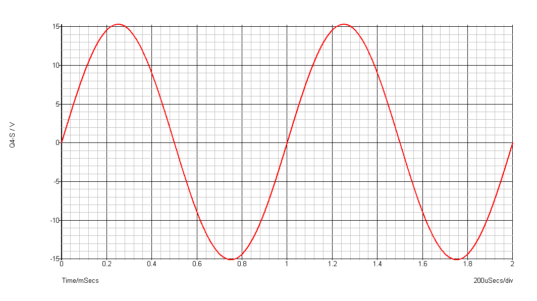

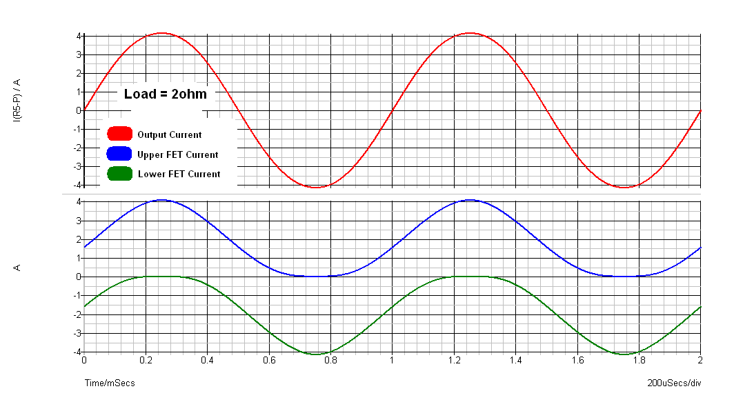

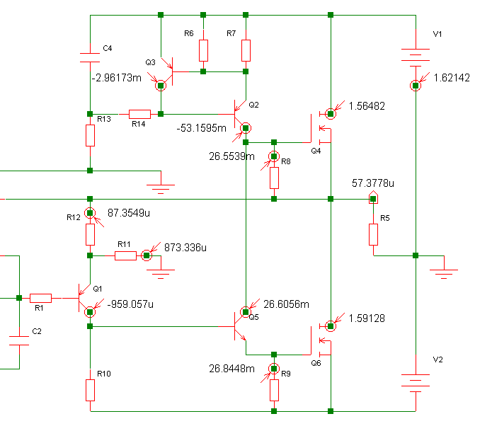

Now I am building another JLH(Actually DoZ(modified(CCS))); It's the FET version posts that made me want try it with FETs. I have some spare Laterals in stock. Last night passed simulating the planned circuit. Here are the sim results. The circuit seems to have the potential to become a great sounding amp. Got all the parts and gonna assemble it tonight.
Some observations:
1. In the BJT version the bandwidth is ~2MHz, in the Lateral one it is ~5.5MHz(expecting oscillation and gate stoppers).
2. The rise time and fall time are respectively one sixth and half of that of the BJT version.
3. The BJT version had 0.2% distortion at 10VPP into 8ohm; the Lateral has 0.16%, with decreased higher order harmonics.
4. With +-20V supply, the BJT version has maximum voltage swing of 33V(+-16.5V), the Lateral has 30V(+-15V).
5. Clipping seems as good as the BJT one.
6. Maximum current output. This is where I am surprised. The circuit seems to be able to deliver current more than 2.5 times Iq. Initially I thought I made a mistake. But after many hours of experimenting no errors were found. I ran the sim at 1.6A of Iq, both the FETs can reach 4A when the load is down to 2ohm. I expected assymetrical clipping, as usual with the BJT version. At 1.6A Iq, the voltage at the gates of the FETs is ~2.7V.
Curious and excited! I'll upload test results of the build ASAP.
