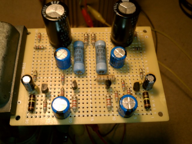

I'm almost finished with a JLH 1969 type amp and am having some issues. First, is this the right place for this or should I start a new thread? Moderators please move if necessary. Ok, in the picture below you will see one side with a 100pF cap between emitter of 3906 and collector of 4401, a suggestion for taming HF. I thought I would see which I liked better. Also, I really wanted the two sides to be symmetrical but I put the right side 3906 in upside down so I had to improvise a little. Here are the problems I'm having.
1. No audio input. When I move to the lead to the other side of the .1uF input cap I get sound but it's distorted. I checked it and it reads good on the meter,
2. The 1/2 +V is about 7vdc instead of ~13vdc. I'm guessing this is the cause of the distortion. Wrong bias?
I've checked voltages against a basic LTSpice sim that I did and things are pretty close except for the 1/2 +V and also between the 560R and the base of 2N3055. I'm only getting about 7vdc instead of the ~13vdc that the sim says.
Right now I'm using 2N3055's but will probably swap out for something better when the bugs are worked out. I'm also using clip leads between the board and output transistors. I'm using a regulated power supply and I'm reading 25.67vdc +V. I'm not sure what I should check next.

Hi Tom,
It would help if you post the exact circuit you are working to so we know what the component references are
If the mid point volts is incorrect that suggests a front end bias issue.

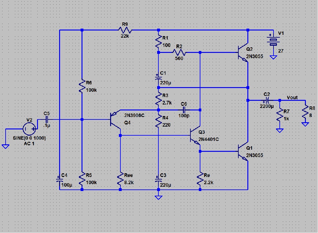

Here is the schematic that I'm working from. Nico, there are differences between the two sides. The left side was the first side I did. When I did the second side I thought it would be cool to mirror it. Unfortunately, I put the 2N3906 in the wrong way so the emitter was down and not up. I had to fudge around to make it work. Also, there is a 100pF cap on the right side. I think that was a suggestion by JLH to tame HF response. I was going to try it both ways to see.

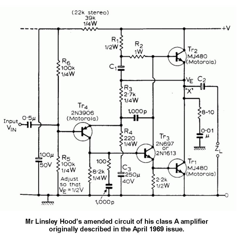

Here's the original schematic that I started from. Mikelm, your right. Here's the quote,
"(It should be noted that either all of these components
should be added or none at all, they are not alternatives.)" I guess I read it wrong. AndrewT when I simulated the circuit, I changed R5 to 113K. That seemed to give me 13.5vdc or 1/2 +V. I used a carbon comp resistor that measured 113K, even though it was a 100k. I thought that would work. I will measure across R3.
