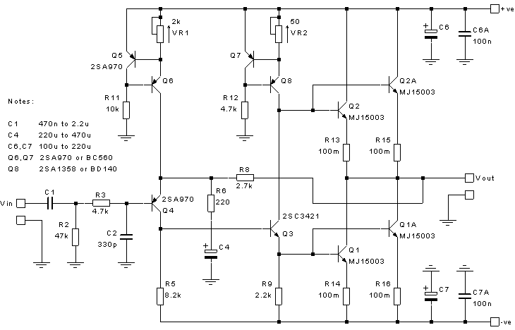

I received this from Geoff Moss when I used his PCB design to build my JLH. You'll have to check whether his VR1 & VR2 match the schematic you're using. The instructions are based on the schematic of Fig. 3 at http://www.tcaas.btinternet.co.uk/jlhupdate.htm:
As for initial setting-up, before power is first applied I would adjust both VR1 and VR2 for maximum resistance. After power is applied, VR1 is adjusted to set the output dc offset to near zero and the quiescent current (and current sharing) checked by measuring the voltages across the 0R1 resistors. If all seems well, VR2 is adjusted to raise the quiescent current to, say, 1A. After a short period to allow the transistors to warm up, the output dc offset is reset to near zero by adjusting VR1. Back to VR2 again and raise the quiescent current to, say, 2A. Wait a while and reset the output offset.
Unfortunately, the adjustments of VR1 and VR2 interact and so the setting of the quiescent current and output dc offset is an iterative process but after about four steps you should be able to get the current and offset somewhere near to the required values. At this point, it is necessary to let the amp idle for an hour or so in order to ensure that thermal equilibrium has been reached and that the amp is at its normal operating temperature. The quiescent current and output dc offset are now trimmed to the required values. These are best rechecked after a further settling period (say about 30 minutes).

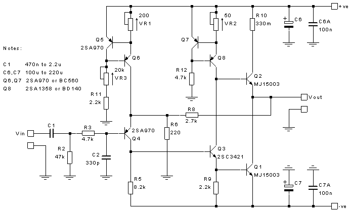

Is VR3 redundant?

DC Offset as close to 0 as you can get. What's acceptable is your decision.
Current is also your decision. Current and voltage together determine the heat dissipation in your output transistors. Your heat sink must be able to cope with that (and of course the transistors must be able to cope to).
