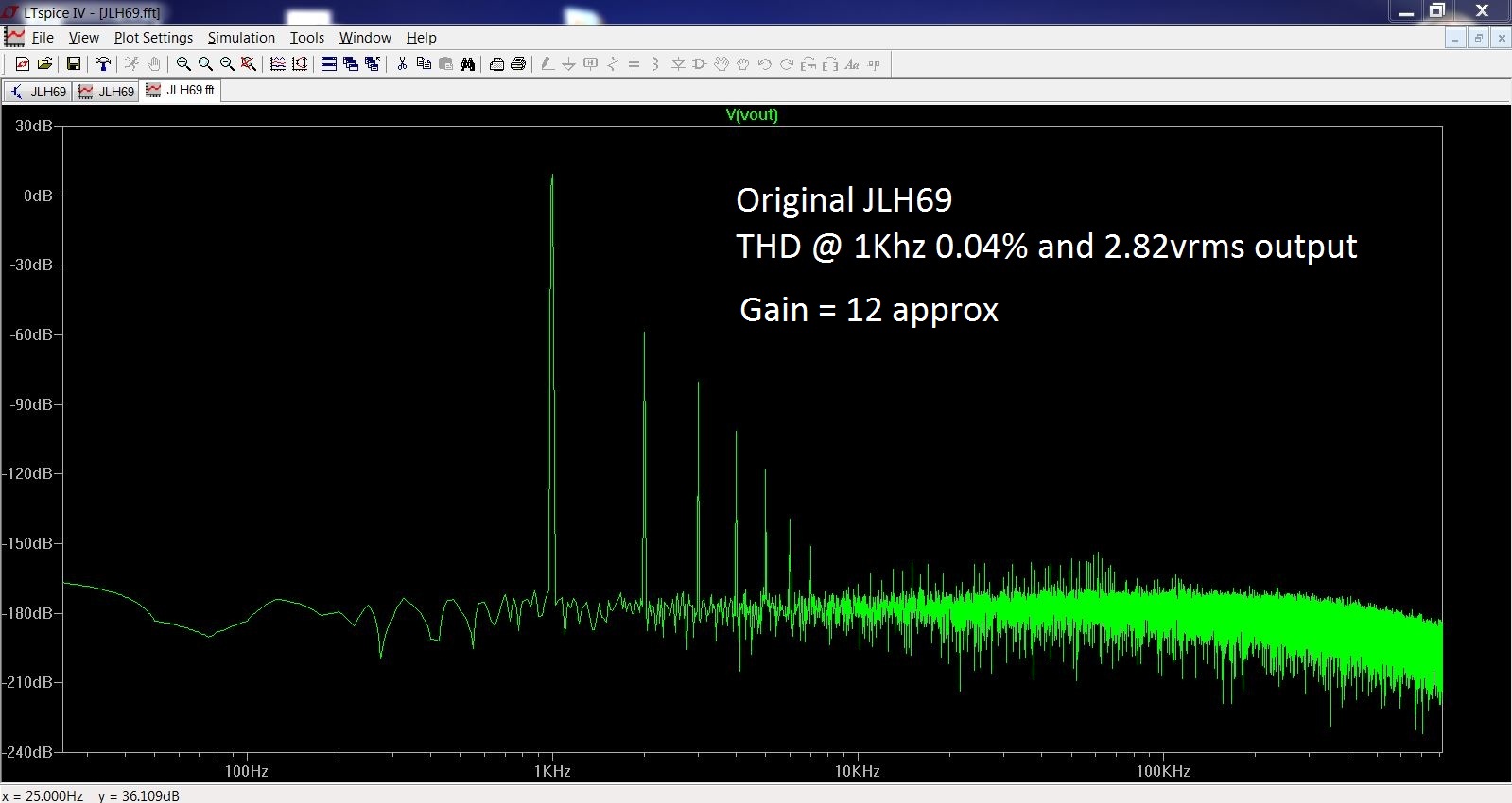

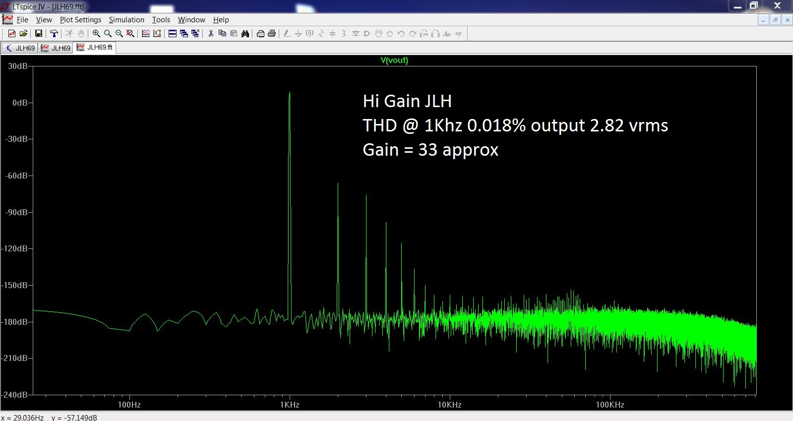

It just happens I have the original JLH69 as a simulation and so changing the 220 ohm to 82 ohm was easy to try. That changes the gain from 12 to 33. The raw numbers suggest the THD is lower for the higher gain version. You would have to increase the value of the cap in proportion.
