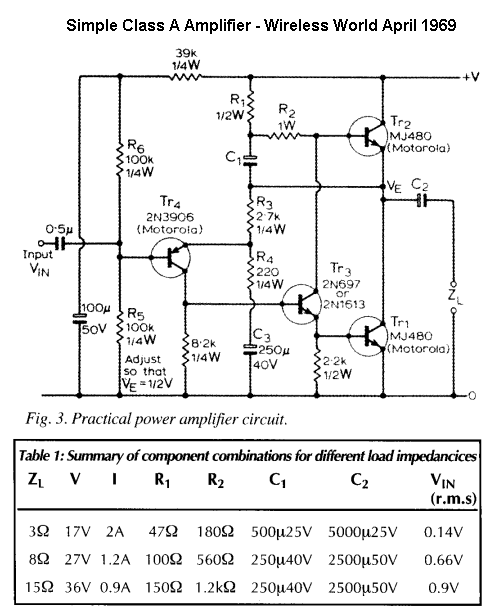

Hello . i am thinking of making the first version of JLH class A amplifier 1969.It will be my first class A amplifier. What transistor should i choose for TR3 (2N697,2N1613) and for TR1,TR2 (MJ480) ?
For TR1,TR2 i have TIP3055,MJL21194,BD249C.
For TR3 i have MJE340,BD139,2N5551,2N2219,2SD669,TIP31
This might help: The Class-A Amplifier Site - Transistor Substitutes
MJL21194 would be fine for Tr1/Tr2.
BD139 should be fine for Tr3, but ideally selected for highest Hfe (unless you can get the BD139-16 version)

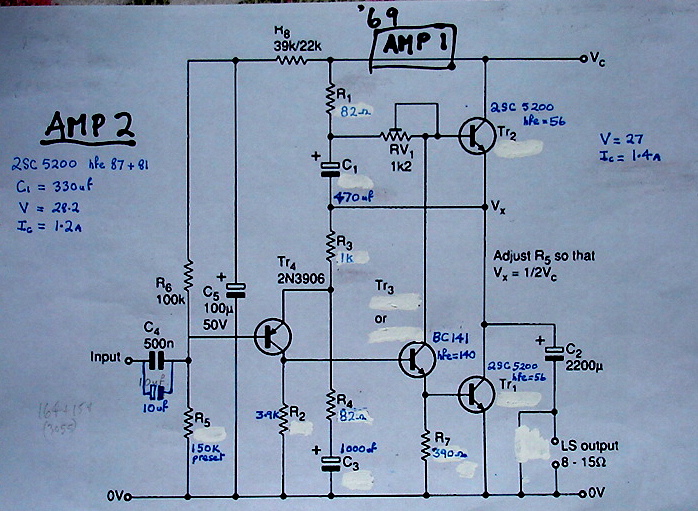

Component change?
Many years ago I built 2 x JLH '69 monoblocs. A correspondent on one site suggested (in order to improve HF response) certain component changes as shown in the diagram. You will notice that CI differ in value, this must have been my error when constructing. I invite any criticisms. The PSUs are the original '69 stabilised ones.
These are driving Quad 57s (in a small room) and sound very good.
Simulation results show a worthwhile fall in distortion from using modern output devices on the original design.
Your changes seem to indicate a further reduction in distortion but also a small but significant peak in the response at extreme HF (approaching 10MHz or so) where there was none before. As ever, you need to fully evaluate the changes, not just as a quick simulation but also when driving real loads... and the ESL is one load that demands a stable and well behaved amp.
My advice... stick to the original concept with the proviso that changing to modern outputs could be worthwhile.
