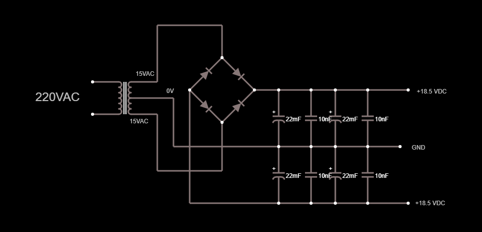

Do you think this circuit can work with the same performance even with an 18V transformer?
Thank you in advance.

18 Vrms might give 23VDC. After regulation at best 20VDC. It likely would give 5 watts of music. The LD1084 goes up to 29VDC if the adjustable version. As far as I know that's in to out. With a JLH the load is constant so should allow anything you like. If protected I have seen LM317 run at 420 VDC by Marantz on the Model 9. Some LM317 data sheets showed how. The ripple would have been 15V pp. 1Vpp/10 000 uF / amp. For 3 amps you need > 22 000 uF if using only 18 Vrms. If not the regulator will drop out. LM317 and LD1084 are generic. It's said that it is a LM741 with 1.25V bandgap and pass transistor. TL431 is if you like a DIY version. It is an op amp with bandgap. It has a feedback option or simple zener. The latter is not really the best use of it.

The LD1084 will give 20 dB better hum reduction over the JLH PSU. It's lower drop out without the problems some low drop out can give.

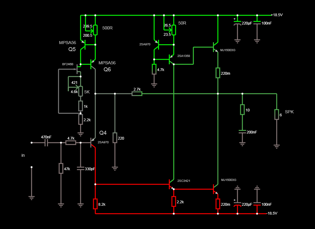

I never had the courage to use a no regulator JLH. It can work as the JLH has some ripple rejection.
If JLH has 40 dB ripple rejection and PSU ripple is 0.8V using 22 000uF the ripple would be 8mV at the speakers. That's 60dB below full power. It will be heard on quiet music. When class AB it will not as power use is minimal when quiet. Class A is always full power. If AB the PSU colouration is hidden under music. In truth it isn't.
I would use the same 22 000uF for the LD1084 PSU as the heat burn off can be kept lower if only 0.8V. You might say 3VDC loss is realistic. That's over 10 watts to get rid of.
If very careful I found LD1084 can exceed it's book specifications. I had 70dB rejection. It was 1.5 amps which is not far behind what we need. -102 dBV or more like - 120 dB of full power. That's 60 dB better for same 22 000 uF.

Variants were published when a filtered (stabilized) voltage was supplied to the JLH. But the collector of the upper output transistor can be powered separately by the unregulated voltage of the C-R-C filter. The disadvantage is the increased power dissipated by the transistor.
Of all the regulators I tried LD1084 is least trouble and low cost. It's no more trouble than a LM317 and fits ready made PCBs. LM317 despite being low tech is a very nice sounding device. It's popular for a reason. LM78 series are lower current. The hiss of LM317 is that of a 1.25VDC device. 20 dB better than LM7812. 26 dB when the 24V type. Hardly important but a nice bonus. It's due to thee 10uF ( 470 in mine ) hiss filter.

Mine is working without regulator. I just use my ears to measure noise and is quieted enough for me. 4 x 4,700 Elna audio capacitors.
