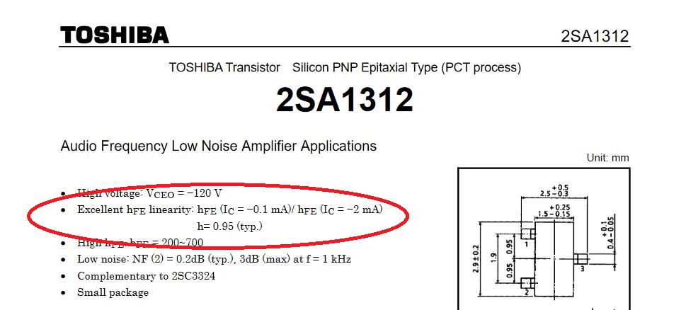

I guess it's a much better fit with my own intuition, to talk about "constant beta" rather than "gain linearity", since linear equations practically never have zero slope.
"linearity" means that the derivative of (Thing1) is constant with respect to (Thing2). Thing1 is a linear function of Thing2. But when the hoped-for linear function is
  • Thing1 = (0 x Thing2) + Constant
I kind of feel that it's misleading to talk about the "linearity" of Thing1. You want Thing1 to be CONSTANT, not linearly proportional.
I guess the definition of Toshiba is good enough for all of us ?
Patrick

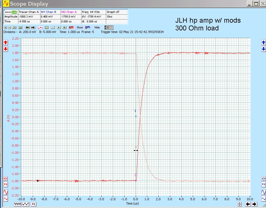

OK, here are a bunch of mesurements.
First, for the time-domain-ophiles, leading and trailing edges are clean and symmetrical. No issues from the lower gain. The little seemingly-random packets of noise on the trace are interesting - this was done completely unshielded sitting on my test bench. Maybe they're wifi packets from the transmitter sitting 12 feet away?

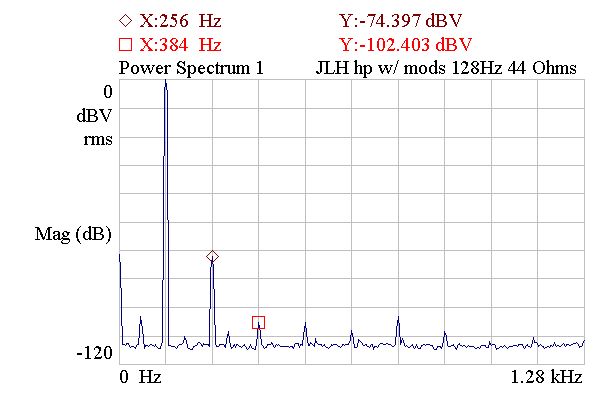

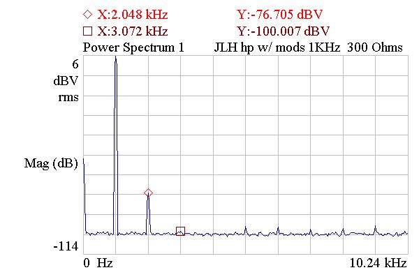

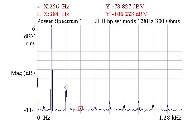

Now some distortion spectra. For comparison, the orgiinal measurements I made are here:
JLH Headphone Amp
They were after fixing the grounding issue, but mostly stock otherwise. I didn't post 100Hz measurements (128Hz, actually) then because they were identical to the 1kHz ones.
Into 300 Ohms, here are 1kHz and 128Hz. Distortion is 1.5dB worse at 1Khz. The noise floor dropped a couple dB, which is good.
Distortion at 128Hz measures a couple dB better than before. Certainly not enough to explain the improvement in sound, though. Except for the 60Hz, powerline harmonics are buried in the noise, so the grounding scheme works well.

Being a time-domain-ophile, I like to look at two square wave responses.
#1 is the J. Peter Moncrieff response: Apply 19 Hertz square wave input with sub-5-microsecond risetime and fall time. Plot output. Does the output "square wave" flat top and flat bottom exhibit any droop at all? (is there any DC servo at all?) If there's droop, is the output waveshape "flat top" error: linear, quadratic, exponential, or dogmeat?
#2 is the Nelson Pass response: Apply 200 kHz square wave input at sufficiently low amplitude (< 100 mV pk-pk for amps made with all-BJTs) to avoid hard slewing. Input risetime and fall time should be sub-5-NANOseconds so this requires a dedicated piece of professional test gear not a dormitory freshman's Android phone with an app. Plot the output. Is there overshoot? Slow or VERY slow settling to 1% and 0.1%?

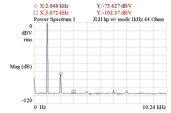

Into 44 Ohms we see some definite improvement.
At 1kHz, H2 is 5dB lower. And at 128Hz it is 4dB lower than before. This correlates with what I hear, the modded amp does sound better with the 44 Ohm 'phones.
So except for the 44 Ohm results, I have to say that these measurements do not capture the magnitude of improvement in sound that has occured from these mods. Which is a bit of a disappointment.

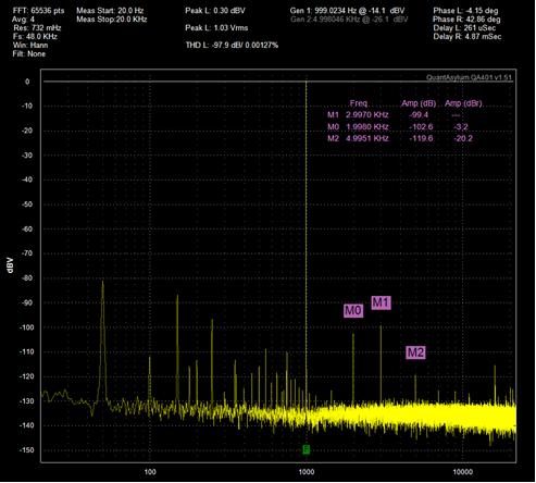

The bench mark I use for headphone amp is better than -90dB THD at 1Vrms 1kHz into 32R.

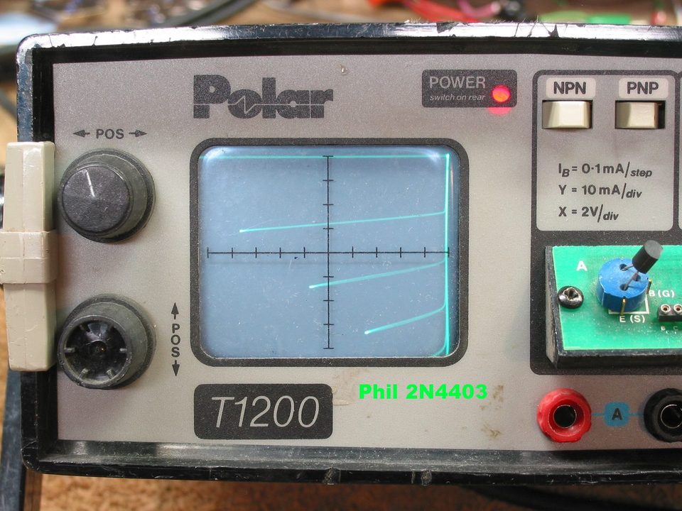

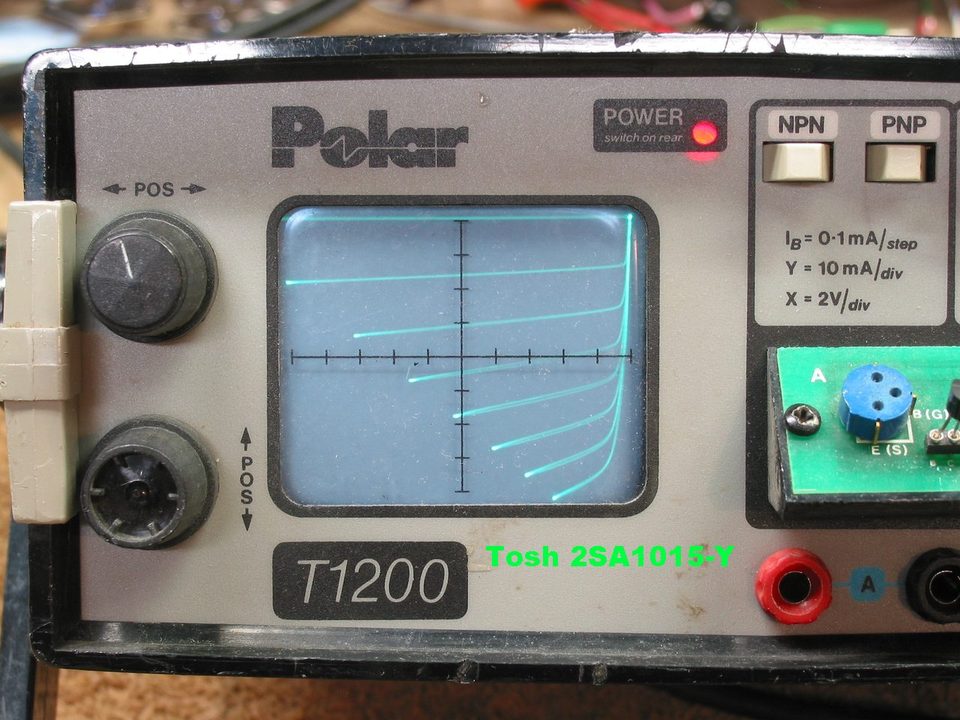

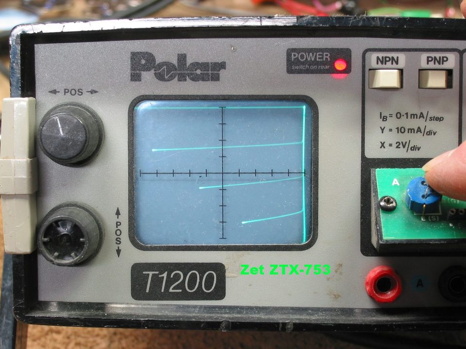

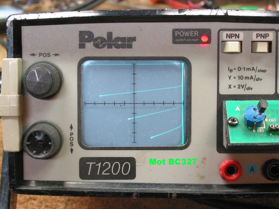

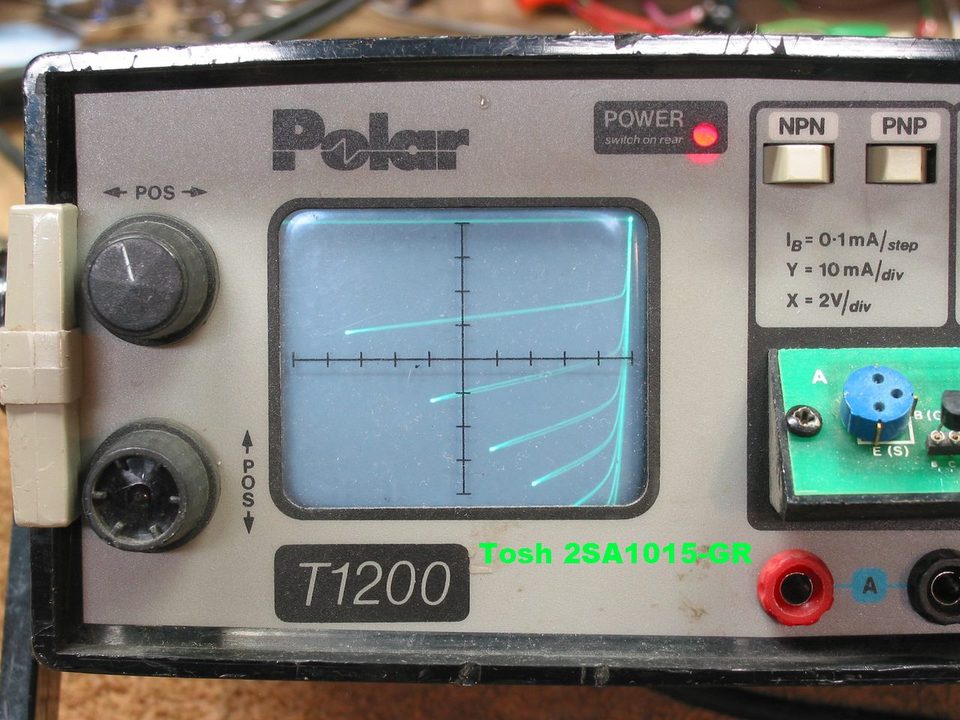

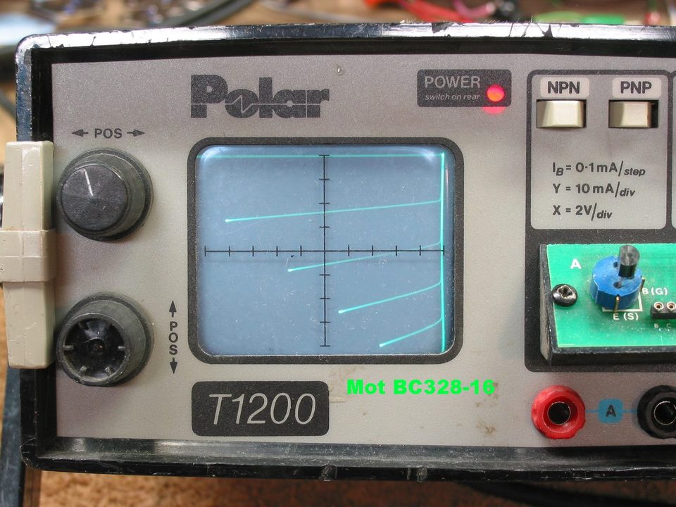

The NEC 2SA733-P's arrived yesterday. I decided to do some measurements before listening, and tested Hfe vs Vce for gain linearity.
I started with the Toshiba 2SA1015-GR, which I've been listening to for a couple days now. The nonlinearity was obvious. This looks like a "constant compression" device. Quite contrary to the data sheet curves.
So I decided to look at a bunch of various PNP's that would be possible candidates for the input position. Pics are labeled.
: Toshiba 2SA1015-GR
: Toshiba 2SA1015-Y

: Motorola BC328-16

Continued next post
2nd pic is the Y grade A1015. Nonlinearity is much improved but still present.
3rd pic is the NEC A733-P. Much better than the 1015-GR.
4th pic is a NOS Philips-branded 2N4403 from a sampler pack that I got 20+ years ago. Linearity is better still.
5th pic is a Motorola BC328-16. A little lower Hfe but decent.
6th pic is a Motorola BC327. Looks almost exactly like the 2N4403.
Last pic is a Zetex ZTX-753. I don't know if it is a possibility for the input, I don't have noise specs for it, but it has the best linearity of the bunch.
I installed a couple of the NEC A733's into the amp, and the tonal character was much improved. The clarity and openness now extended up into the midrange. Gone was the "smiley face" fat bass and edgy highs. That was all being caused by the A1015-GR.
I wouldn't be surprised if the 2SA970 was the same. The data sheet Hfe curves are the same as the 1015.
So the A733 is a much better transistor for this purpose. But having heard now what difference the gain linearity makes, I'm pretty sure even it can be improved upon.
My sense is, the high-Hfe grades of these transistors are well-suited for low-level signals. But with 2+VRMS at the input, linearity matters more.
Your thoughts?
Horowitz and Hill performed their own measurements of Beta versus Ic, and published the plots in their book "The Art Of Electronics", third edition.
The PNPs whose (Beta vs. Ic) curves look the absolute flattest in their tests, in my opinion, appear to be
2SB1690K, 2N5087, 2SA1312, 2SB1197KR, 2SB1241, 2SA1175, MPS8599
Thanks for that list. The 2N5087's I have here look not so great. I have some 8599's here but haven't found them yet. I'll have 1312's by Friday.
BTW, 1KHz distortion measures no different with the A733 vs the A1015. Yet the sound is markedly different.
I have no problems reading all the numbers with my 60+ year-old eyes. 😉
So I failed your reading test... big deal...
What was the input signal level and gain on your test?
