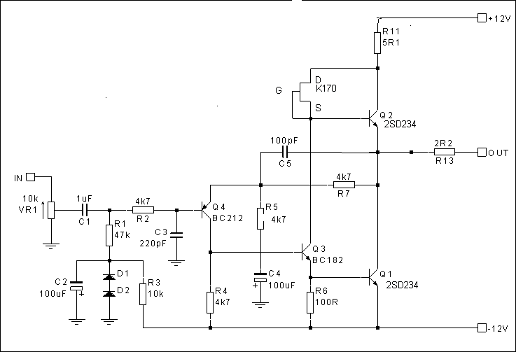

K170 CCS
Oh dear I've been experimenting again. 😱
I had to mess around a fair bit to get the bias sorted out.
R6 sets bias current 110R = > 75R = <
Ive set bias at 50ma
And its sounding pretty damn good.
Offset is stil using LM336-2.5 and a 10K trim pot.

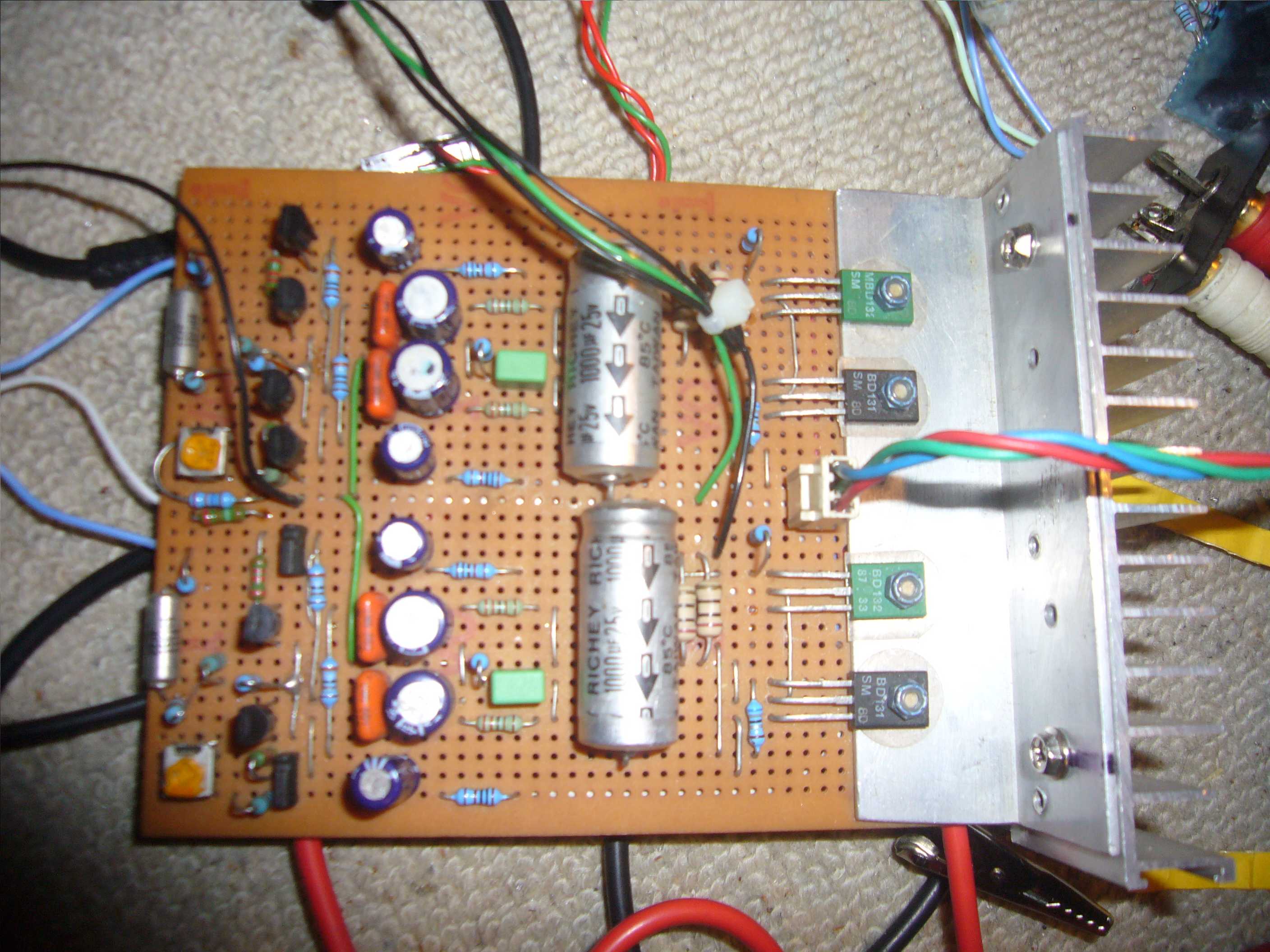

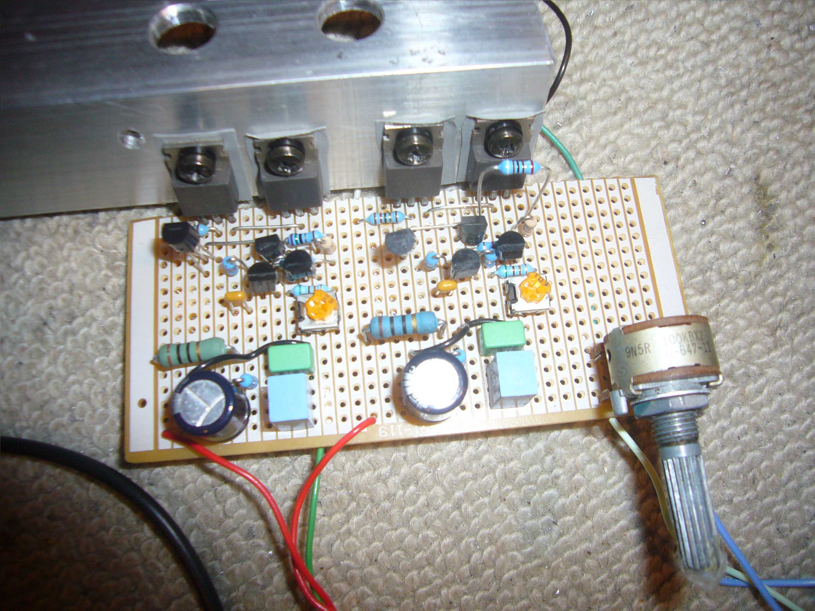

Unbelievable
Hi Miles, I just had a look at Alongs new board on ebay, and could not believe he had changed the input caps to foils and then bypassed with a ceramic. 😕 😱
My so called JHL has been shelved.
As I much prefer my stripboard version.
Don't know if it's because of the P2P like construction or what: 😀

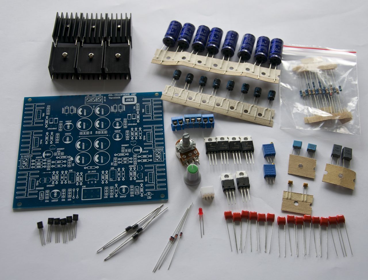

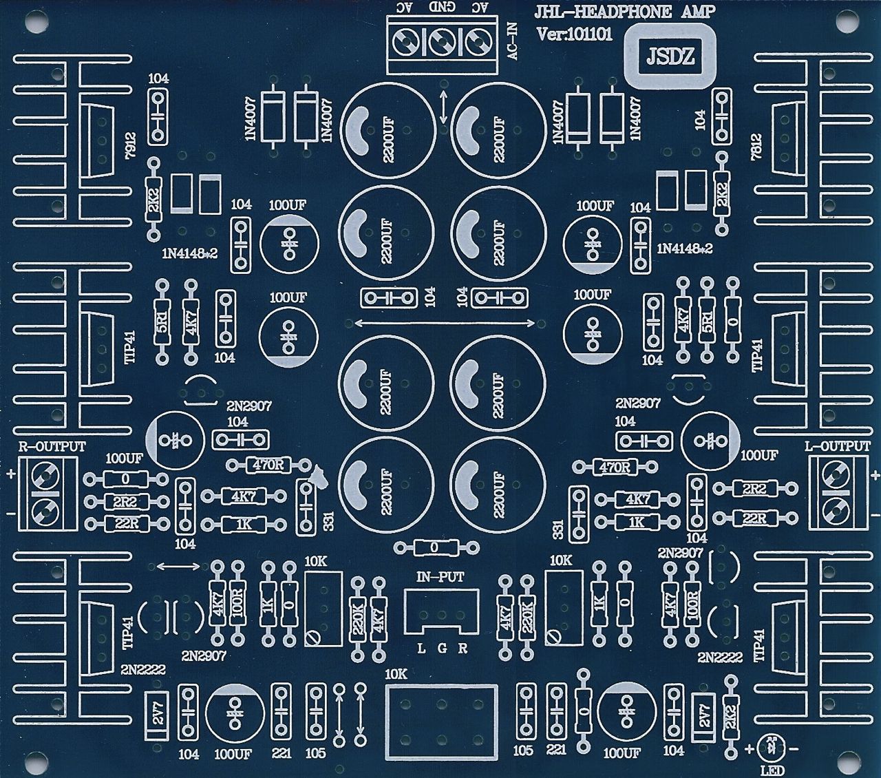

Step by step - JLH Headphone Amp build
This will be a step by step build of the JHL Class A headphone available on ebay from this seller. The service was excellent, the delivery was very quick and the combined postage was a bargain - 4 off JHL kits and 1 off USB DAC assembled.
These kits are a copy of the John Linsley Hood Class A headphone amplifiers that can be found documented here here This is a brilliant website for anything class A and JLH. These designs originally appeared in various Hi-Fi magazines and Wireless World through the 1980's.
The design methodology presented is not the most upto date thinking, but something I have always wanted to build. A well documented starting point if you will.
The plan is to make a number of these to compare the results
Picture List
Comments : The PCB is of good quality, the layout has a number of issues with a number of wire and zero ohm links in very unfortunate places.
In Summary : I think this is a GREAT kit for less than £15GBP but as will be shown there are a number of small issues to overcome in the build.
Miles
- As supplied
- JLH Circuit I
- JLH Circuit II
Picture List

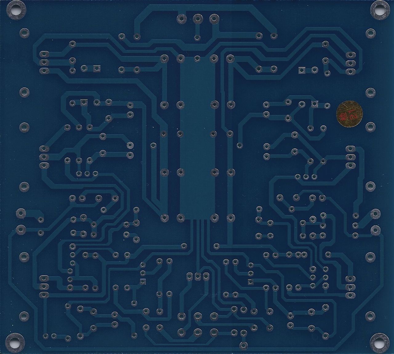

- The kit as supplied
- PCB Silk screen layer (Top)
- PCB Copper Side (Bottom)
Miles

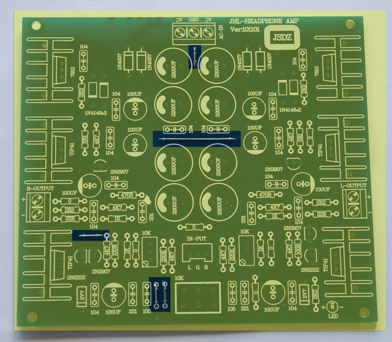

Step 1 and 2 : Wire and 0 ohm links
Pictures List
Comments
Tips
Pictures List
- Wire links
- Zero ohm links
Comments
- The zero links provided when measured were 0.5ohms so tinned copper wire was used
- I missed a link on the board, in the lower centre, pleased don't make the same mistake.
Tips
- To get the wire links straight S-T-R-E-C-H the tinned copper wire, hold one end in the vice and the other end in a pair of pliers .. Be careful at some point it will snap and you are left with very straight links.
- Bend the link to the correct size, place in the board. Then turn the board over to solder the link, holding it place with the reel of solder.

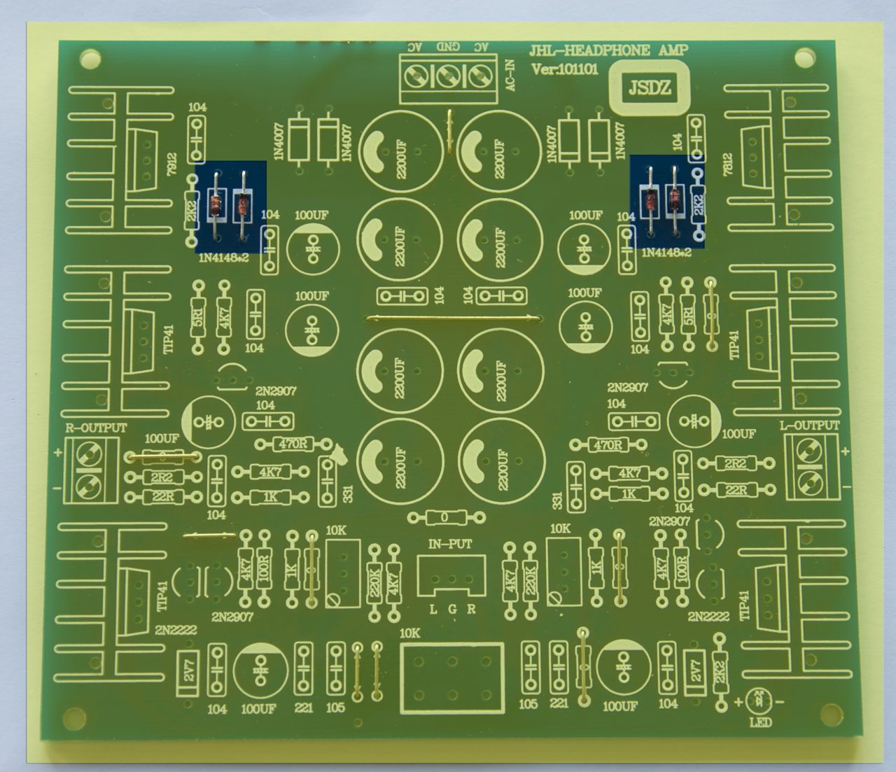

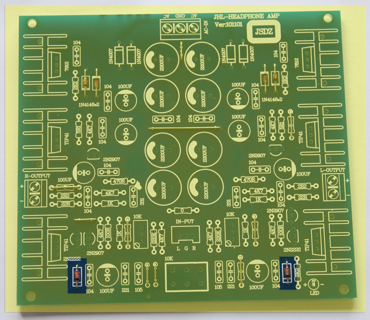

Step 3 and 4 : Small signal diodes
Picture List
Comments
Tip : The easy way to achieve crisp bends in the diode legs is to use, small snipe nose pliers
Picture List
- 1N4148 - 4 off
- 3V Zener Diodes - 2 off
Comments
- BEWARE The 1N4148 and zener diodes look ALMOST the same!
- The 1N4148 is marked in very small letter "4148"
- The zener diode is marked C3V0 (The circuit diagram requires a 2.7V zener diode)
- The are 4 off 1N4148 in the kit and only 2 C3V0
- Both the 1N4148 and the zener diodes have a right and wrong way to be insterted in the board
- Both types of diodes have a dark colour strip or ring this should be matched to the marking on the PCB.

Hello Steve
One of my outstanding jobs is to re-draw the schematic, but the original is attached .. Hope that helps
Please let me know how you are finding the SbS, I will do my best to help if you get stuck ...

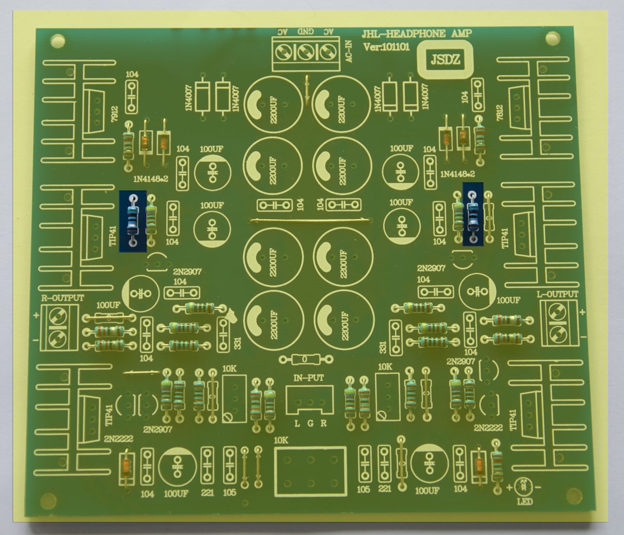

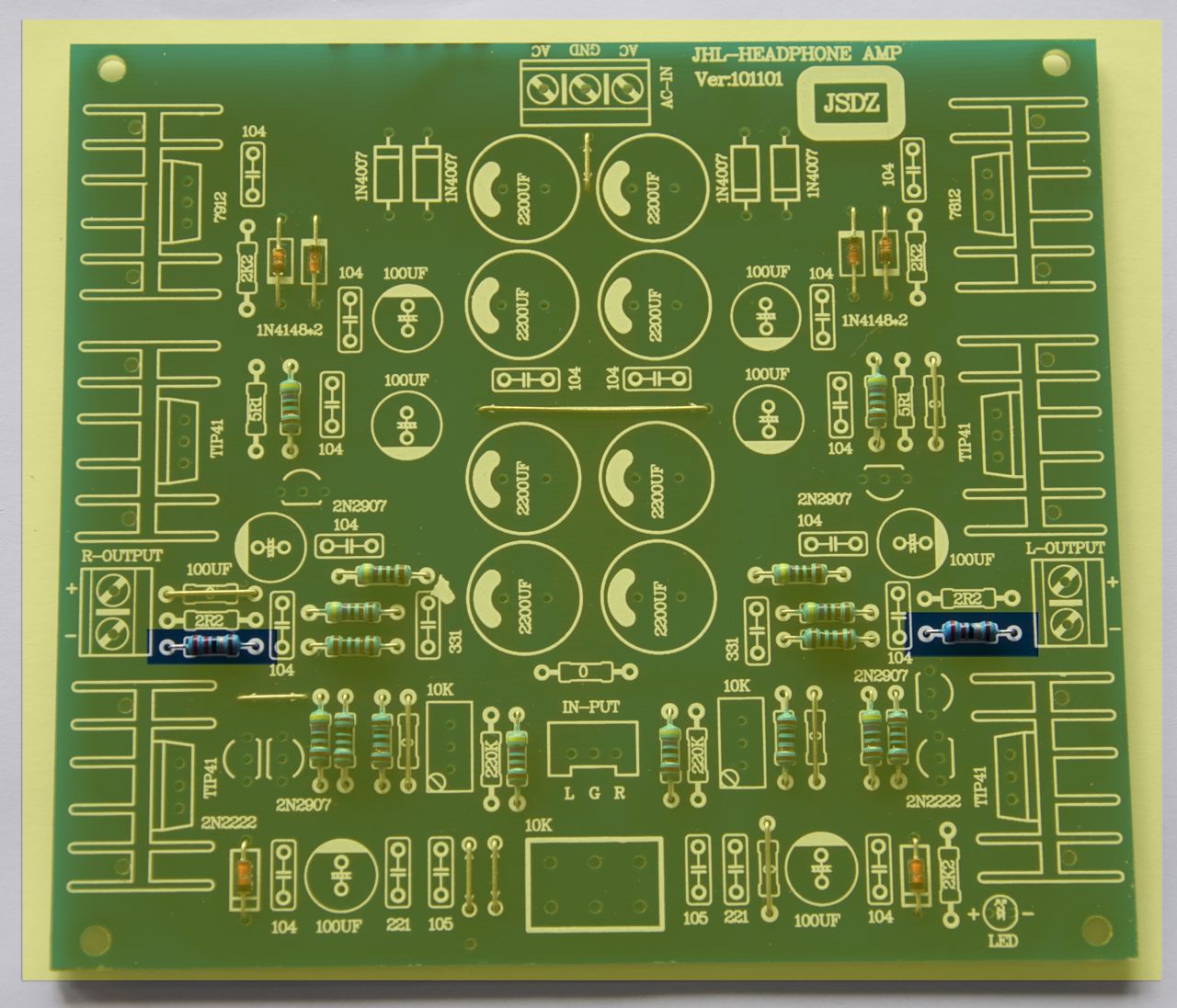

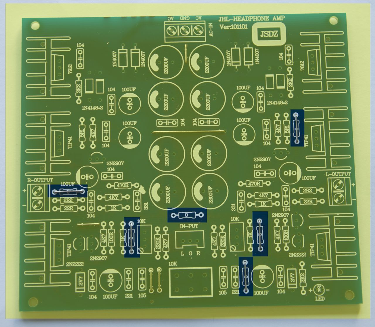

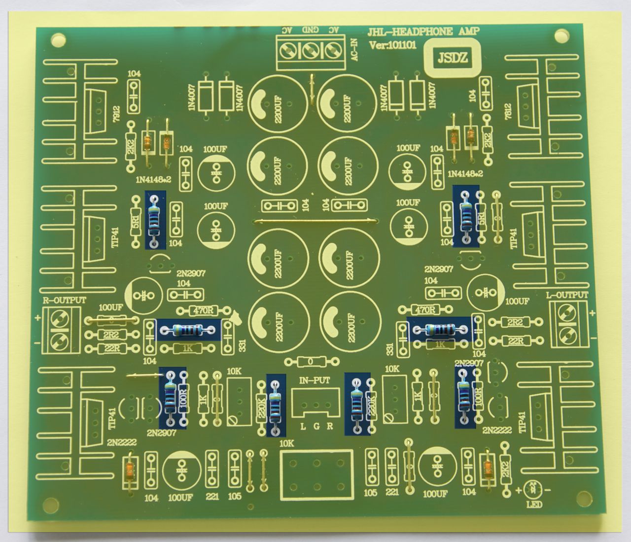

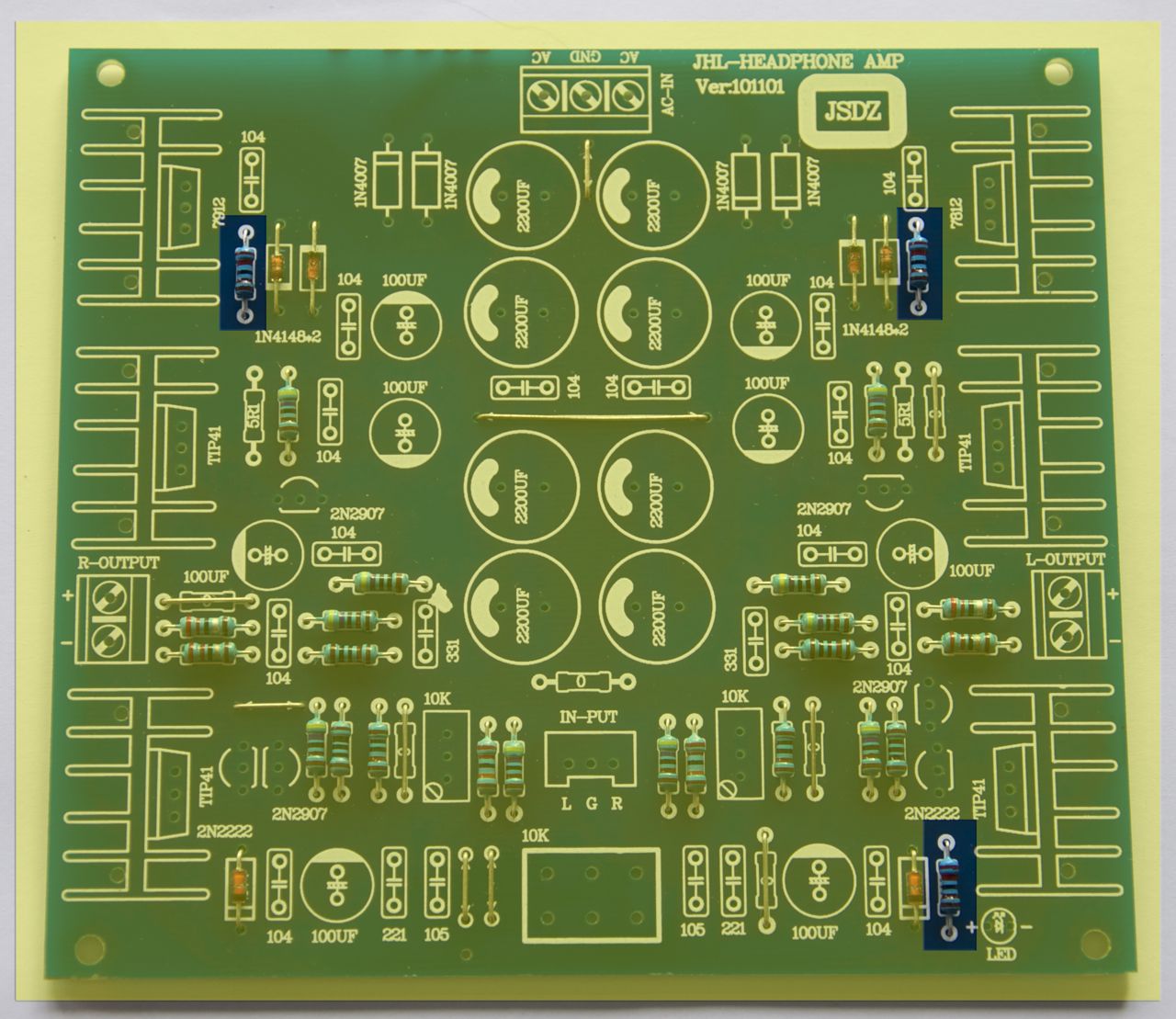

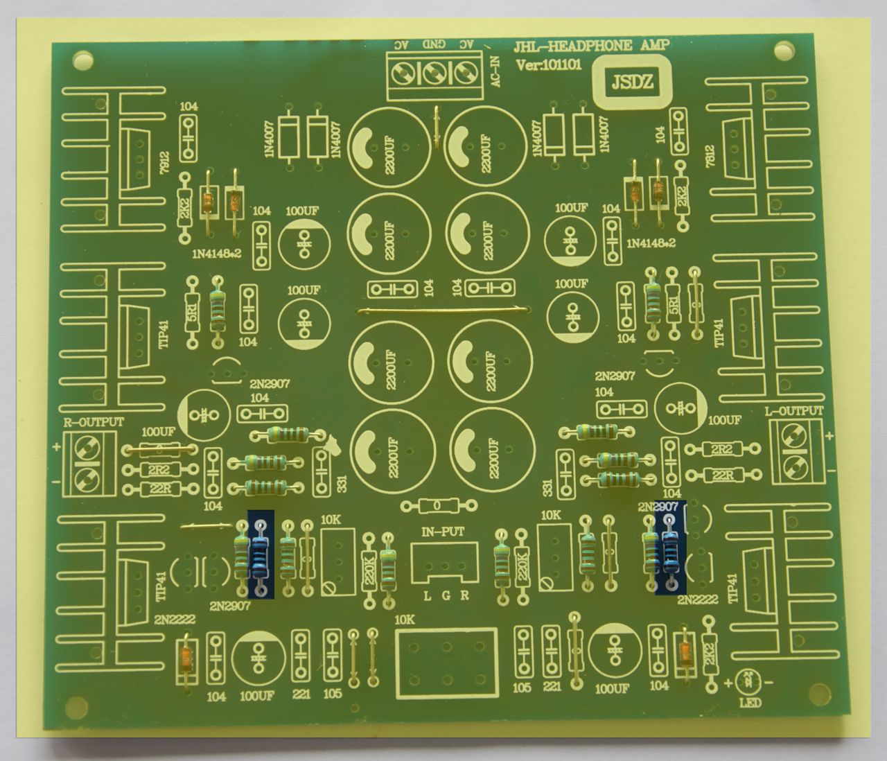

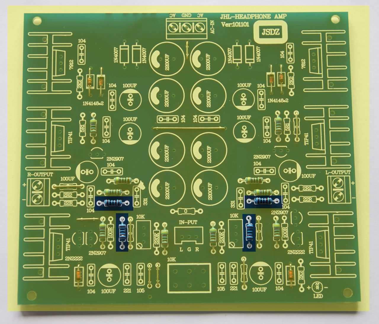

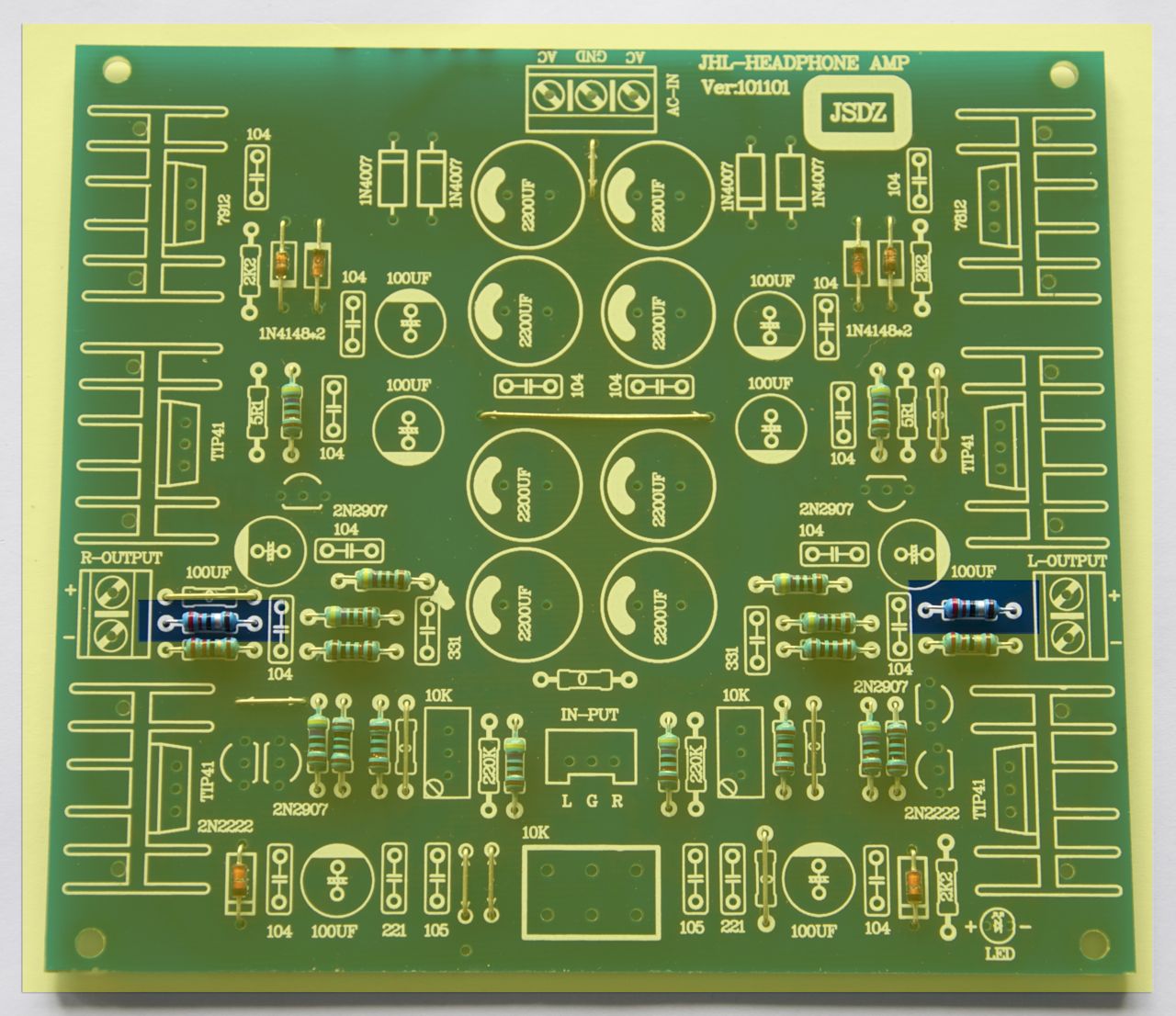

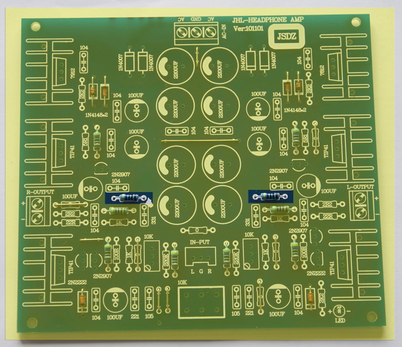

Step 5 and 6 Resistors and rectifier diodes
I have made a mistake in the original build order in post 115 step 5 and 6 have swapped places. Please be assured this makes no difference to your build, it was just a typing error.
Picture List
Comments
Tip
Note to self : Next time for the resistors apply the resistor value to each picture with Photoshop!
Picture List
- Resistors 4k7 ohms - 8 off
- Resistors 470 ohms - 2 off
- Resistors 1k ohms - 4 off
- Resistors 100 ohms - 2 off
- Resistors 22 ohms - 2 off
- Resistors 2R2 ohms - 2 off
- Resistors 2k2 ohms - 3 off
- Resistors 5R1 ohms - 2 off
Comments
- The resistor colour codes can be very confusing when they are seperated by powers of 10 eg : 2R2 or 22 or 220 or 2k2
- Just to be clear 2R2 and 2.2 ohms are the same value therefore 5R1 and 5.1 ohms are also the same value.
- CHECK and DOUBLE CHECK - The particular resistors in these kits seem to have very little difference in the RED BROWN and BLACK band colours.
Tip
- To prevent confusion with the resistor values I measure each strip with a DVM
- These are then laid out on a piece of paper on which all the values are written.
- Each value is only CUT from the strip when it required
