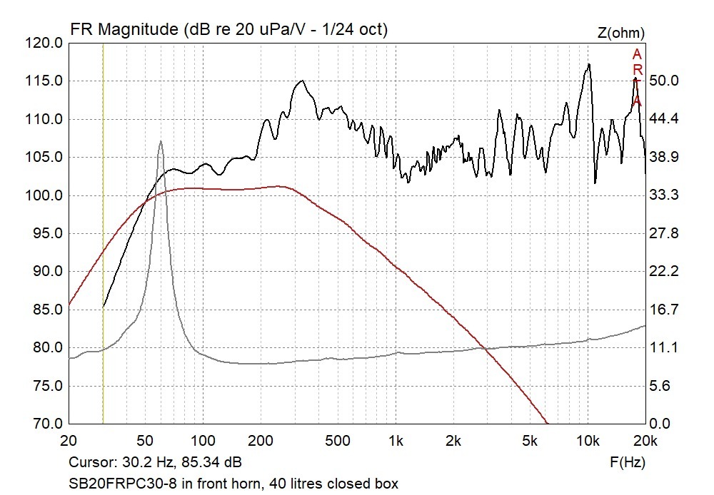

24cm long JMLC horn for 8" fullrange. Red is Hornresp simulation. Measurement at the mouth.
I got similar results with a modified 8 inch Lowther PM2 in a 60x60x54 cm horn, very uneven response. The best measuring driver was the JBL CMCD. Much thanks to its phase plug. But tonally, a bit weak.
The fullrange Lowther had everything going for it, light cone, huge magnet, but I think it is the suspension that is too weak for a fullrange to be a good «compression driver». And the paper is often flimsy, at least the whizzer cone.
And your point is, exactly?24cm long JMLC horn for 8" fullrange. Red is Hornresp simulation. Measurement at the mouth.
Why did you quote me there?
I was referring to Holland and Newell's article, which was clearly about horns for compression drivers, and where the authors made some generalizations that were IMHO not well supported by the evidence.
You posted your sim and measurements of a short horn loading an undisclosed (and whizzer-cone equipped?) 8" fullrange. Not sure how this is relevant or in which way it either proves or disproves what I was saying.
I'm honestly confused - not trying to start an argument!
Well, I think maybe someone will find it interesting but ok not in this thread maybe. I can only say that horn like this must be properly equalised. Longer horns usually have "horn sound" because of directivity sonogram character. No, 8" driver is enclosed to see low end response compared to Hornresp sim.
Drawing conclusions that aren't wholly supported by the data is unfortunately all too common, but in cases like these where the experiments and results are shared quite openly the reader can decide how much weight to give.To me, this comes across as an admission that their theorised correlation between throat impedance plots and sound quality does not hold water... or at the very least, that there are more factors at play, some of which may end up being more relevant in the grand scheme of things.

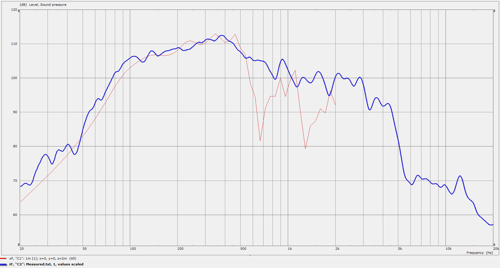

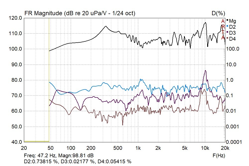

weird this is a horn I built compared with a BEM sim:
using a 15" driver and not in a totally reflection free environment (large factory). The sim is accurate to the point where the cone diameter cancelation notch occours just beyond 500Hz (no phase plug).

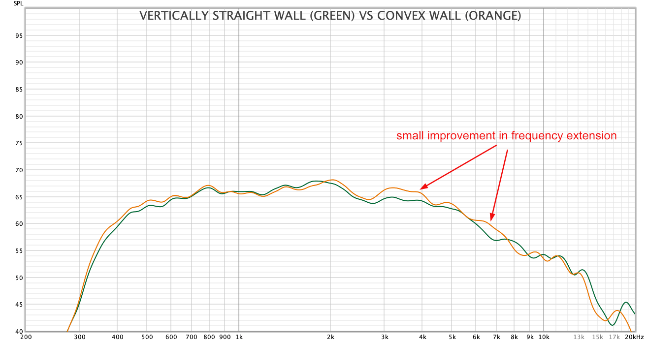

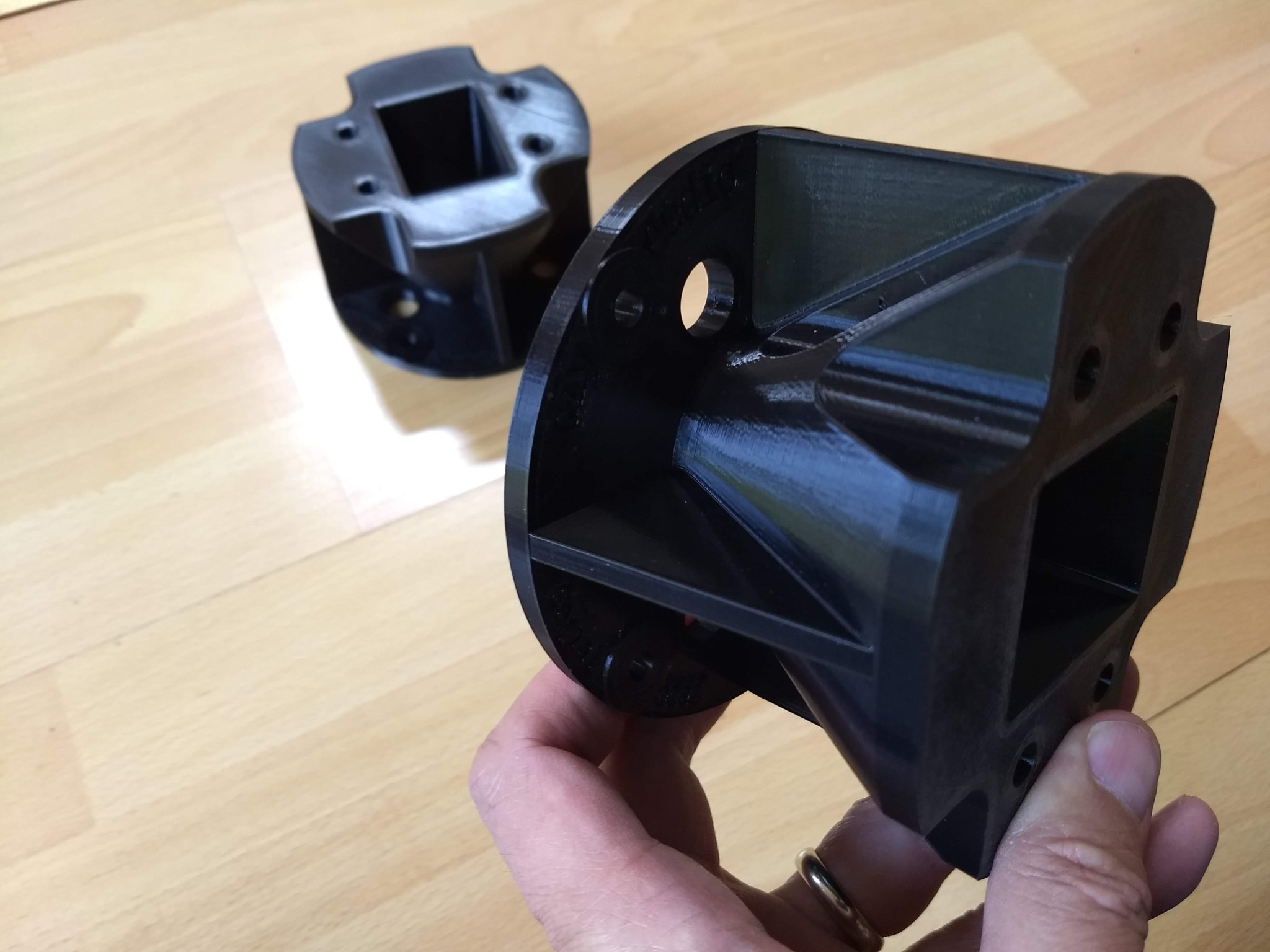

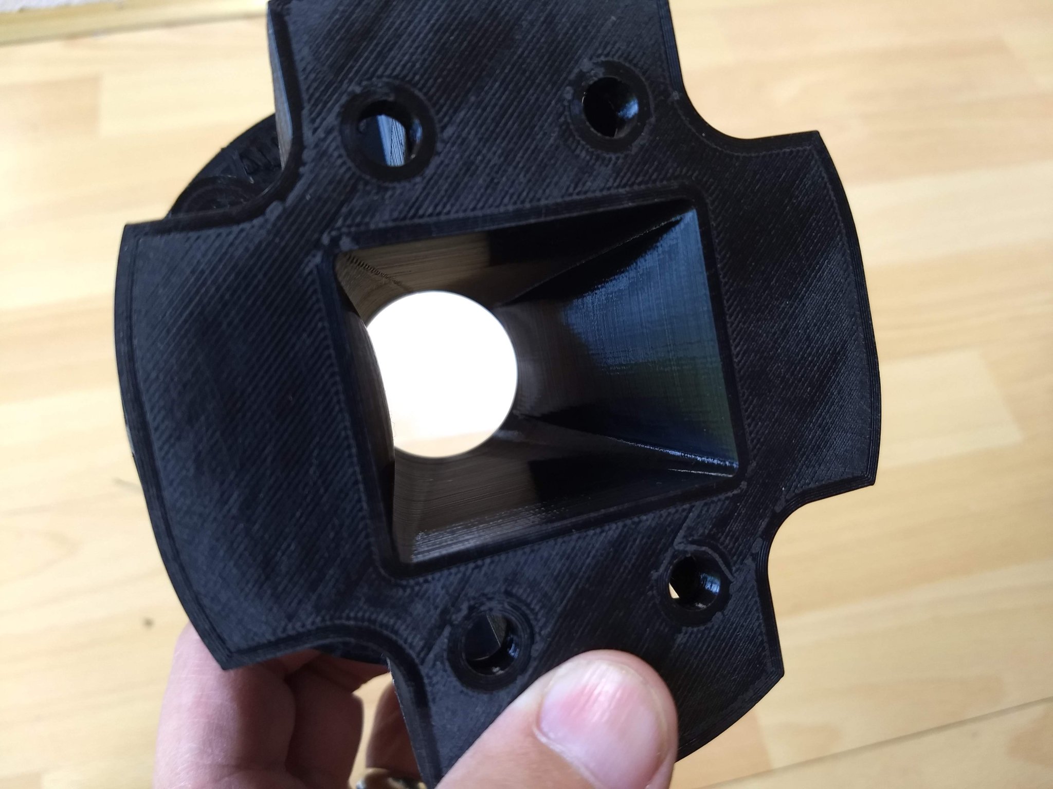

Response measurement of throat adapter Prototype #2.
In Post #186 two objectives were laid out for converting a circular to a rectangular surface area.
1. Getting the correct surface area profile for the objective hypex T and Fc. One can achieve this easily by adjusting the width between the adapter walls along its profile. The walls can be vertical (no convexity) with roundovers near the roof and floor.
2. Shaping the spherical wavefront to a cylindrical wavefront. Vertical walls are problematic here, since speed of sound being constant, the synchronized wave edge on the circular entrance then arrives at different times on the vertical exit wall, and thus does not produce a cylindrical wave front at the exit. This is more tedious to solve and involves tradeoffs.
Adapter Prototype #2 (Posts #169, #191 and #201) implements the idea of equal length arcs on the side walls from circular entrance to straight vertical exit (Post #168). Its convex walls (bumps when viewed from inside or dimples when viewed from outside) aim to satisfy #2 above.
Shown below is measurement of 3D-printed adapter Prototype #2 compared to my first printed adapter that had vertically straight walls and a hypex flare profile (Post #127 to #133). The two adapters were measured on the same horn and driver unit without filtering or EQ. Their flare rate profiles differ slightly, so this is not a perfect experiment, but because the on-axis measurements are close to identical (as shown below), I believe that the off-axis differences can be attributed to the vertical convexity of the Prototype #2 walls. Recall that the driver exit is 1.4 inch and horn entrance 40 x 50 mm. Psychoacoustic filtering was applied to all curves to make differences between adapters more visible.
Measured response of the convex wall versus vertical wall adapters measured near the left edge and middle elevation of the horn mouth. Reference Prototype #1 is shown in green and new Prototype #2 in orange.

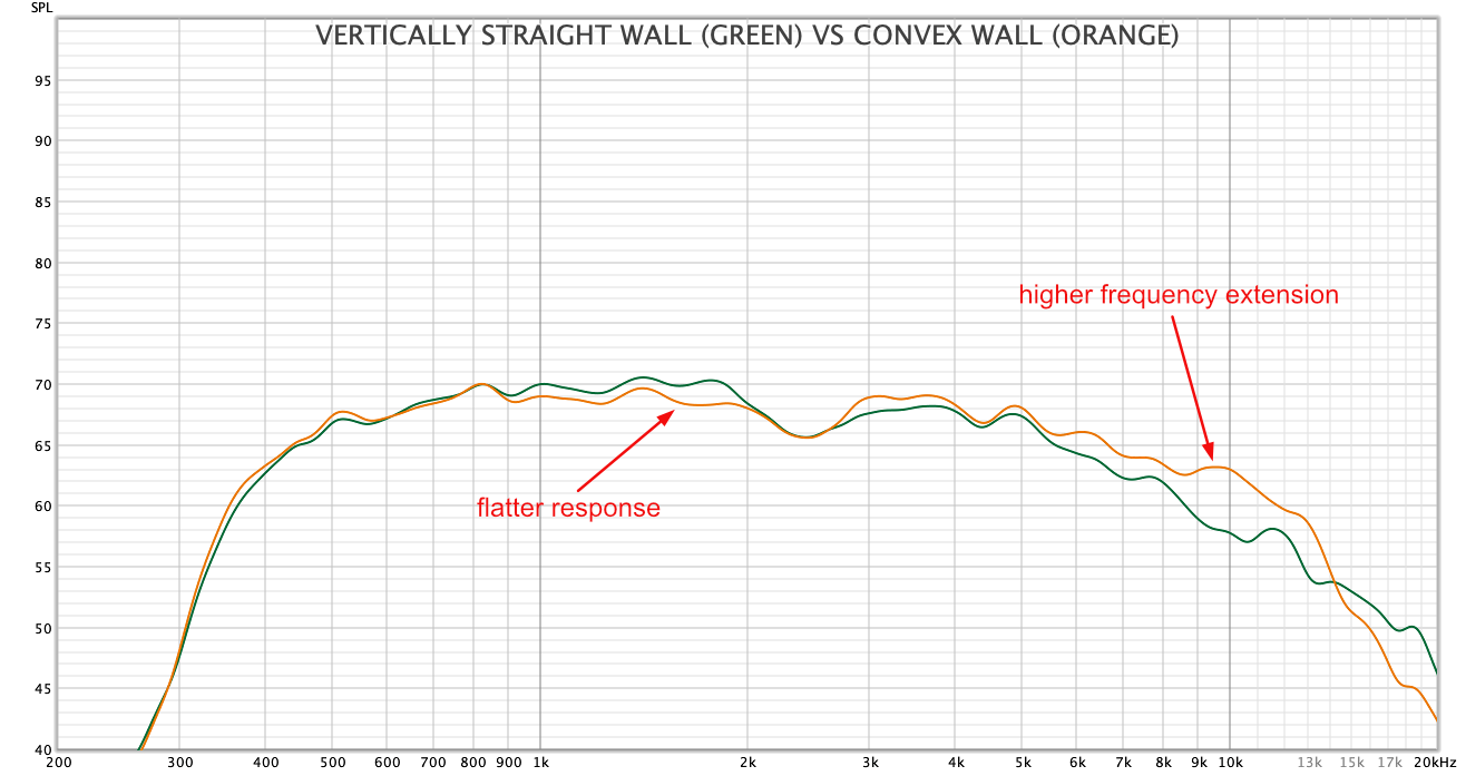

Near the left and top edge (diagonal corner) of the horn mouth. This produces worst-case measurements that are seldom published.

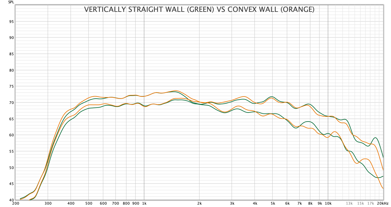

And for completeness, on central axis of the horn mouth (top curves), and near the centre and the top edge of the horn mouth (bottom curves).
Observations
Looking at the horizontal off-axis measurements, the improvements provided by Prototype #2 exceeded my expectations. The frequency response is flatter and more extended at high frequencies (3 to 14 kHz). When not in the "sweet spot", a change of this magnitude should be easy to hear.
On-axis and vertical off-axis measurements show little differences in frequency response, nor in transient/ waterfall response (not shown).
In all measurements, the lower frequency extends slightly more for Prototype #2. Most likely this is by virtue of slightly closer matching of area flare rates (driver 8 to adapter 6.9, and adapter exit 12.7 to horn 10). The benefits of this flare rate matching appear to outweigh the more severe roof and wall flare tangent angular discontinuities compared to there reference adapter.
Bottom line is I am very pleased with Prototype #2. Prototype #3 will likely amount to minor dimensional tweaks and be printed in pair so I can listen in stereo.
Pierre
PS Since some expressed interest, I started thinking about an adapter for the 50 mm TAD driver and Athos Yuichi A290 horn.

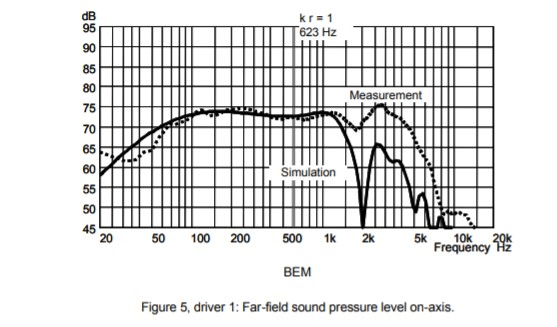

This isn't that weird, BEM has limitations when it comes to the accuracy of modelling cone depth, below a certain frequency the depth gives a more accurate answer but above it a flat piston can be a better approximation.using a 15" driver and not in a totally reflection free environment (large factory). The sim is accurate to the point where the cone diameter cancelation notch occours just beyond 500Hz (no phase plug).
Jorg Panzer has a paper on it
http://www.randteam.de/_Docs/Pub/Aes112 Radiation impedance cones.pdf

Latest adapter, Prototype 3. Flare rate optimized to match driver (m = 8.2) and horn entrance (m = 10).
Main novelty is having two printed so I can do some critical listening 😎 . Will report back in a couple days.
