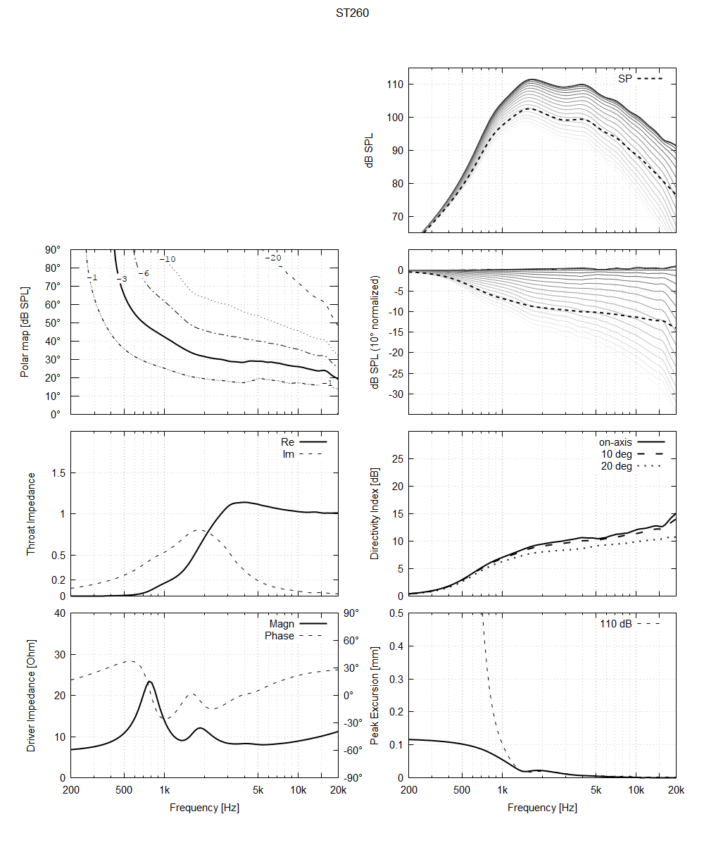

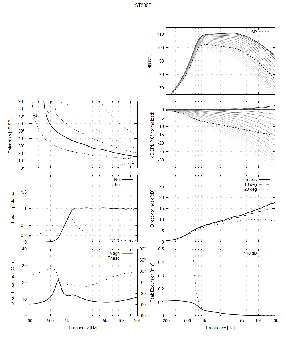

Regarding loading, here's a bit of practical matter - a comparison of the same 1" driver in two different devices. (BEM+LE simulation)
Device A:
Device B:
Both devices have a similar diameter.
1) Notice the difference in "Throat impedance".
2) Notice the bottom-right graphs showing the peak excursion required for 110 dB SPL at 1m (the dashed line).
3) Notice the difference in HF beaming between the two.
By increasing loading, you gain a bit of efficiency and somewhat lower crossover point and also quite a bit of HF beaming, which can be really annoying and make it sounding unnatural. It's up to you to decide if it's worth it.

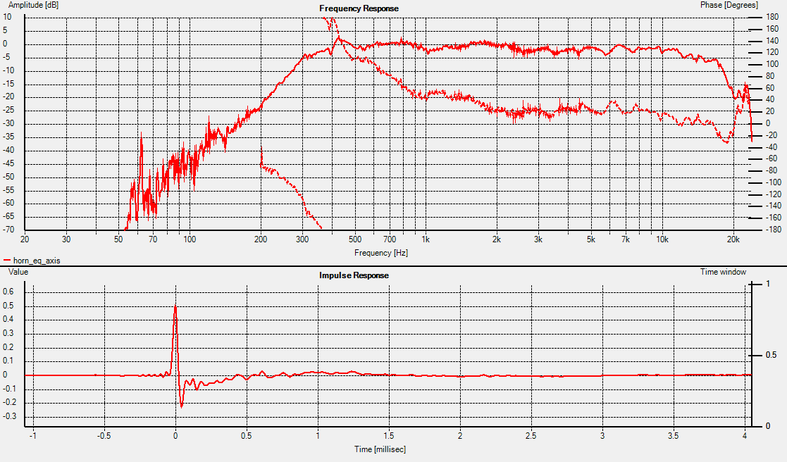

New measurements, this time in the near field, closer to the horn mouth, without any smoothing or time-windowing.I'm using the Yuichi A-320FL model (also sometimes incorrectly referred to as A-290FL). It's very similar to the more famous A-290, but without the fins.
Its design parameters are Fc = 320Hz and T = 0.6.
I use it with a JBL 2450J 4" diaphragm/2" exit driver, equipped with a Truextent Beryllium diaphragm.
The internal geometry of this driver is an almost perfect match to this horn, in terms of maintaining the same flare rate at the transition between the driver's exit and the horn's throat - and that is an important factor in obtaining the best performance from any driver+horn combo.
Of course, this is no coincidence, since the Yuichi 2" horns were all designed for the TAD TD-4001 driver, which has an almost identical internal geometry to the JBL 2450...
Here is the on-axis frequency response, measured indoors at 1m, with no "protection" capacitor or any other high-pass filter, but with some slight high-frequency Eq. provided by a passive RC filter.
Good loading down to the cut-off frequency (-6dB @ 320Hz), and pretty flat and free from resonances up to 17kHz.
Marco
1) On-axis frequency + phase and impulse responses. No high-pass filter, with slight hi-freq. Eq. provided by passive RC filter:

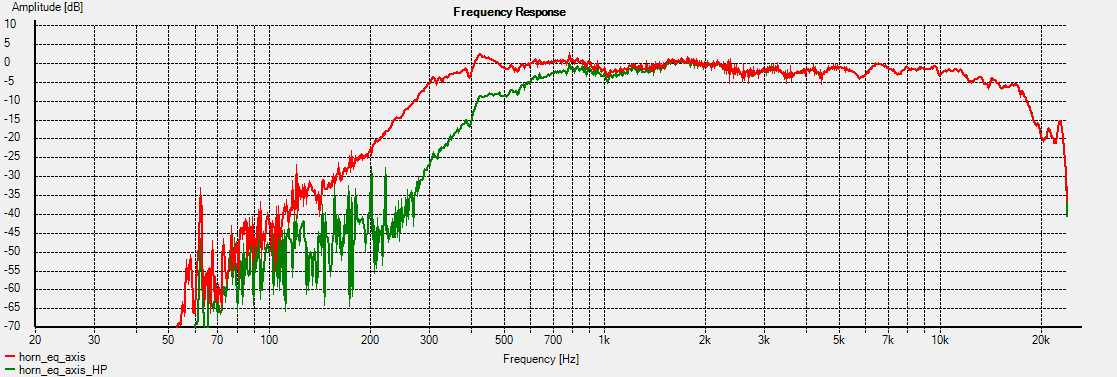

2) Same frequency measurement as above, plus additional measurement (in green) with the addition of an active 24db/oct Linkwitz-Riley high-pass filter (this is how I am using this horn in my system at the moment):
Despite what has been said in this thread before, I believe these measurements confirm good horn loading down to approx. 300Hz.
They also show rather good linearity all the way from 320 Hz to 17kHz. Make of them what you will.
Best,
Marco

Not sure exactly what you mean by "AC coupled" or "attenuated", but like I said, the red trace is the driver+horn+passive RC eq. without any high-pass filter.Marco,
so the red trace is the AC coupled and attenuated driver corresponding to the pure horn loading response and the green trace is that + the LR.
What is the cutoff of the LR filter? The response seems to be more linear than what was shown earlier with the different driver. Is that because of the better driver/horn match?
thanks
The green trace is the same, plus a 500Hz 4th order L-R high-pass.
The traces I had shared earlier in my first post in this thread were with the same driver and horn, but taken from further away and smoothed. These ones are in the near field, and unsmoothed.

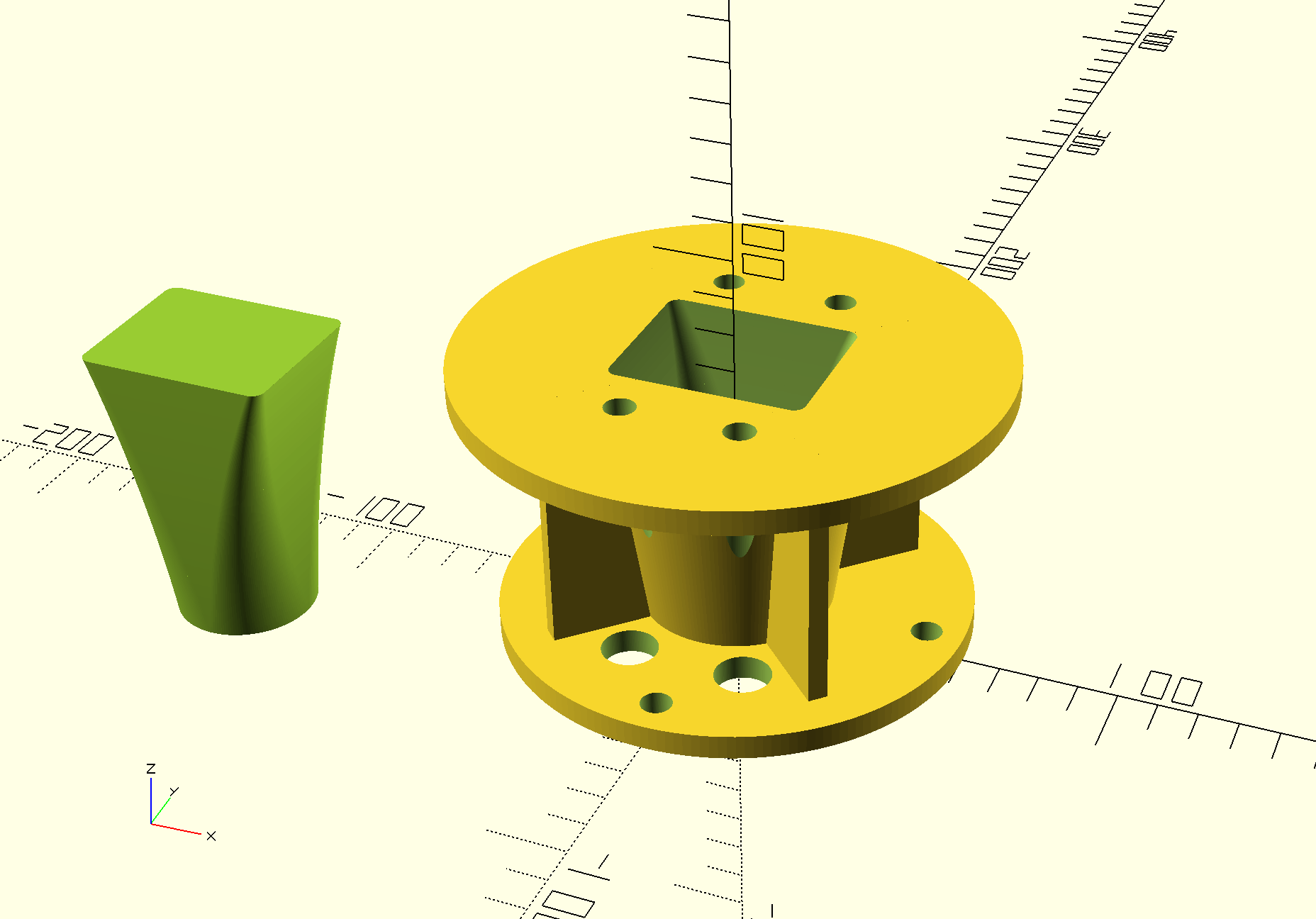

Just wanted to share that as a result of the good insights of fellow DIYers I am designing a custom throat adapter to fit my driver to the TAD horn.
The plan is to have a friend 3D print this, and then if all goes well I will remeasure the driver's impedance and response with it. It's a hypex T=0.7 starting at 4 degrees flare and shaped to fit the rectangular entrance of the TAD horn. The throat expansion is shown on the left, and adaptor itself would look something like the drawing on the right:

@PierreQuiRoule Could you please describe how did you create the green shape in OpenSCAD?
Oh, I just stacked hull() shapes. As you noticed, calling hull() once for all slices does not give the desired result ;-).
I derive a function that plots a slice at height z having the surface area and shape I want.
Then in a for() loop, I call hull() for every pair of adjacent slices.
Here's my code, although you certainly don't need it:
for (z = [D/slices: D/slices: D]){
hull(){
plotslice(z-(D/slices));
plotslice(z); } }
where variables "D" and "slices" are the adaptor height and number of slices.
hull(){
plotslice(z); } }

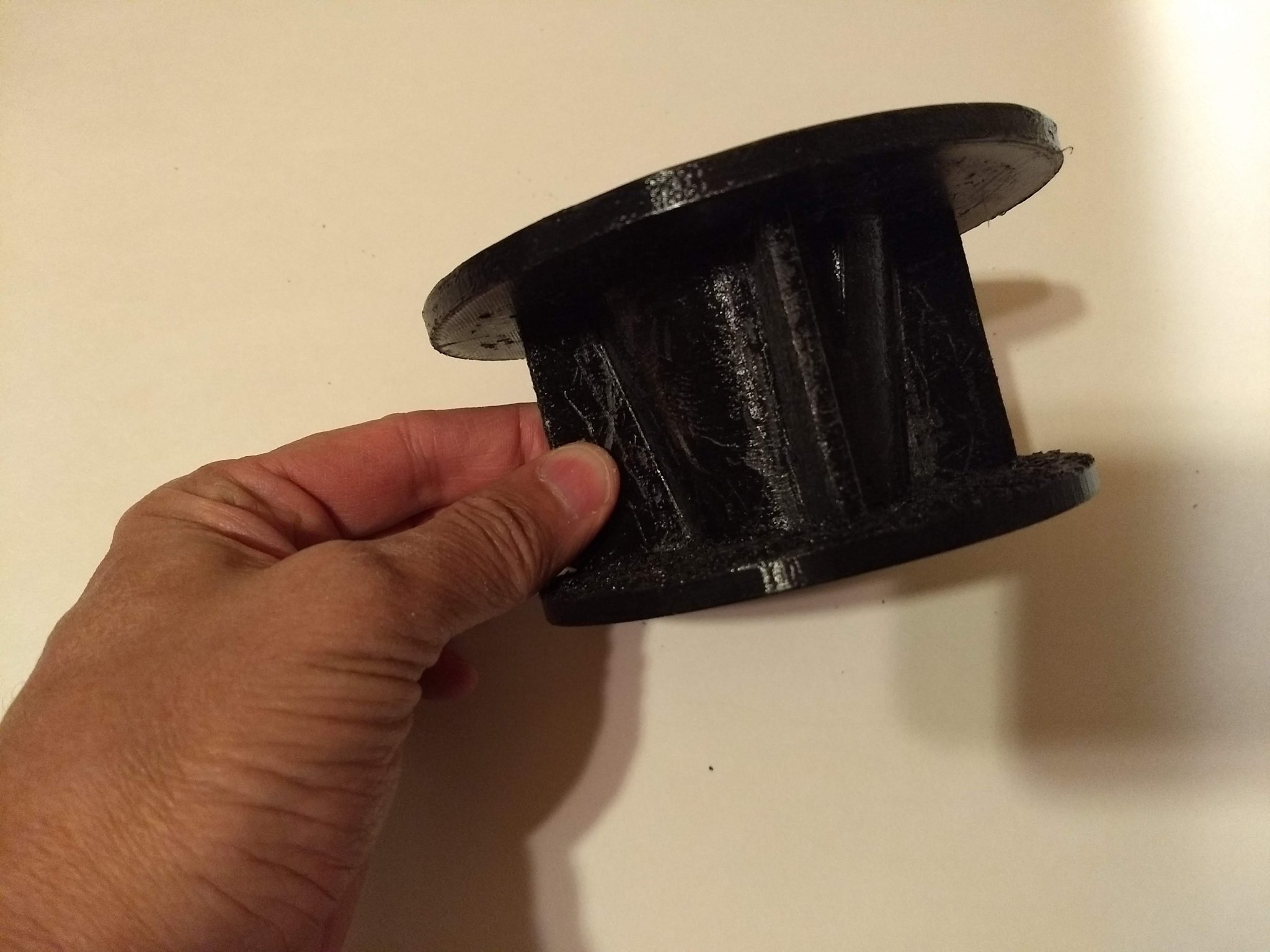

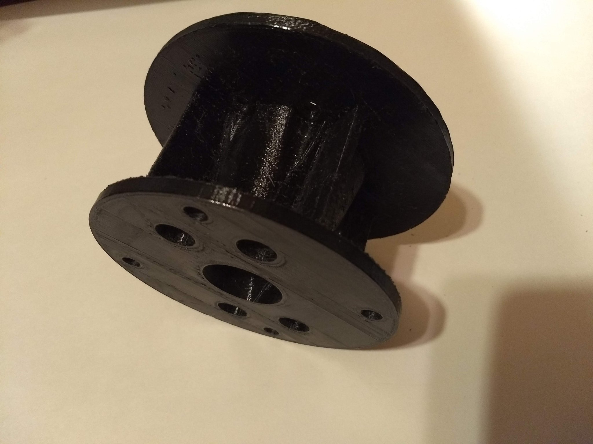

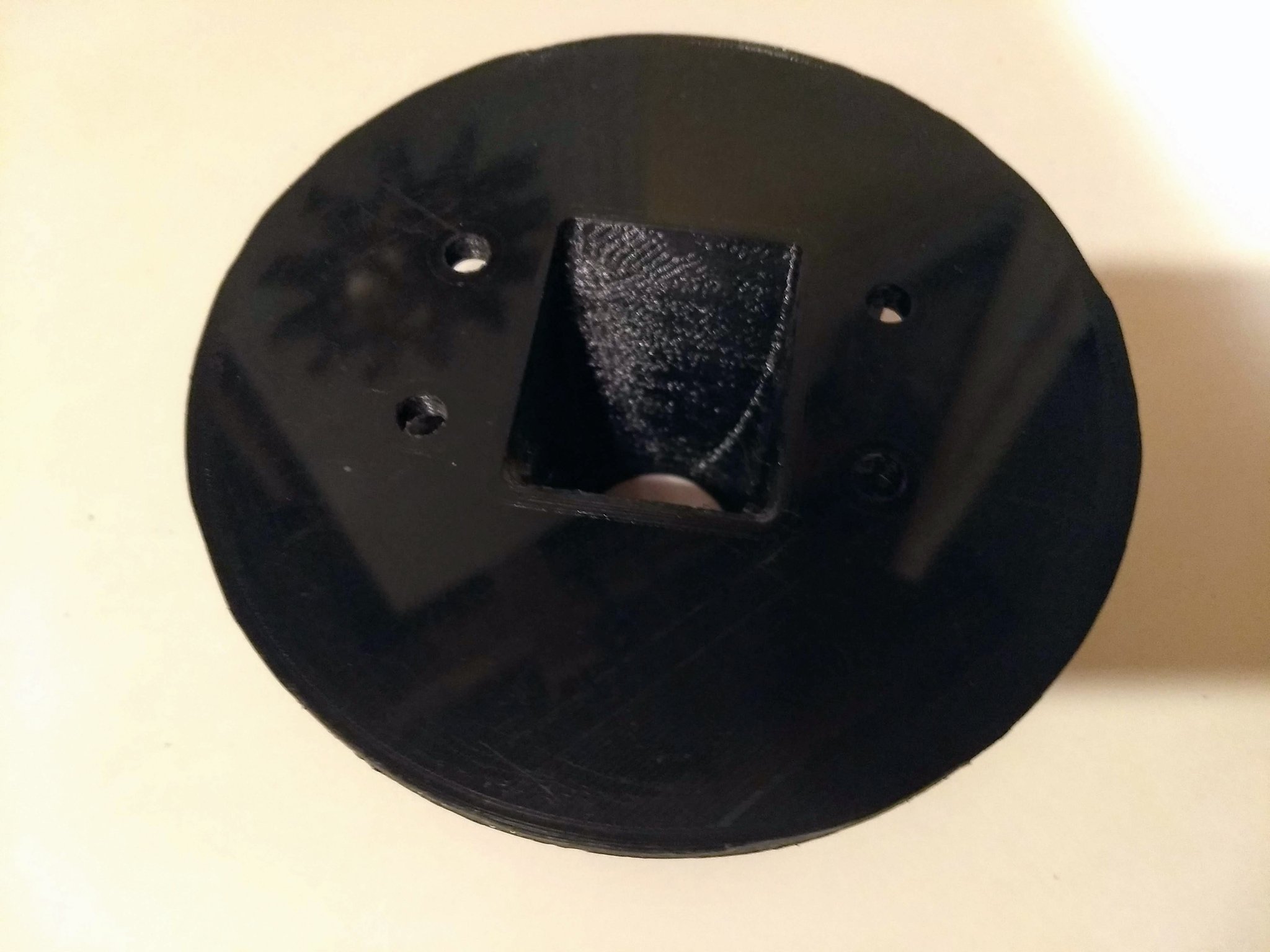

My friend delivered Prototype 1 of the 3D printed custom adaptor today. Although the printer settings need adjustment, the approach is promising already. While I test Prototype 1 on the horn, my friend will print Prototype 2 using a different support structure and smaller vertical increment.[...] designing a custom throat adapter to fit my driver to the TAD horn. [...]
