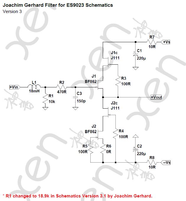

Hi WK,
Just received the PCB and started work by going thru the BOM and schematic but seem like some of resistor value on the schematic is somewhat different from the BOM. Is there a updated schematic available?

syklab, I don't have the datasheet close at hand right now but from memory the first part of the schematic is the datasheet output filter which is assumed to be on the DAC board, it is on the xen audio ES9022 boards and also acko's ES9023 boards. I'm not familiar with details of other implementations of the ES9023 DACs.
I'd rather EUVL or WK or JG confirm components for other positions as I don't wish to lead you astray. Though I *think* 10k is for R4 and R5 represents the internal resistance in the inductor ...

Attached is the (original) schematics V3 according to which we built our prototype and made up the Bill of Material.
This is the exact circuit as on the PCB itself.
The following discrepancies exist between our schematics (V3) and that in the following link (version 3.1) :
http://www.diyaudio.com/forums/digi...ng-new-ess-vout-dac-es9022-7.html#post2867664
(the component designations below are according to the Joachim Gerhard schematics in the above link)
a) R6,C4 do not exist on the PCB, as they are part of the ES9023 DAC circuit.
b) R2, P1 are removed as we guarantee proper matching, and hence no need to trim DC offset.
c) R3 has been changed to 100R, and 2 additional gate stoppers added for the J111s.
d) R4 has remained 10k and not updated to 18.9k
This is identical to what we built, tested and then approved by Joachim.
Apart from the 10k/18.9k discrepancy, the bill of material remains correct.
You can count this one (R4 update) on me as my mistake.
And I'll see if we can send 200x 18.7k Susumu 0603 to Fran, before he sends them to everyone.
(18.9k is not stocked by Digikey.)
Hope it is clear,
Patrick

According to the schematic that R4 is 100R and R1 is 10K. Is that correct ?

Hi Patrick
Thanks for the above info but I’m not part of the GB and finding it a little difficult to source those 18K9 resistors.
Any idea where I may find some?
Digikey has 18.7k. I consider 1% deviation close enough.
The inductors will have more variations.
Patrick

Joachim specified +/-15V.
Current is ~16mA per channel. It of course varies from JFET to JFET (Idss).
But if you allow 25mA per channel, it is in any case on the safe side.
