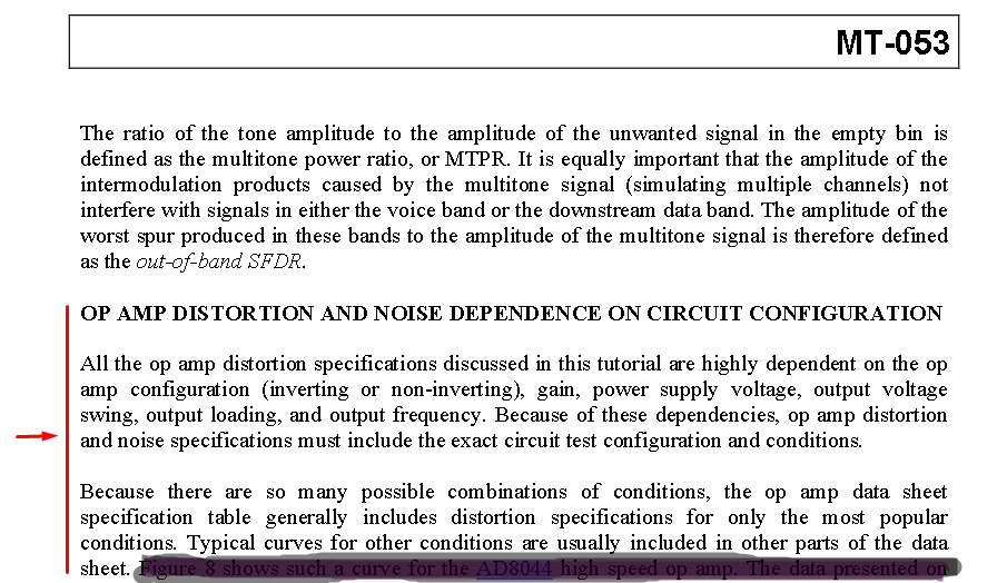

See AD app note below.
- Maybe I am wrong but I thought that even harmonics are normally smaller than odd ones in Opamp.
- Also, my take on IMD is that they are dependent of HD, so even having contributions below the limit of "direct" audible HD, the leakage of these terms into IMD may make a great difference. Maybe I am wrong to generalize, but this is my current understanding.
- I also note that mybelief until now was that even order harmonics are "always" (with normal good amps or OpAmps and when correct implemented) lesser than odd ones. The fact that our ears detect odd ones more efficiently is another story.
Still, I wonder if CS configuration would help clarity by internal amp mechanisms, e.g. not only by reaction of speakers. I will wait for answer.
Greetings,
Ionmw
P.S. Joe, to help us all make an easy comparison of configurations... could you post HD/IMD measurements for LM3875 as normal gainclone too? Are you setup to measure?
