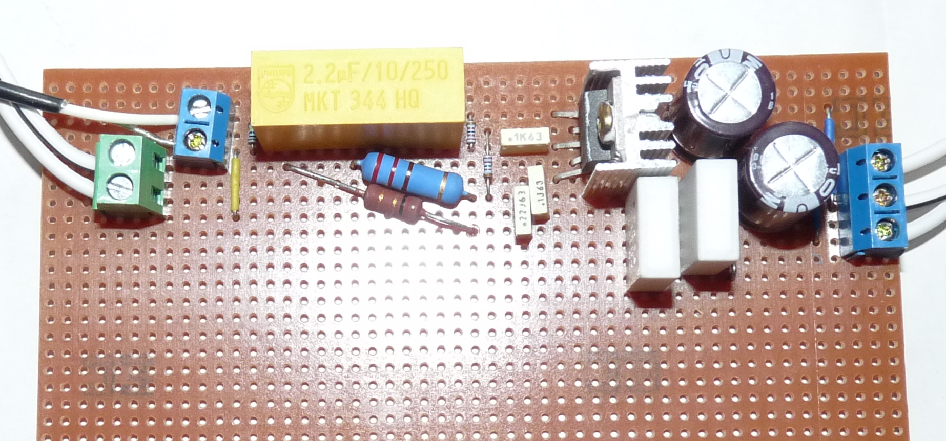

adason circuit breadboarded

As I had all the bits to hand, I've built up adason's version of the circuit. The only change is that I used a pair of 0.15ohm resistors as the R7 to give 0.3ohm.
It worked first time into a dummy load so I then wired it into one of my CSS FR125 based minOnkens. The DC offset with 50 ohm across the input terminals is just 33mV. Absolutely no background hum or other noise and loads of power. The tiny heatsink gets hot but not over-the-top at normal listening levels
Power supply is a 12-0-12 100VA toroid with 20,000uF on each rail giving 34V across VEE-VCC on the chip.
It really is remarkably good even given the veroboard construction. My memory of valve amps is very old but is certainly seems to have a very open "big room" sound.
The only change I need to make is to reduce the gain a bit. Did we get a conclusion on the best way to do this? Once I properly understand this I'll make a second channel.
Thanks to Joe and adason for prompting a fun couple of hours of experimentation.

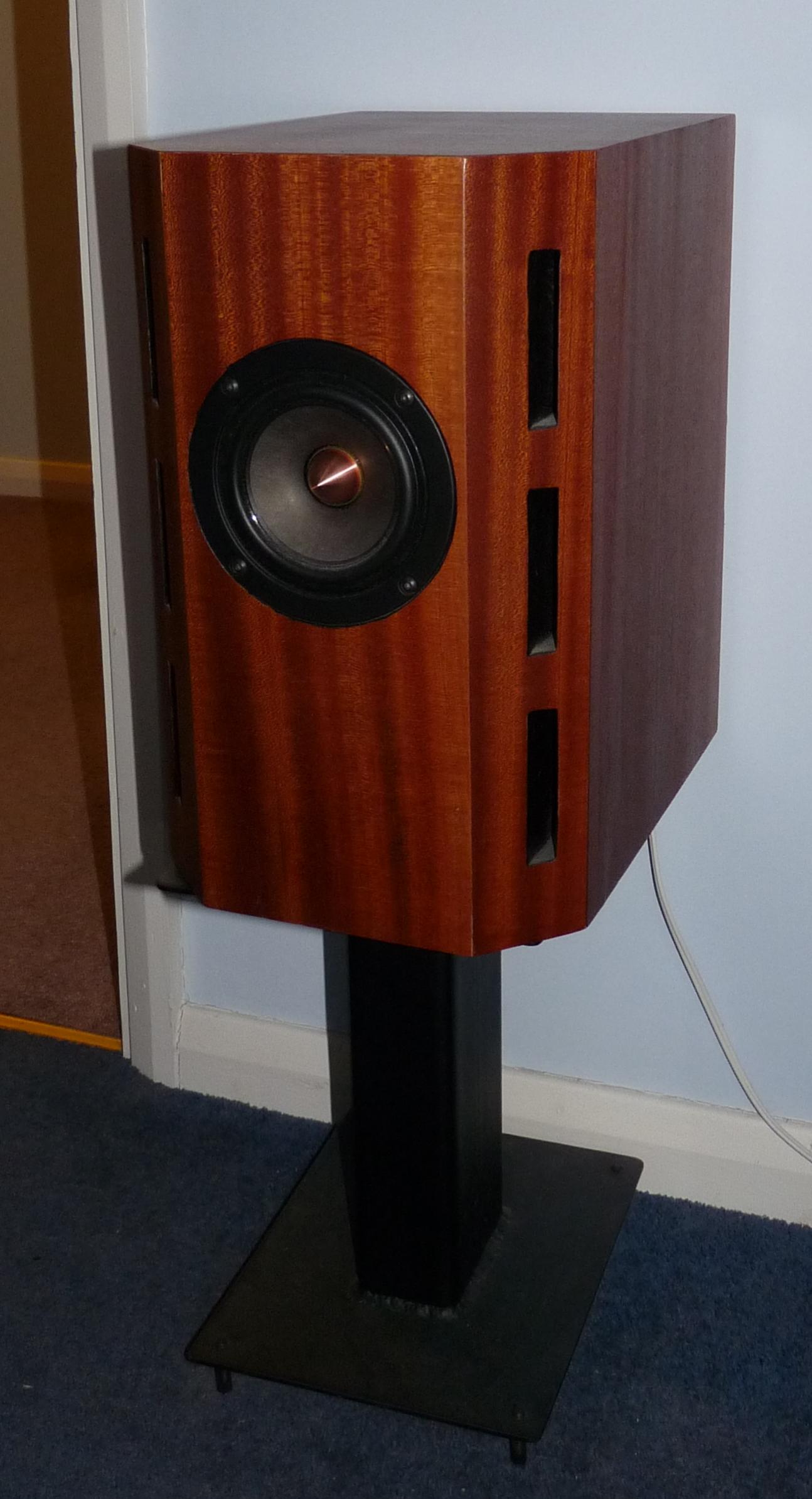

Have you added damping to the vents?
dave

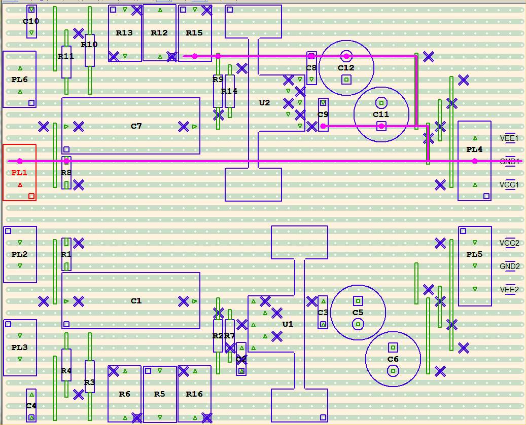

I've now built a dual mono version with proper heatsinks. I've also increased the load resistor to 0.45ohm by adding a 3rd 0.15ohm resistor to reduce the gain a bit.
I did try building it single supply stereo - DON'T BOTHER!! heed Joe's warning.
This version is running on a pair of 12-0-12 100VA transformers, full wave rectified with 10,000uF on each rail.
Despite being breadboarded it is running completely stably and has a great sound. A slightly modified breadboard layout is attached. I run a solder bead along all the tracks covering all spare holes to increase current carrying capacity and break all tracks to keep them as short as possible. There may be some small improvement by laying it out on a PCB but it is certainly very acceptable as-is.
It will replace a Tripath TP2050 amp I've been using in my workshop driving the miniOnkens and there is no comparison in the quality of the sound; the LM1875s in this configuration blow the Tripath away.
Despite being breadboarded it is running completely stably and has a great sound. A slightly modified breadboard layout is attached... and there is no comparison in the quality of the sound; the LM1875s in this configuration blow the Tripath away.
