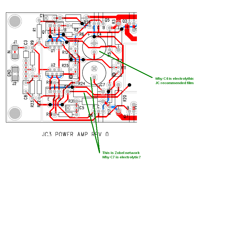

I'm curious as to how the form for your layout came about. Seriously. Is this the way you've layed things out in the past, is there a applications note or book that suggests this, or do you have a heatsink that fits?
The reason I ask is #1 you asked for feedback and # 2 with this layout the most sensitive parts of the design, ie the signal path, are making the longest runs.
If you've had good results I'll say no more and if there is sound logic I'd be interested, as I'm a layout info fanatic (not really, but that sounds dangerous). Anyway, I'm actually curious because I see this form factor in many of the design pics posted here and I'm interested mainly because I do things differently.
Regards, Mike.
I work for radio company. Mostly higher frequencies. The guy who lays out the board does these. It costs a few buck plus a Le Monstre. I didn't think the signal path was that long. The feedback loops are. There is an output plane under the big emitter resisters. We will see what happens when I build it. I am glad you looked at it. Did you see any problems? I think I need to make R24 a 2 or 3 watt.

I couldn't see separation between input ground and high current ground
There is no resistor between 5uF and 100uF in each reail
The loop C2Q3Q8C6 is very large
R24C7 - what is it - Zobel? Why elco? Completely wrong place for Zobel
Don't use ground plane for current flow
Where is resistor in each base of output BJT?
Bias setting transistors are too far from the output
Sorry, Mike
Sorry, Mike

1. I do need to spilt the ground plane.
2. Not on schematic
3. See post 303
4.It is part of the feedback loop.
5. See # 1
6. Not on schematic
7. They are to be mounted on the heatsink from the bottom of the board. This is a class A amp. The heat should remain constant after warm up.
Thanks for the input, Mike

# 2and # 6 now on schematic. You can jump them if you don't want to use them.

MikeW said:Ground plane split.
I still have to check the layout.
Thanks again for the feedback. If it looks OK this time we will get some boards made.![]()

dimitri said:see below
I will change them
I had some 4.7 uf electrolytics, but I guess I could beak down and buy some film caps.

For C7 please this one http://www.panasonic.com/industrial/components/pdf/ABD0000CE16.pdf
for C3 and C4 - http://www.panasonic.com/industrial/components/pdf/ABD0000CE23.pdf
