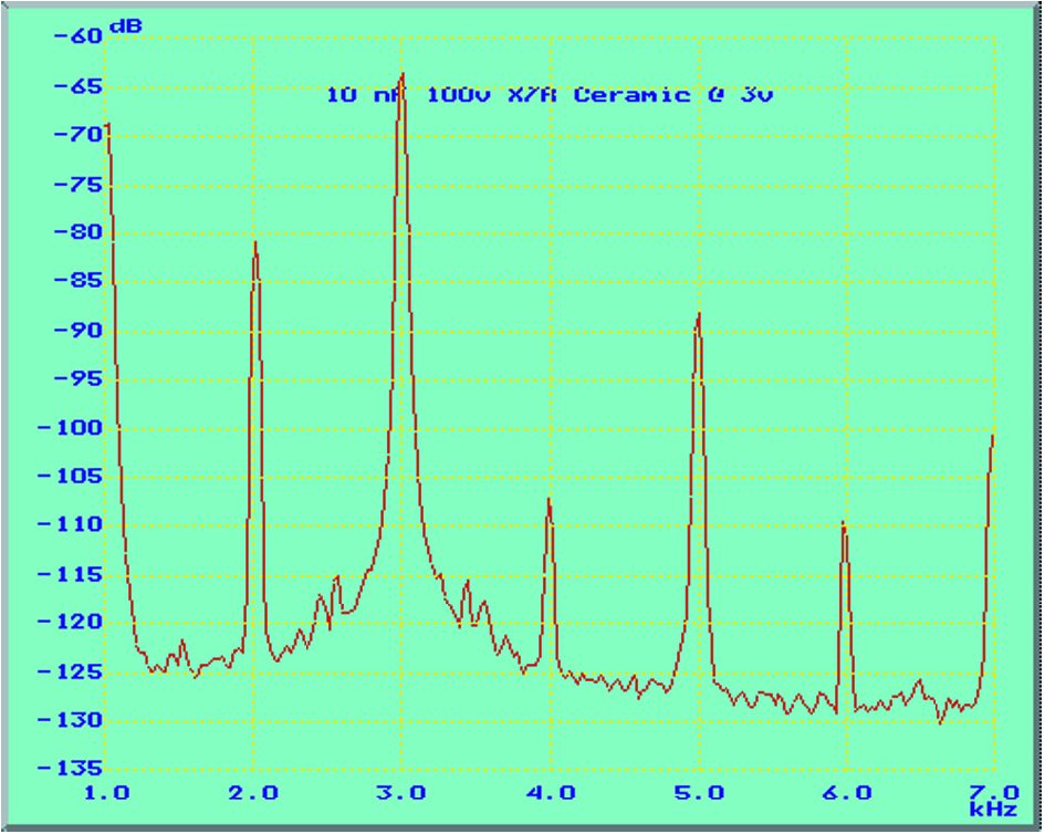

A popular piece of disinformation that really irks me is the claim that ceramic caps should not even be used for bypass applications in audio. This is drivel, and is totally unfounded drivel at that. The purpose of bypass caps is to store energy that ICs need on a short term basis, swamp PCB track inductance to ensure that opamps don't oscillate, and to ensure that digital circuits don't generate supply line glitches that produce erroneous data. There is absolutely no 'sound' associated with DC supply rails. Opamps don't care if the DC comes from a battery, solar cell, or rectified and filtered AC (sine or square wave, any frequency). DC is DC - it has no sound, and it contributes nothing to sound unless it is noisy or unstable. Supplies may be completely free of noise, or might be relatively noisy (especially where digital circuitry shares the same supply). Provided all noise (including voltage instability) is of low enough level that the opamp's (or power amp's) PSRR (power supply rejection ratio) prevents the noise from intruding on the signal, supply noise is immaterial. As always, a blind test will reveal any genuine difference, and a sighted (non-blind) test will reveal the expected result - real or imagined.
To reject ceramic bypass caps, which have the best high frequency performance of nearly all types, is sheer lunacy.
From Cyril Bateman:
![61894d1144431542-ceramic-capacitors-x7r.jpg](https://www.diyaudio.com/forums/attachments/parts/61894d1144431542-ceramic-capacitors-x7r.jpg)
Here's the caption:
Some capacitors distort even a pure 1kHz sinewave test signal. This 10nF X7R ceramic was made by a CECC approved, European manufacturer. It was tested at 1kHz and 3 volts, in series with a 10kž current limiting resistor. Measurable distortion exists at all voltages down to 0.5 volts – my lowest test voltage.

Talk about bait and switch a bypass capacitor sees no AC signal (it's there to eliminate it). This is a classic mis-use of Bateman's results. Would anyone use X7R's to make an RIAA, please.
EDIT - Sorry if I missed the point of juxaposing the two articles. My experience has been as I just said, X7R's have easily measurable distortion when voltage appears across them so according to some are useless in any audio application.

Nobody is telling you to do anything. Just noting that different caps have different purposes. Ceramics are not universally bad. One of my standard techniques when leading a discussion group is to say something apparently outrageous just to make people think and question their own tidy assumptions.john curl said:Now, people are telling us to use ceramic caps in the power supply. What is the world coming to?
