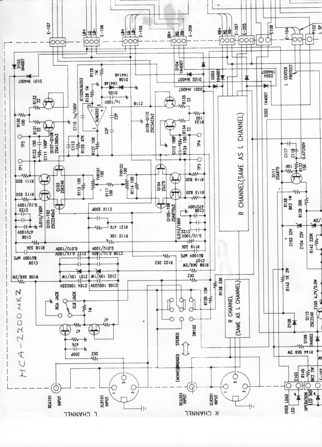

Pin out aside(which I can solve),if Hitachi K216/J79 laterals , rare and much more expensive , sonically better in cap mult. and amp itself position than BOM types?The Hitachi device will NOT WORK in that location because the pin-out is different. IF you must substitute, just use the Fairchild IRF devices, like the others on the BOM.
I have a decent numbers of a/m Mosfets.
FWIW it takes ~ 1/2 volt to turn on the laterals as
opposed to ~ 3 volts for the verticals .........
(maybe not important for this app) ?
Well, sure, for one thing, when used as source followers there will be less headroom with higher Vt parts when used as powerline filters.
The cool thing about the laterals I've seen is the relatively low currents at which they have a nearly zero temperature coefficient of gate-souce voltage, something that you reach in conventional DMOS at impractical power dissipations. When operated at relatively low currents everyday DMOS have larger tempcos than bipolars.
Yesamundo ! For AB amps nothing else even approaches
their simplicity of use.
Just so that everyone knows, Semelab makes improved versions of the Hitachi (Renesas) lateral output devices.
However, Renesas just announced the EOL for the lateral MOSFET drivers (J76-9/K213-6). The last date to order is the end of this year. The last date for delivery is next June. I contacted Semelab and they will NOT make a replacement for these. So if you want some, buy them now. There will never be another similar part from any source, ever...
