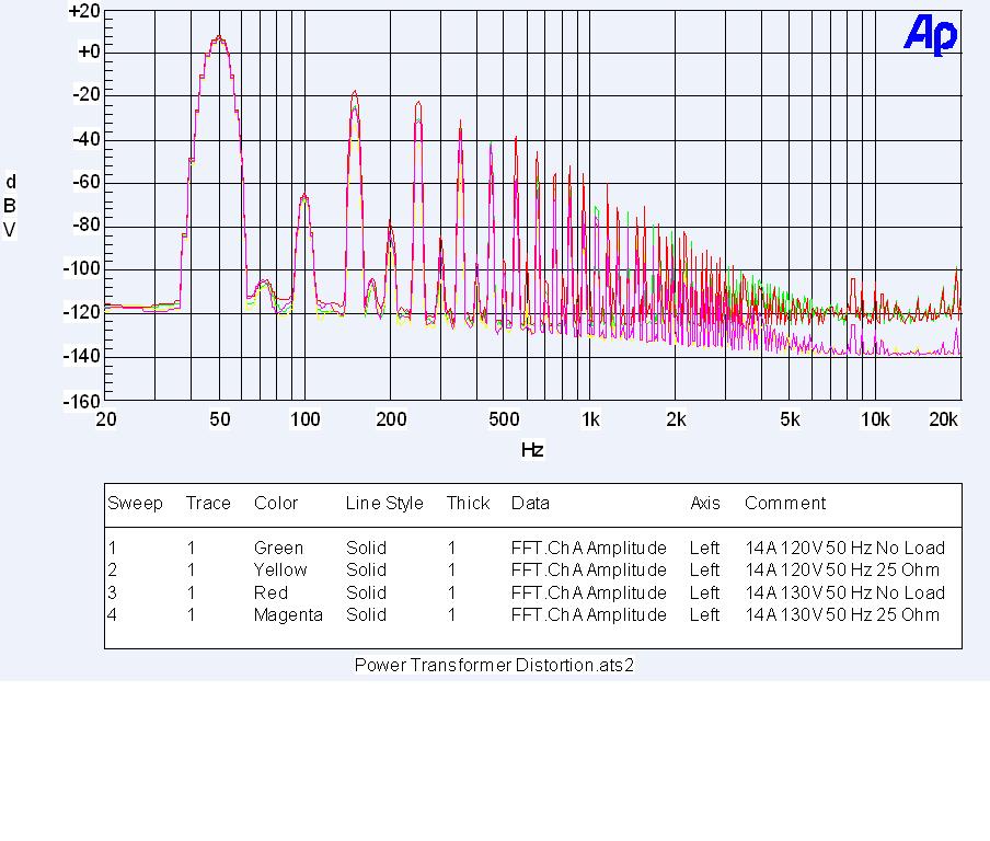

Ed see upper part from page 5 of attachment.
For magnetostriction and distortion for some core materials, see this link http://www.sowter.co.uk/pdf/GAVS.pdf

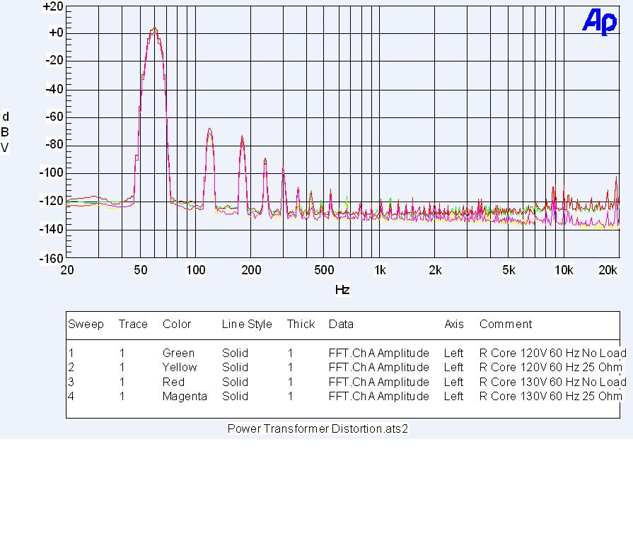

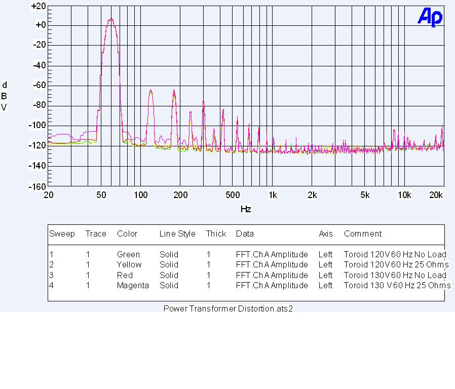

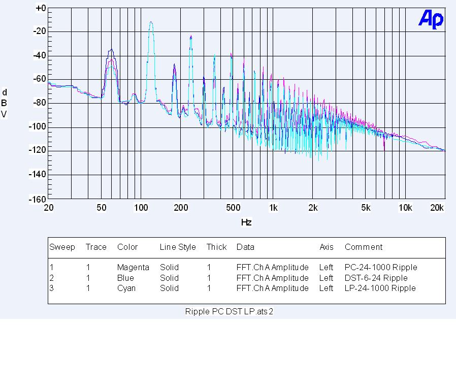

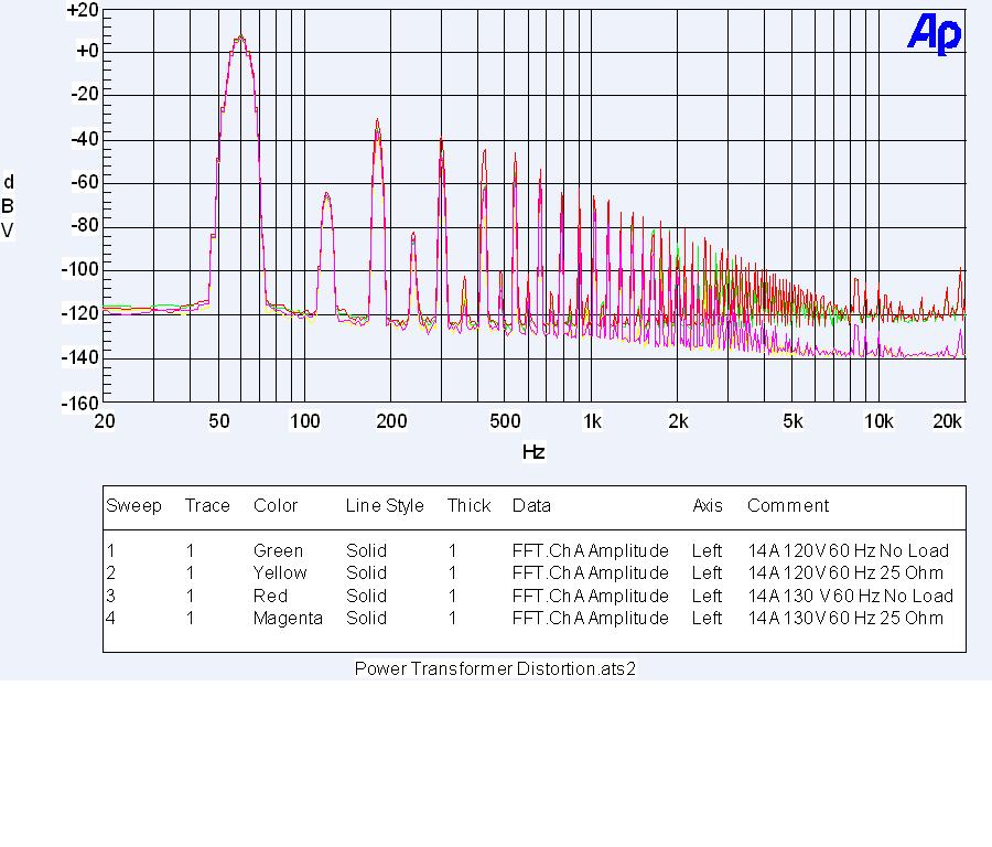

George,
Attached are the distortion curves from an R-core transformer, a Toroid and a standard E-I. These were obtained from a clean sinewave source.
The R-core is used on a 220 Volt primary and shows almost no power line distortion. This is obviously because the core did not saturate at all.
The Toroid is almost as clean.
The E-I core shows a lot more distortion when measured at 60 hz and even more distortion as the frequency is dropped to 50 hz. That seems to be from saturation. At full load with 10% high voltage at 50 hz the core noticably heats up and that is what seems to limit the power rating. Flux leakage is also at a maximum for a clean load.
I also have included E-I cores used center tapped with a pair of diodes providing power into a 50 ohm load filtered by a 2200 uF capacitor. Now how much of that noise comes from the core distortion, the rectification process or the incoming AC line?

George,
ES
Ed thank you for the FFTs
First I would like you to confirm that these FFTs are from voltage measurements on the secondary side.
I would think as follows (remember, it is you who asked for it )I also have included E-I cores used center tapped with a pair of diodes providing power into a 50 ohm load filtered by a 2200 uF capacitor. Now how much of that noise comes from the core distortion, the rectification process or the incoming AC line?
Pick one trafo.
Step 1. Make one measurement of the unloaded transformer when fed from the mains.
Step 2. Make a second measurement of the unloaded transformer when fed from the amplifier (same freq, same voltage with the mains).
Step 3. Make a third measurement of the loaded transformer when fed from the mains.
Step 4. Make a forth measurement of the unloaded transformer when fed from the amplifier (same freq, same voltage with the mains).
Provided that amplifier has a very low impedance:
Step 5. Comparing (subtracting) the FFT of Step 2 and Step 1 will give you the influence of the incoming AC line with trafo in unloaded state.
Step 6. Comparing (subtracting) the FFT of Step 3 and Step 1
The FFT of this subtraction will show higher components of AC even harmonics. This is bound to happen.
Check for difference in odd harmonics and any other new products. These should be called the “noise from rectification” for the psu fed from the mains.
Step 7. Now, do the same comparing (subtracting) the FFTs of Step 4 and Step 2
You will get the “noise from rectification” for the psu fed from the amplifier.
Step 8. Compare (subtract) the FFTs of Step 6 and Step 7.
Study the “noise from rectification” on these two FFTs.
Most probably the FFT of Step 7 will be cleaner from FFT of Step 6
This will be due to finite impedance of main’s incoming AC line plus line noise.
Step 9 (optional ) Compare (subtract) the FFT of Step 8 and Step 3.
This should confirm the influence of main’s line impedance on rectification process on the secondary side of the trafo.
Step 10 (mandatory) Switch off bench power and enjoy a glass of whatever you like, anywhere you like, with whomever you like.
George
By George I think you've got it! I think you've got it again!
Actually it is easier than that!
Yes I am looking at the secondary voltage and 0 db is 1 volt RMS.
I am cleaning up the same curves from the AC line to show the additional line noise for the 60 hz comparisons, but at only one voltage.
The toroid (and R-core but as it has a different secondary voltage might mislead some.) has low enough distortion that I can feed it from clean AC and show the effects of rectification. I can also run all of the others to show the variance.
So that will show, the distortion of the transformers, the AC line noise and the rectification noise.
Now the interesting issue is that some off the distortion from the transformers is on the same frequency as the rectification noise but out of phase!

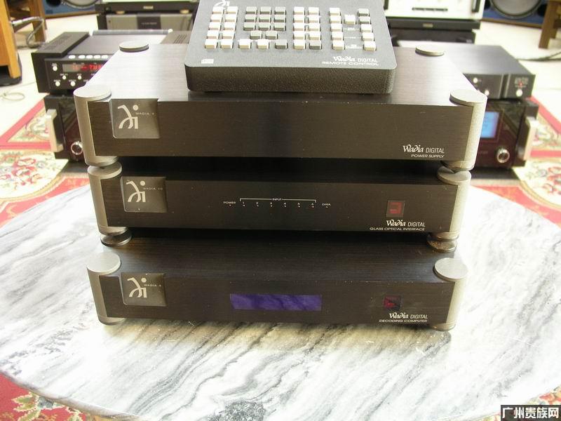

Stupid question 1 : How many (serial) preamp models, with cases out of a solid chunk of easy to machine aluminum, were there at the time of BT No2 ('97)?
Stupid question 2 : How many now (+ power amps/phono stages/DAC's) ?
(aviation/military not acceptable)

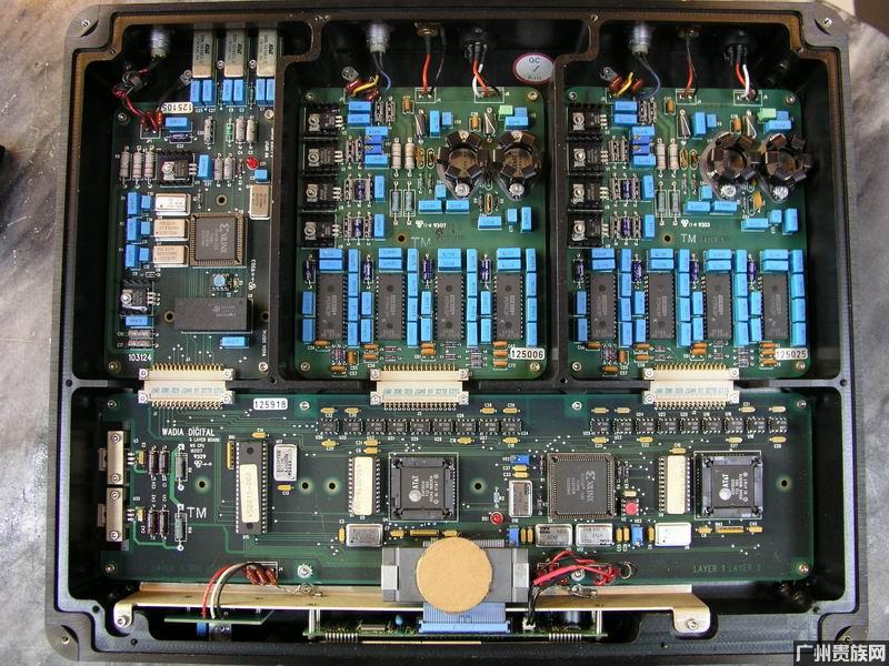

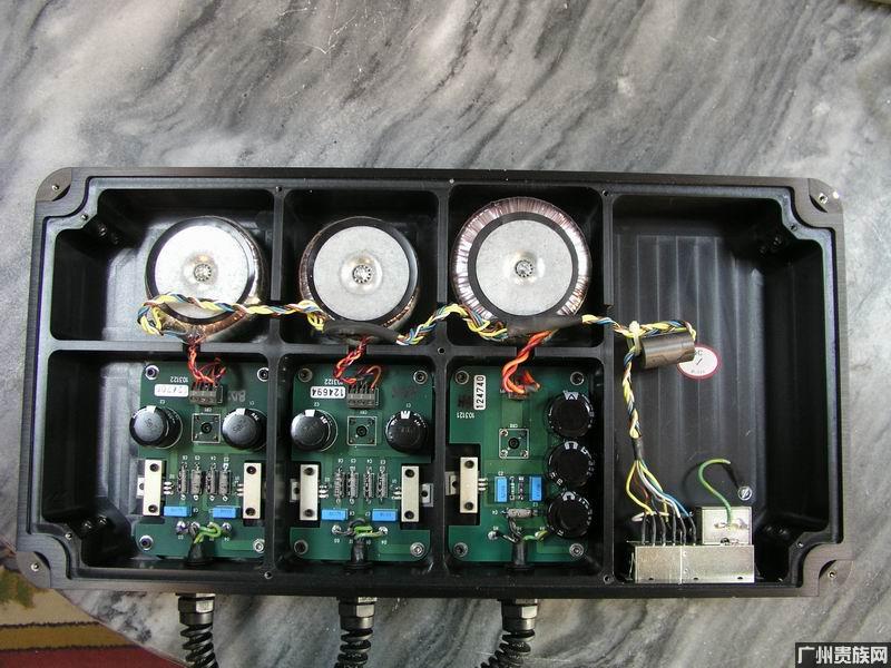

John's Blowtorch wasn't the only product with machined aluminium enclosure on the market, by the way. Wadia did the same with their "flagship" DAC.
Anyone want to give Wadia a call and offer them assistance in enclosure design? I'd love to hear Wadia's response
