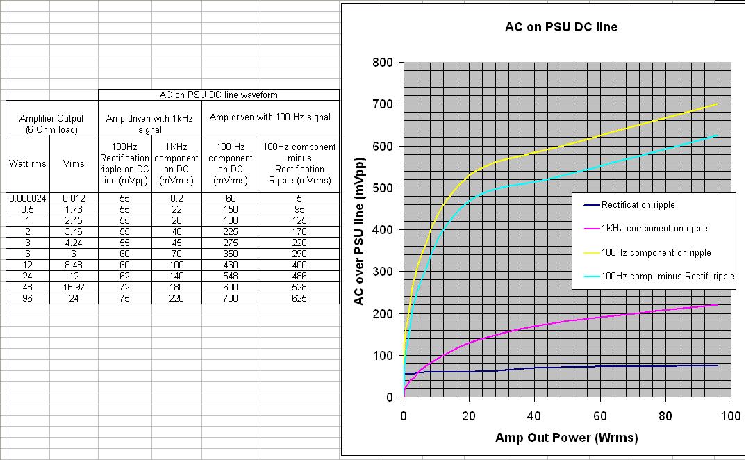

On a side note, long ago, you had asked me (I saw your post with a great delay) what I find as an alternative to a choke input psu.
What I find that can work as such, is cascaded CRC.
Multistage, each stage with different time constant and C progressively increasing towards the load side.
Apart for higher harmonics decreasing more, the arrangement deals well with the problem of rectification frequency ripple (2xmain’s freq.) increasing in amplitude when the amplifier (that the psu is feeding) amplifies low frequency music (sustained notes) content.
Typical PSUs with a lot of C after the bridges and not CRC arranged, are vulnerable to this.
See attached some measurements on a psu of a well regarded power amp (amp is 2x150W/8R. In these measurements, I drive only one channel and up to 100W. I probed on the + side of the psu).

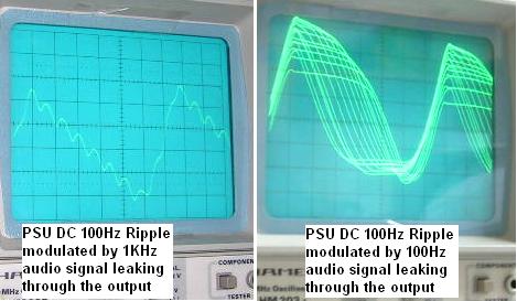

To see the effect, I link two oscilloscope screenshots taken years ago from a psu of the same kind of another amp. http://www.diyaudio.com/forums/attachments/solid-state/71167d1159649591-simple-killer-amp-constructor-thread-ripple-modulation.jpg

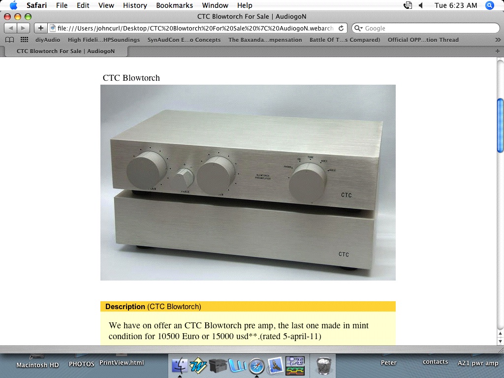

High opinions, from 'Monday morning quarterbacks'. '-) A 'sealed' construction is a necessity for the best operation of the CTC Blowtorch. It keeps the impurities from the outside air from getting inside the unit. It keeps the inside, dust free. It keeps (once it is fully warmed up) changes in temperature from adding further 1/f noise or creating dynamic offsets. (Just blow on a Vendetta Phono board sometime or just lift the lid while it is connected to test equipment.) The only thing that I regret is not adding some sort of sulfur 'trap', something recommended to me by Ed Simon. (Next time!)

I need this sort of exterior fit and finish to compete in the marketplace. I am open to 'serious' suggestions.
List your technical requisites (seriously) on a paper. The answers will come automatically if you are smart.
About "look and feelings" nice mechanical assemblies are a must if you highlight them.
And, for Emirs and other nouveaux riches, aluminum is certainly not a noble metal for a front pannel. I would prefer thick tinted glass, granite, marble, Nickel, Coper, wood, leather etc.
As far i'm concerned, i would try something technically 'fashionable' and high tech, like "carbon fiber".
Start with a good industrial designer. The Blowtorch is about as bland as a slice of Wonder bread. Your friends at Constellation at least had the good sense to go to Neal Feay, though I have to say I don't find their work to be much more inspiring. It's still in the rather bland, "big hunk o' metal" camp.

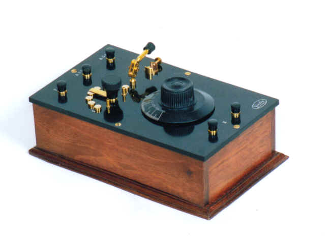

This is what inspired my current project. A Gody Model 23 crystal radio from the early 1920's. Wood, Ebonite, Bakelite and brass. Some 90 years hence I still find it a thing of beauty.

I understand your point of trying to maintain a constant temperature if you have designed for that and can control the set point for a given result. But an aluminum enclosure of similar shape that is made of multiple pieces does not have to necessarily have high leakage if that is one of your goals. The fit tolerance of a typical machined part would not let any more ingress of dust into the enclosure than a one piece machined billet.
If we were talking about a magnetic motor structure then yes every connection of two materials will create an additional boundary condition interfering with the circular flow of a magnetic field causing additional eddy current production.
What is it about a sulfur trap that I must have missed along this long tortuous conversation?
On the industrial design side I have to agree with Steve Eddy that a simple rectangular block of aluminum has no inherent design factors that makes it look like a beautiful product. Without the few control knobs it would look even more like nothing but a block. As someone who has done industrial design for many years that isn't anything that a child wouldn't come up with using building blocks. With a billet of aluminum you could do much better.

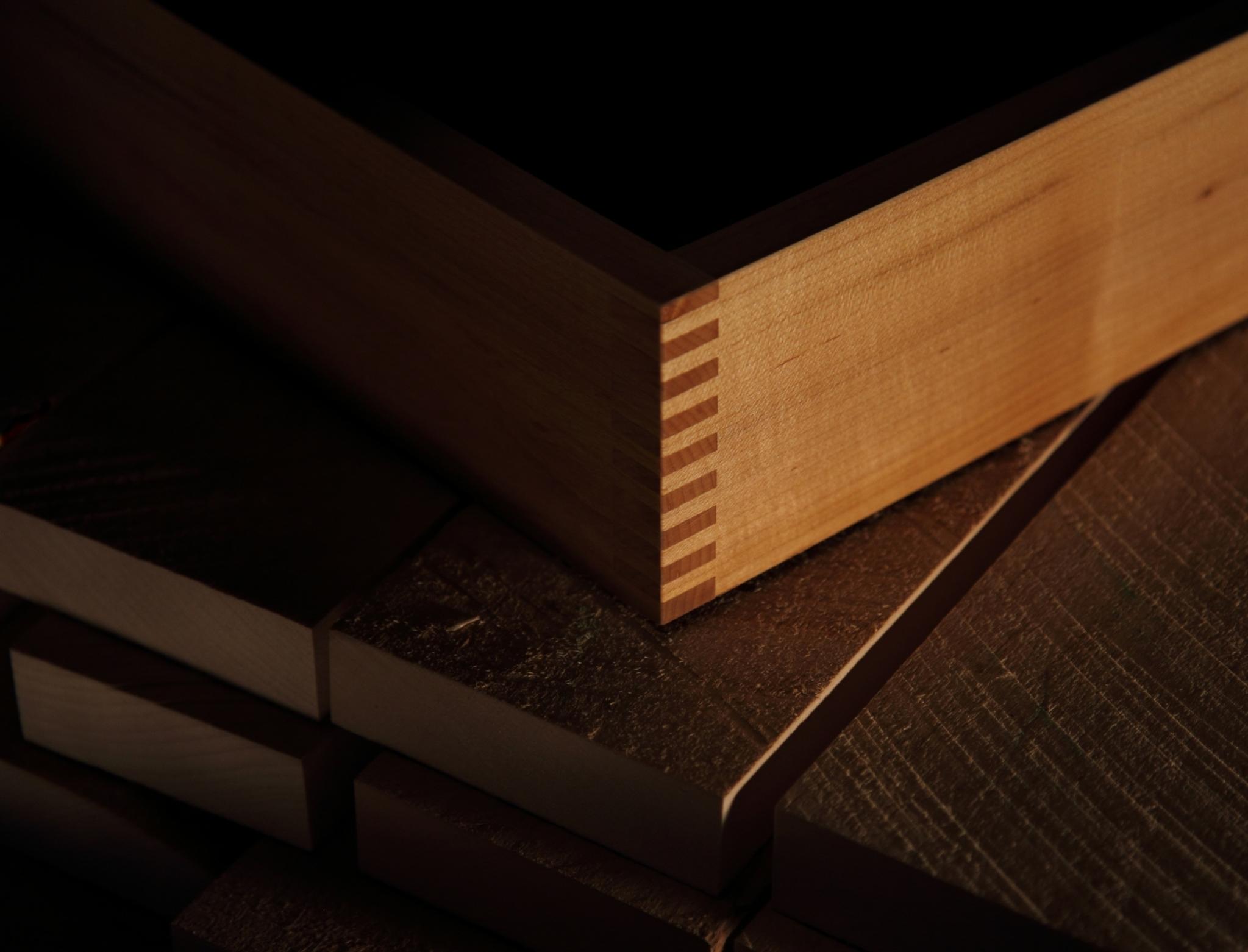

It needs dovetails at the corners. First, fit some maple in, then go with bloodwood. The small sides should be lacewood.
We're going with box joints. Here's a preliminary chassis in eastern hard rock maple. Going to use some slipfeathers in the corners of the bottom piece, and there we can use things like bloodwood.
