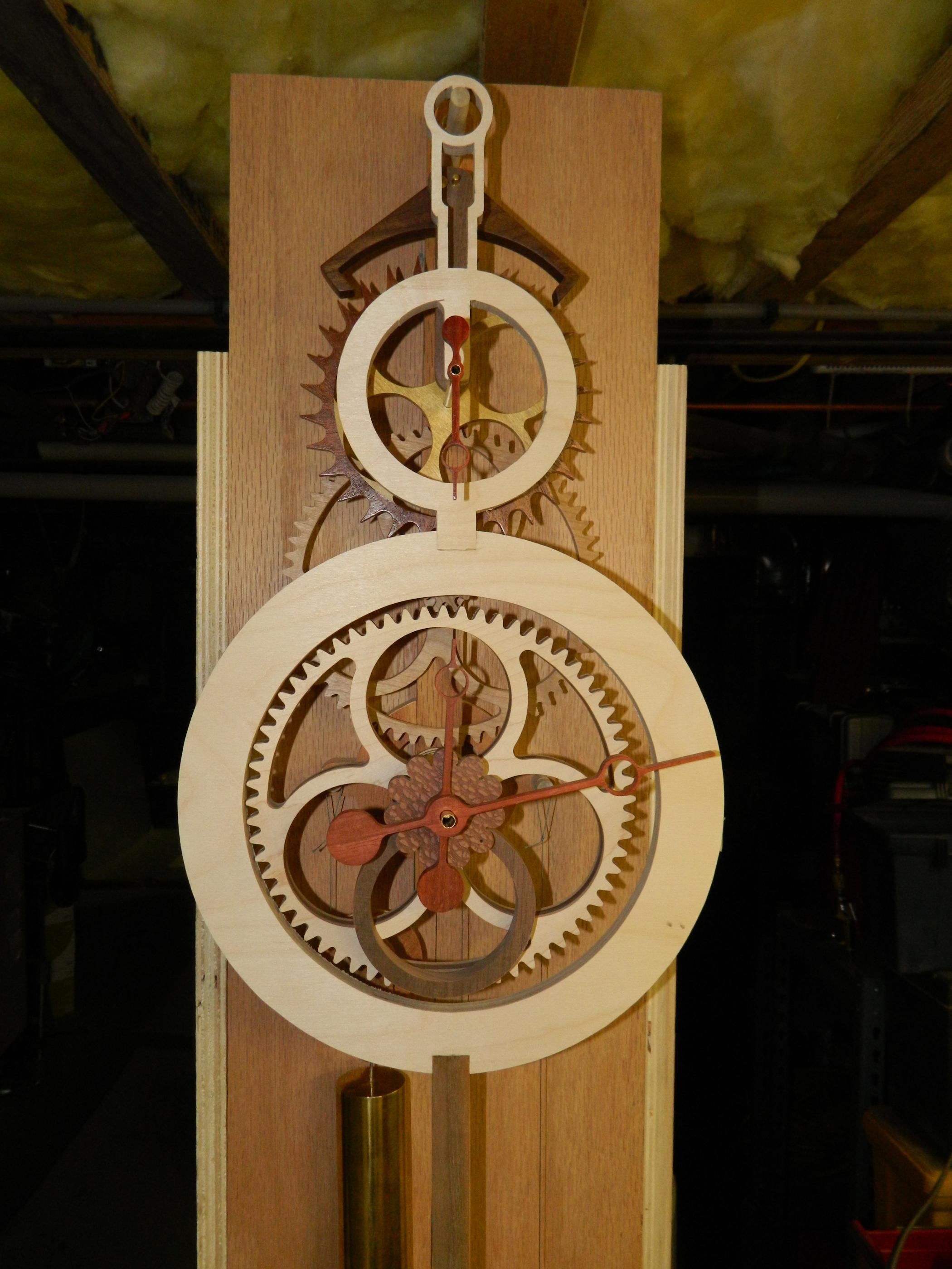

what sort of scale are we looking at here jneutron? its impressive regardless. worth the pulled tendon? anything snap? my friend recently snapped a tendon playing/practicing bass guitar and wont recover for possibly years; I trust your wasnt so serious
The hour ring is about 11 inches OD. The brass weight is 1.5 inch diameter, I filled it with molten lead.
I didn't pull anything, but my hand was numb for about 2 weeks. Figured it was just sore from use, but two weeks was too long to be that. I had some micarda lift off the deck of the scroll saw a year ago, almost lost a nail..so scrolled in fear..

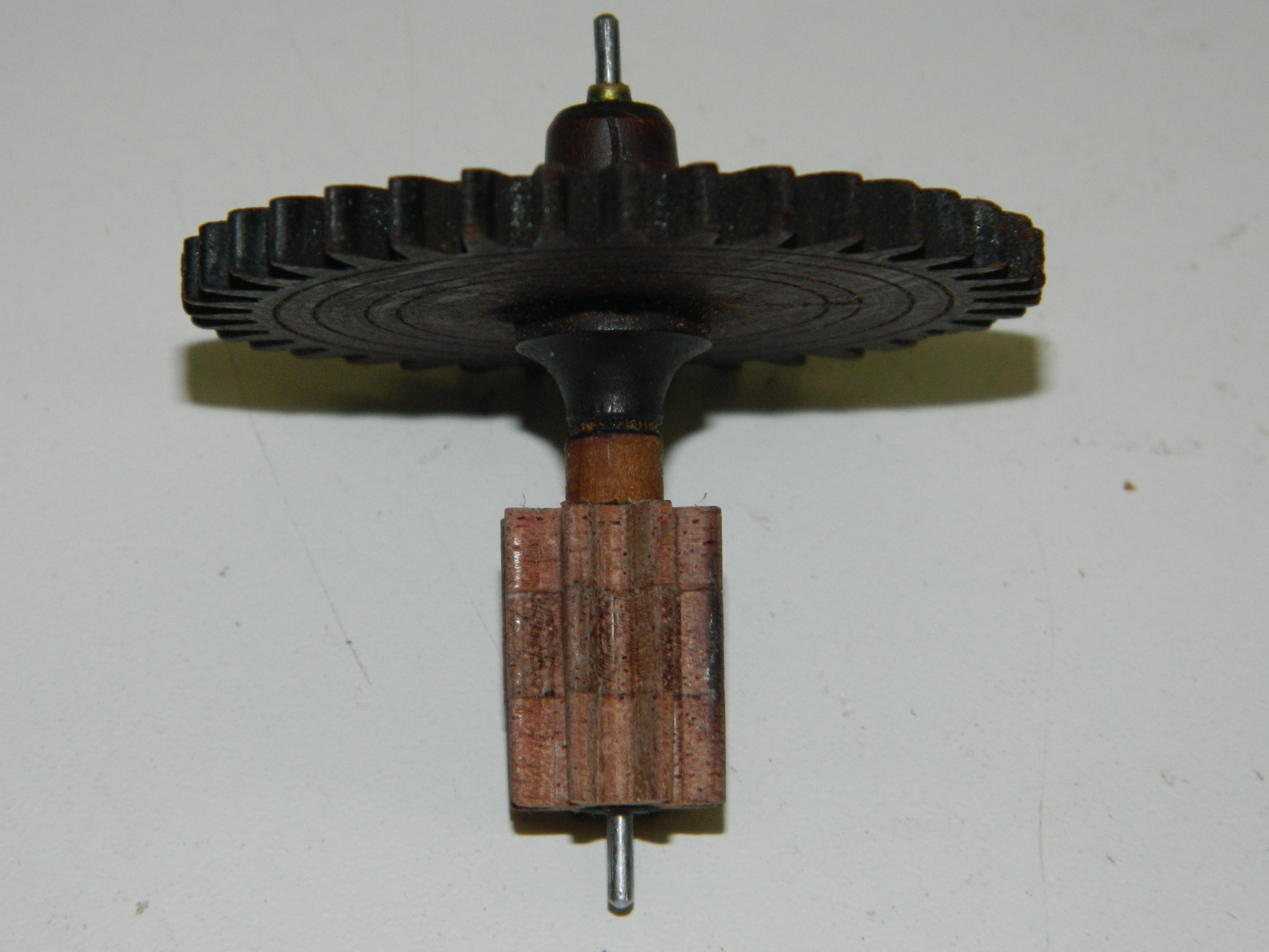

This is one of the repairs from a circa 1800 +/- antique clock. The pinion is 700 mils tall, 550 mils wide, 8 tooth. The blank was made from three pieces of 1/4 thick mahogany laminated with grain 90 degrees rotated. That way, the teeth were stronger.
Stained it later to match. I've already ordered some water based dyes, the pigment stains don't match easily with the hardwoods.

Has in the basics, when you have a part that wears make it harder or in two parts so it is easy to replace the wearing surfaces!
Pretty piece, but if it wore out after 150 years, did you need to improve it?
(Actually a real issue is the wood quality went down with over harvesting the trees, but as wood use has decreased some of the quality wood is back. A good example is West Virginia spruce, highly prized for guitars but almost all was used up to meet the war need for parts for biplanes! It is now back, although I did see one specialty store selling select matched pieces to make 1 back for $150.00!)
It didn't wear out. Apparently there was a winding "incident". Five gears lost teeth. Some only 1, that pinion 3, one lost 18 of it's 36. I thought that maybe the clock fell off the back of a truck at 60 miles per hour, and the tractor trailer tailgating it mowed it down.

We could talk about wood selection. For hand working American Walnut is great but not traditional. For that try Indian Rosewood, strong, smooth grain and finishes nicely. Enough color variation among the wood that you can match most of the older favorite woods.
Real Mahogany is hard to find and tends to chip a bit when carved.
Many years back my father repaired a dining room set single chair. It had a curved engraved back. I gave him a piece of mahogany, he cut and carved it, then we steam bent it to fit. Putting the finished piece back in the set we realized the originals actually used a mahogany finished softer wood. It would have been much easier to make. The set is still around and no one else has ever noticed one chair back is real mahogany and the rest fake!
I didn't pull anything, but my hand was numb for about 2 weeks....snip
I'm really having fun learning about how the different woods work. Some of the gears are ash, mahogany seems good with it. Walnut is closer in color, but it seems to have some issues in workability. Small geometry cross grain has been problematic.
