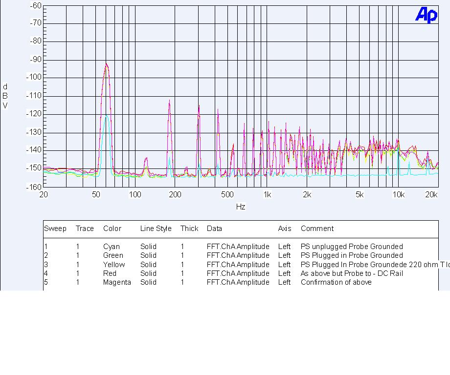

Here is a set of measurements on the noise from a power supply.
The lowest level trace is with the power supply unplugged and the probe shorted to the output ground of the power supply.
All the rest are virtually the same. They show plugging in the power supply even to a shorted probe introduces noise. The noise doesn't change even when looking at the DC rail output. All the noise is what was passed from the AC line.
Any questions ask Dick he's an expert on AC line noise.
ES
P.S. the dB reference level is 1 volt.

So, let's go back to Pavel's comment (which echoes the same comment I've made a few times in the past couple days) and look at this as a system instead of one piece in isolation. The noise of that supply is pretty low (how you determined that it's from the AC line and not from diode switching, inductive kickback, or whatever is left unsaid)- the worst component is 60Hz at -92dBV, or about 25uV. We hook up the supply do a decently designed amp, which is likely to have better than 90dB of rejection at 60Hz. Now the noise at the output due to this supply is at -182dBV, or 0.8nV. Remember, this is at the output, so input-referred noise from that source is that number divided by gain. I think we're ridiculously below where anyone would care about it.
One may then argue that the PSR of the amp is likely to be lower at higher frequencies. That's a valid point, BUT... if we take a common amp like an AD797, the PSR is still 80dB at 20kHz and the power supply noise is -140dBV. So the noise is even lower than before, down around the thermal noise of the Universe.
You've demonstrated that this is not something to worry overly much about as a system question. The weak links lie elsewhere.
You could hook this power supply up to an amplifier and voila there would be nothing to come out!
This is a power supply for a wideband low noise preamp. The AC to DC conversion is almost as quiet as possible. There is still some regulator noise creeping in!
The next issue on this power supply is to get rid of the common mode AC line noise.
Power supply rejection ratio decreases as you increase the gain of an amplifier and as its bandwidth decreases.
You will be hard pressed to get your hand waving 90 dB if you just put two empty connectors in a metal case.
You can keep making up all the numbers you want. I'll stick to actual measurements.

Thus my use of the 797 as the example amp. The performance at the output is quite predictable, and I'm sure your measurements of the complete system (that's what you agreed was important!) will show that this supply noise is far from the weak link as far as system noise performance goes. You can make a chain out of titanium links and worry about alloying and annealing, but if one of the links is aluminum, you're looking in the wrong place.

Having built preamps it is the AC line noise that is one of the limits. A typical power transformer, diode bridge and filter capacitor into a single IC regulator produces such poor results it is laughable.
Using the AD797 it has around 120 dB of PSSR in the AD test circuit with a gain of one. The open loop gain drops by 60 dB by 10,000 Hz. So with a preamp gain of 60 dB you got nothing.
Now for your chain just make the aluminum link bigger.
Its not always the case that the open loop PSRR plots in the data sheets can be translated in this manner to the closed loop case - it depends on where in the internals of the IC the supply noise creeps in. You've assumed the best-case condition here where its the input stage which is most sensitive and the other ingress points contribute nothing at all. However this might not always be the case.
Indeed, if someone is a bad enough designer to structure the gain that way, they will get non-optimum results (distortion and noise as well). The idea that the designer was not an idiot was assumed in my reply, but perhaps I should have been explicit. It is unclear that the AD797's PSR scales the way you claim but never having done that poor of a designing job, I don't have first-hand knowledge.
