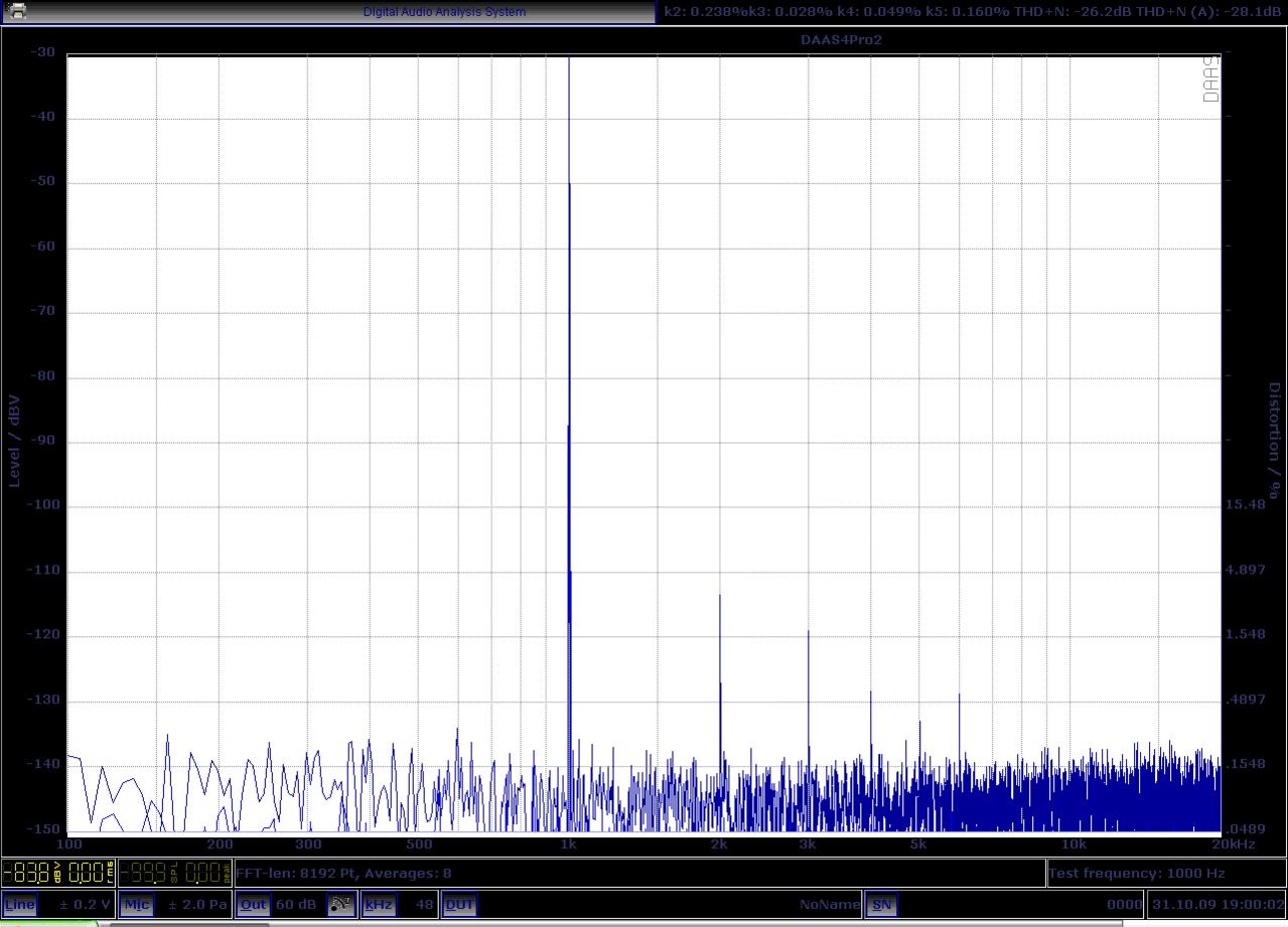

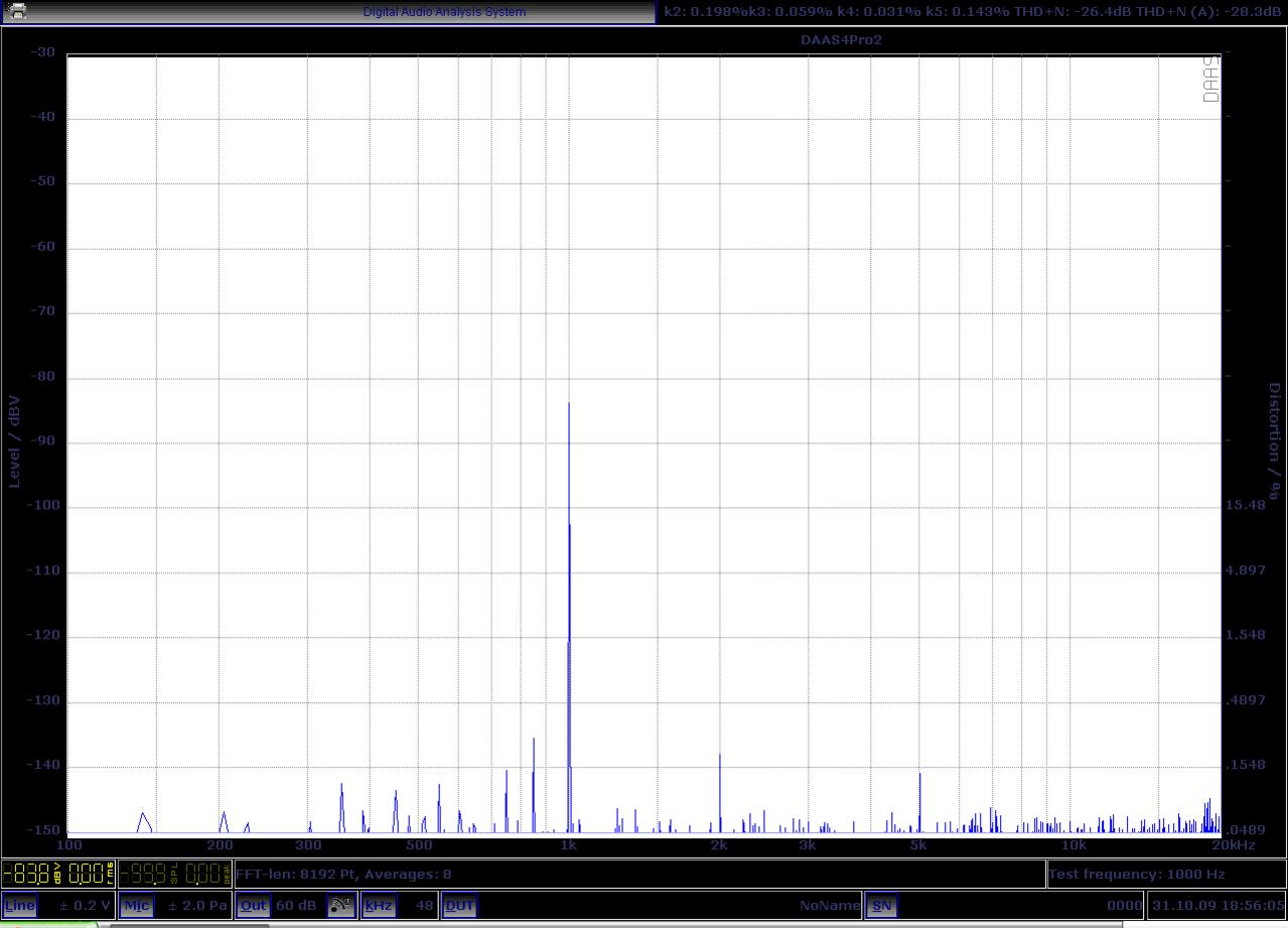

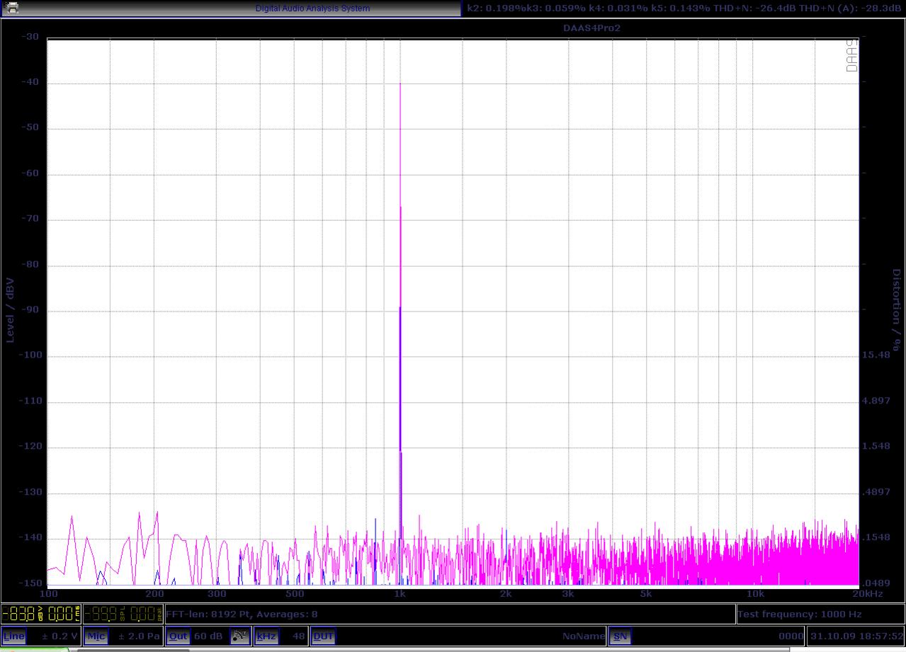

Allan Wright and i listened in my place to his top Tube Stage compared to one of my OPamp based preamp. Ask him. I do discrete too when i try to make the best posible but this little preamp is a lot of fun. The MC input stage in that Pramp is an INA build from two LME49990 and one ADA4627 per channel. A conventional feedback structure with the LME49990 brings not the best sound out of it. I tryed virtually everything, series feedback, shunt feedback, differential etc. and the INA topology works by far the best soundwise. I can not measure distortion in that circuit at cruising level. It is below the noise.
Here come some measurements. This is the resolution floor of my analyser.

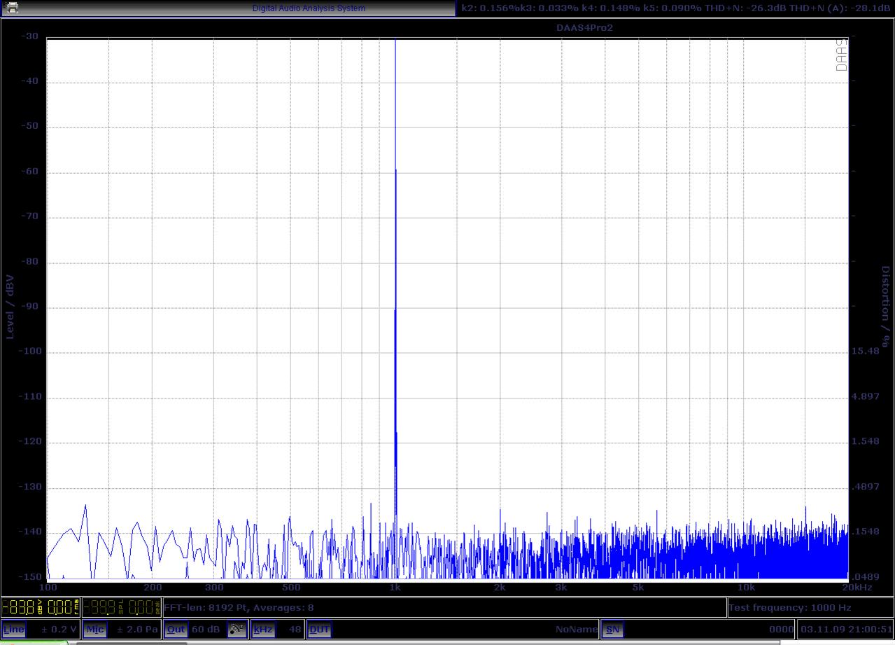

Here come the measurements from an early prototype that used 2 x AD797 and one OPA827. The new version is better. I can reduce noise by 6dB with paralleling of input opamps but then it gets expensive again so discrete whould be more economical.
