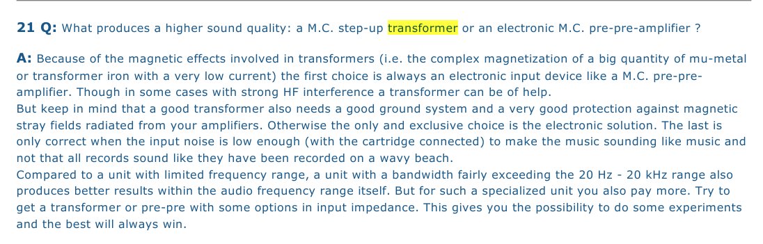

Allen, he's not talking about the signal from the cartridge, he's talking about the electron charge transfer into the transistor base, an internal mechanism. Let's get a feel for the signal numbers:
Take an MC with a typical output, say 0.2mV at 5 cm/s and 1kHz. The cartridge is likely to have a self noise of -70dB below that, which is about 0.03uV. Now, for argument's sake, let's pick an effective load of 100R. That means the signal current is about 3 x 10-10A.
By definition, an ampere is about 6 x 1018 electrons per second. That means our signal current is about 1.9 billion electrons per second or 1.9 million electrons per cycle. That's not enormous, but it's certainly bigger than "about one."
Doyen of MC magnetic design, van den Hul, has no doubt about the difficulty of conveying low-level cartridge signal through a magnetic circuit.
THis from his 'Phono FAQ' -
van den Hul doesn't sell transformers. :D
His points on shielding are well taken. Very tight balance is also important for noise rejection. It's hard to get a quiet phono stage when the raw supply is in the same cabinet.
