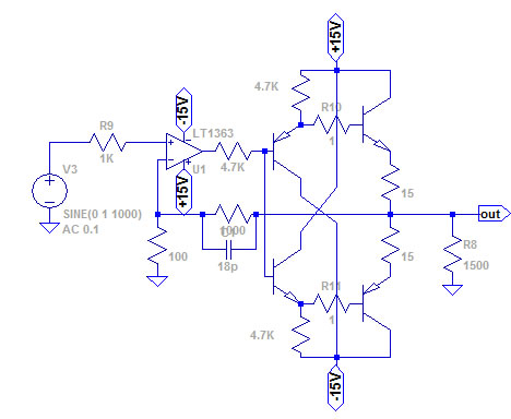

But did he try everything? IC op-amps that by necessity have the compensation capacitance referenced to one of the rails benefit from things like I proposed on the AD8010 datasheet. For its day this was a rather substantial load for an 8-pin DIP. 8 parallel 150 Ohm video loads at SOTA diff gain and phase (i.e. inherent linearity).
Will pass this technique along and see if he tried it, yet.
