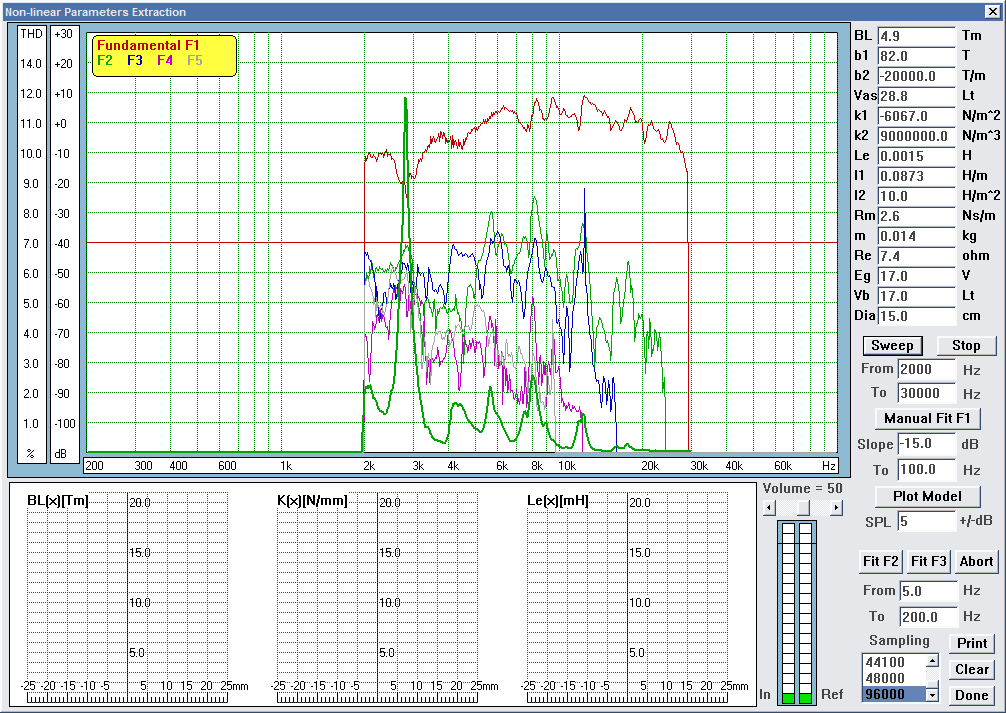

Fs increases with signal amplitude, because the spring constant of the suspension decreases with displacement. It was fun to model this in the simulator.
keantoken, next you may have to bench test a few speaker units.
My measurements show that Fs decreases with signal amplitude (still within ‘small signal domain’, i.e. less than ¼ of max excursion).

A couple thoughts on suspension non-linearity.
There is no perfect spring or perfect anything in the real world. Really good Springs (music wire) have a fatigue cycle and only last a long time (many operations) if they operate at a very low point on the curve. When you examine a driver suspension, one has a material that also has mechanical damping which is a real issue. The damping means motion is converted by mechanical resistance to heat internally and many materials have temperature dependent properties.
This can appear to be hysteresis, temporary changes in spring constant that change immediately after operation.
Not all problems are manifested equally;
For example, a low Qe, high Qm driver, with a low Fs, when put in a box small enough to raise the Qtb to .6 - .8, will have much less suspension contribution than a driver with a higher Fs and Qtb.
The reason is with the small sealed back volume, the air “spring” is far stronger than the suspension’s “spring”, the air (acoustic suspension) is normally a much more linear spring than a mechanical system.
For bass horn fans, one might notice this is the configuration one has in a modern / proper bass horn.

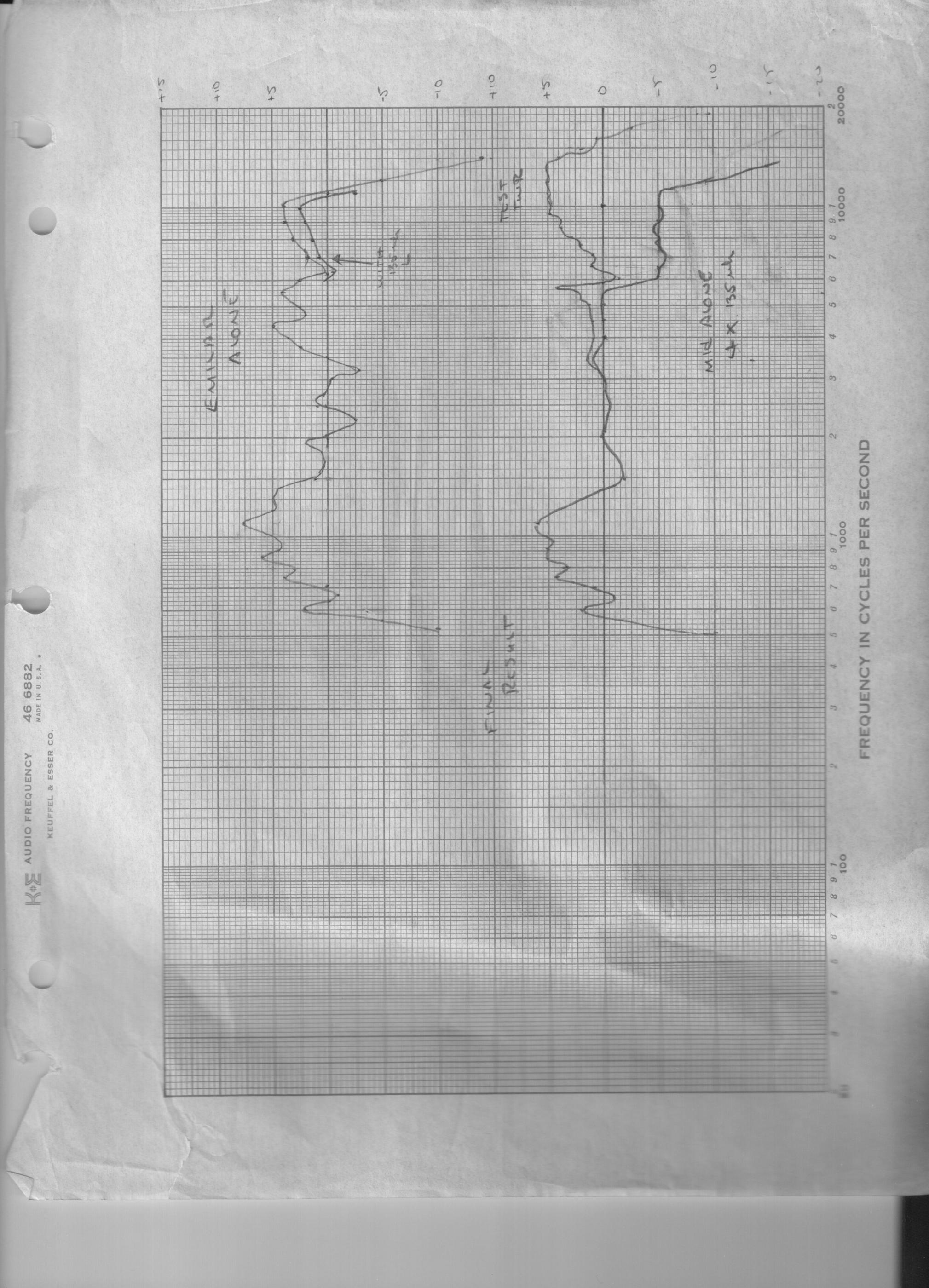

Do-you remember this cheap Audax tweeter TW8B with a metallic cone, used by Elipson ?At least it EXTENDS to 20KHz. I would prefer more.
It sounded very bad ! (omho)
![TW8B-DISTO.gif](/community/proxy.php?image=http%3A%2F%2Fjipihorn.free.fr%2FDocuments%2FDivers%2520Blog%2FTW8B-DISTO.gif&hash=592d0f8ac2d7480979e876a1e963dd6d)
I was not very satisfied with this one too: http://diyparadise.com/w/part-recommendation-fostex-ft17h-horn-tweeter/
Oh, by the way, the curve of my horn is not smoothed more than necessary to see the accidents in a comfortable and efficient way. Measurements for work and design are not commercial ones.
