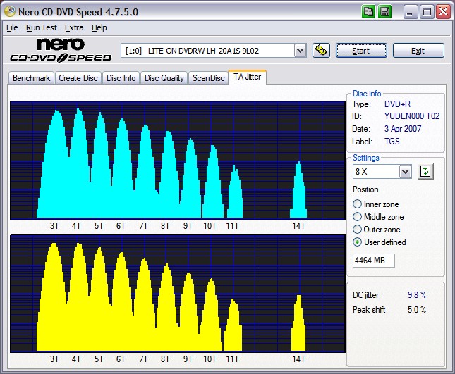

Here is a test of a disc with a jitter playback problem and the jitter would increase the amount of read errors. Not that the errors would not be fully corrected.

I'm trying to figure out if your understanding is really this poor or if this is deliberate. I vote for the latter.

Let me clear this up for you. I was referring to an external D/A. The internal D/A is driven by the corrected signal which is internally clock controlled. So with an internal D/A you have discrete time and discrete level.
For those folks improving the CD player with an external converter that again requires a PLL to receive the data.
So the theory says that an internal converter should be better. However most implementations do not achieve that.
The best would be a well isolated converter that gets data and clock signal.
jitter problems are NOT about the bit being the wrong bit. There is no data integrity loss. What is the problem is the timing of the data delivery to the final d to a conversion. This causes an incorrect translation of the data to the analog signal. Its a timing error, period. (bad pun).
