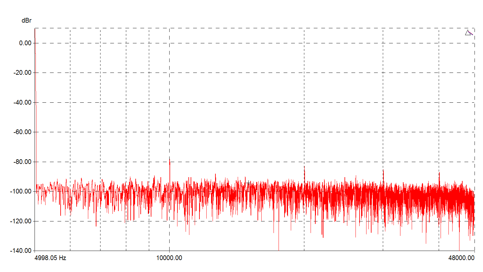

Especially for Ed:
Two measurements of my QUAD 405-2 at 1W into 8R. Bridge tuned for minimum 3rd. One is with stock 330k (!) feedback resistor around the input opamp. The other is with this resistor replaced with 5 x 68k quality film R!
The small black cross in the noise is the 3rd.
Sometimes you are right on target Ed

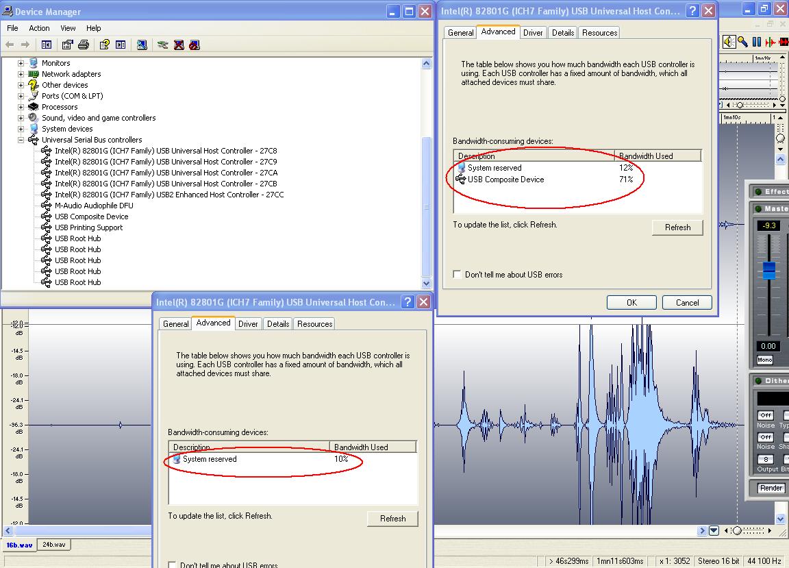

I did some reading since yesterday. The 24/96k is indeed considered the limit for native mode USB Audio Class 1 drivers Audio USB.
I also read that the overhead alone can amount up to 10%-15% of the channel data traffic.
In this PC there are five USB controllers. The four are tagged (each) as reserving 10% of BW for the system. The one that handles the external sound card, reserves 12% for the system and assigns 71% of the BW to the card.
Question 1: Is each USB controller managing 12Mbps or all five are sharing the 12Mbps?
Question 2: What is the 100% BW? The 12Mbps, the 480Mbps, something else?

The bandwidth is shared and between other reserved use and the way the system communicates 24/96 is the highest you can get on a 12 Mbps link. Also if you have even a mouse sharing the link you will have problems. Most PC's have only 1 or maybe 2 USB controllers so all the traffic passes through the same controller.

Interesting one on PC USB, found this that may help...
motherboard - When I connect 4 USB drives to my PC at the same time, does each slot have 480 Mbit/s? - Super User
So I would presume that handling 12Mbps should be achievable for the external sound card as it has a share of the total USB controllers bandwidth of 480Mbps, if only one controller.
Thank you Marce, it helps.
They make it clear that each USB Host Controller is assigned the full bandwidth (12Mbps for USB 1.x, 480Mbps for USB 2) and splits it among the devices that are attached to it.
