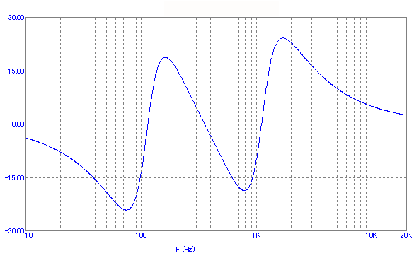

If you examine Nelson's load model, you see the reactances. Anytime there are reactances, there will be operation in Q2 and Q4. (unless sines are used at the exact frequencies where phase is zero.)
And here is the phase plot of that model. If you want wilder, just reduce
the resistance in series with the LC elements.

If I drive a reactance with a voltage sine, the VI plot will describe an ellipse.
If I add a second hf signal driving it's reactance through the crosover, it too will describe an ellipse. HOWEVER, it's V/I plot will be an ellipse centered on the point of the LF ellipse as it traverses it's V/I plot. There will be times when they have the same direction on the V/I plot, times they are 90 degrees apart, and times where they subtract. Like a spirograph.
There will be times when the LF point is on the zero voltage/max current axis, and the HF ellipse will still extend the current out. Yet, at that point in time, the headroom available to the HF is full rail voltage.
When the two or three signals are correlated in some fashion, say a hard percussive, it's easy to see how various reactances can cause the current envelope to be exceeded despite not hitting the voltage one. Remember, capacitive and inductive reactances rotate opposite in V/I. Even single drivers change from one to the other.
