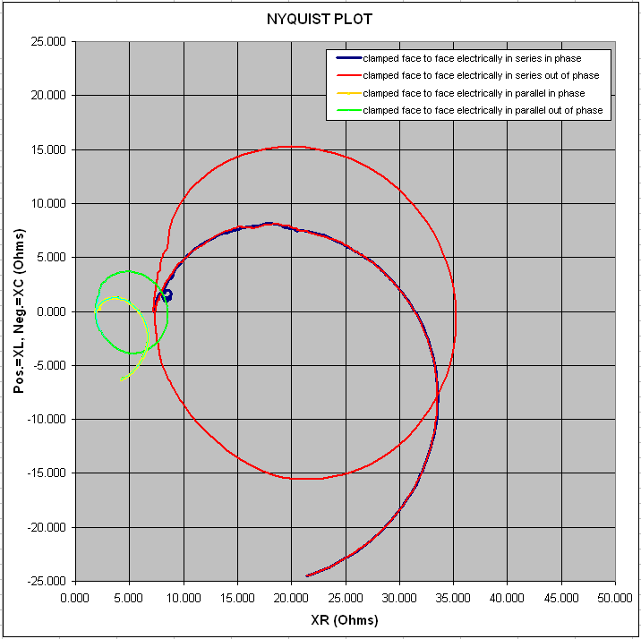

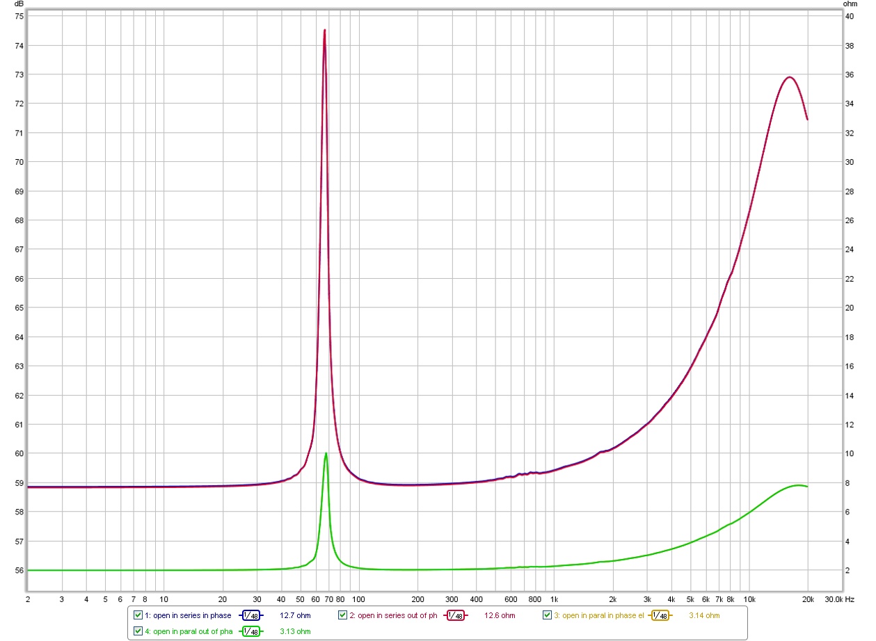

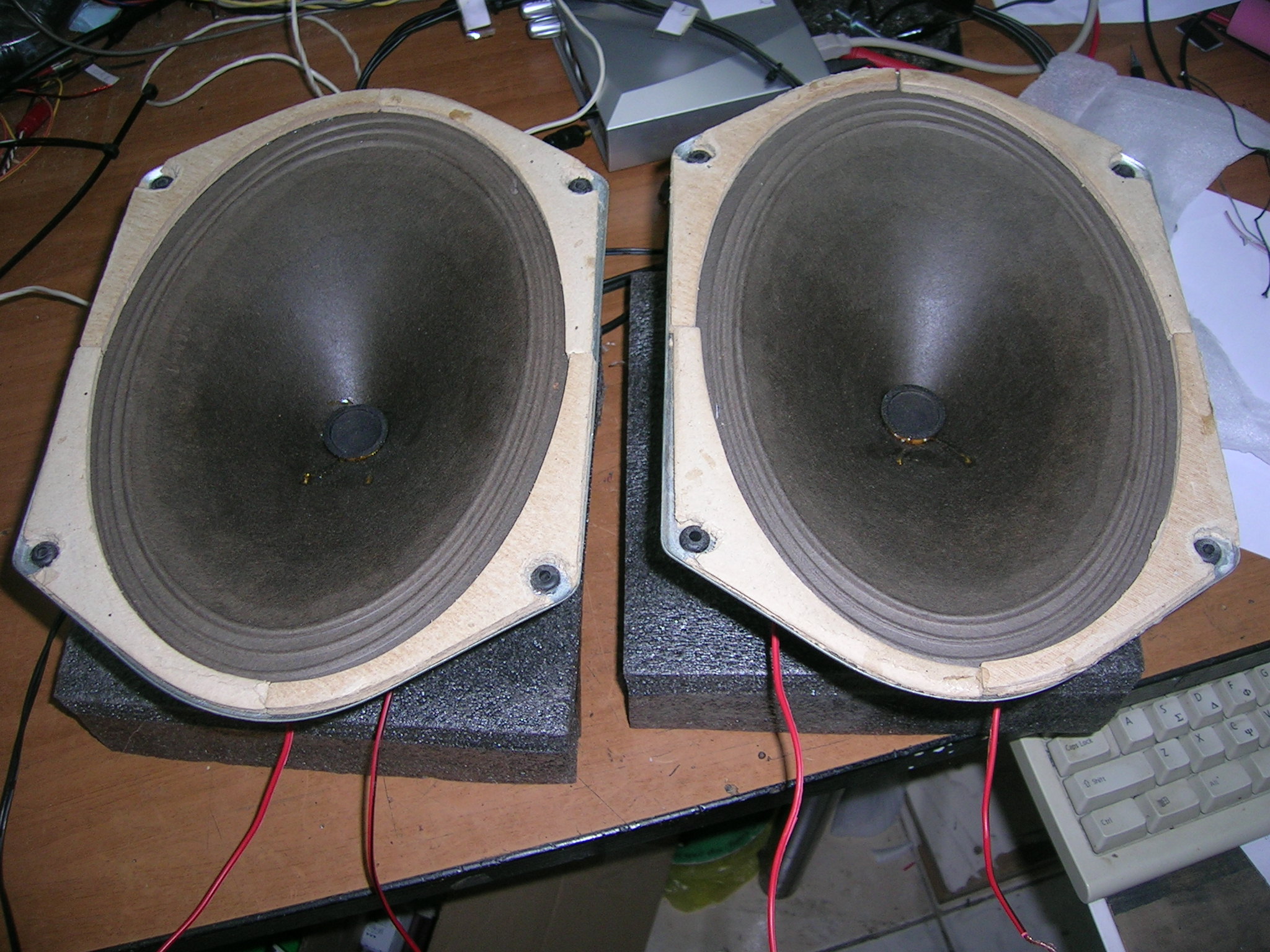

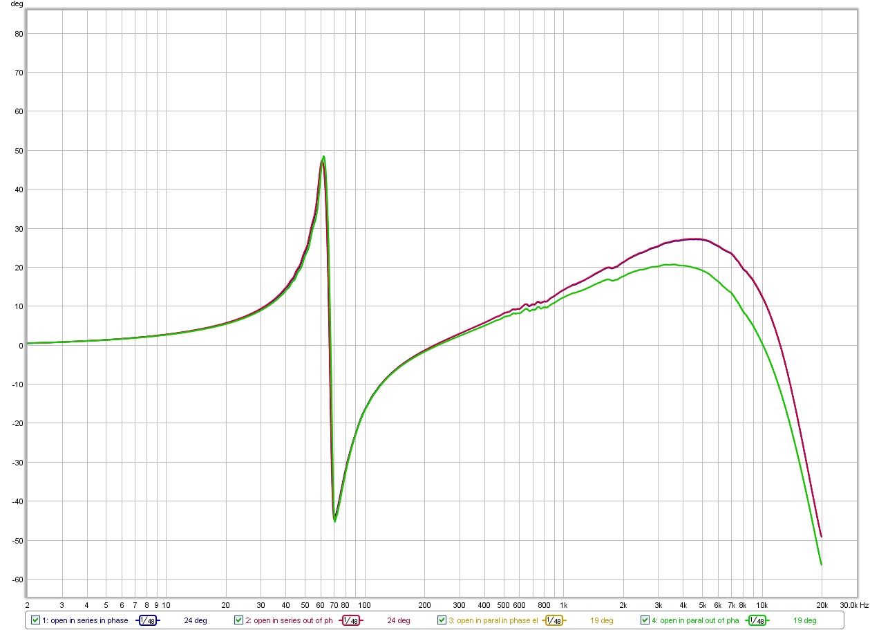

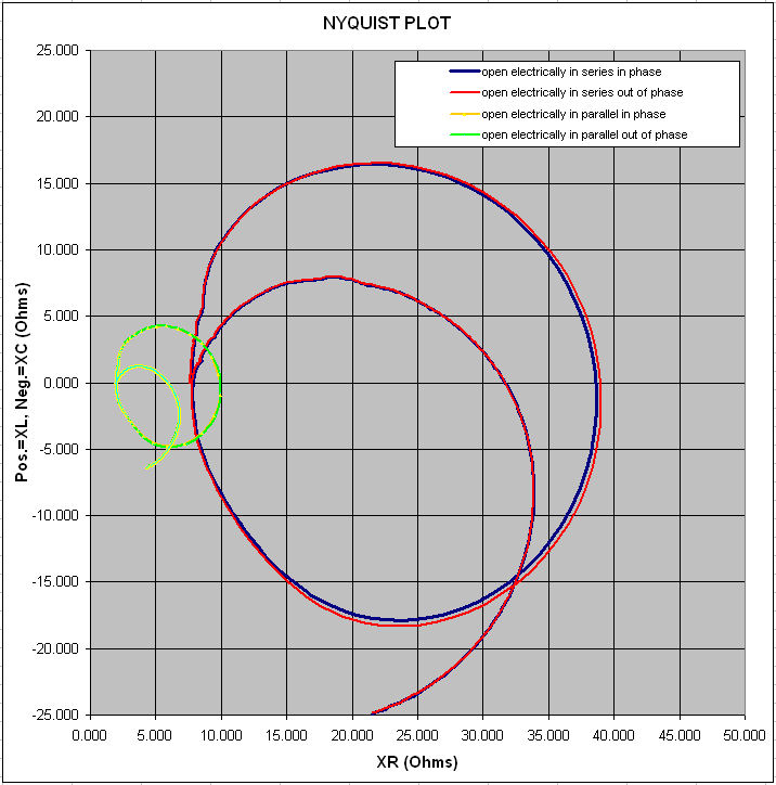

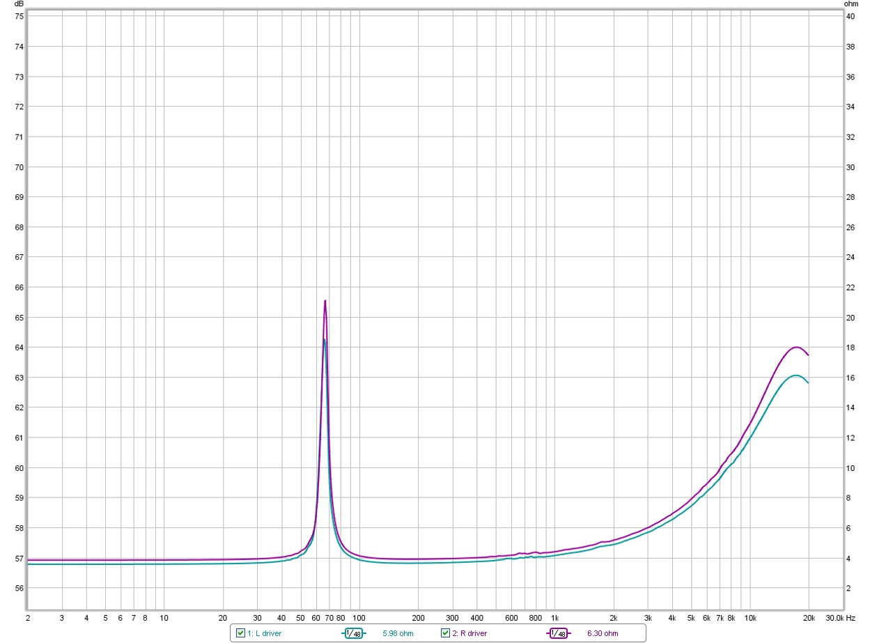

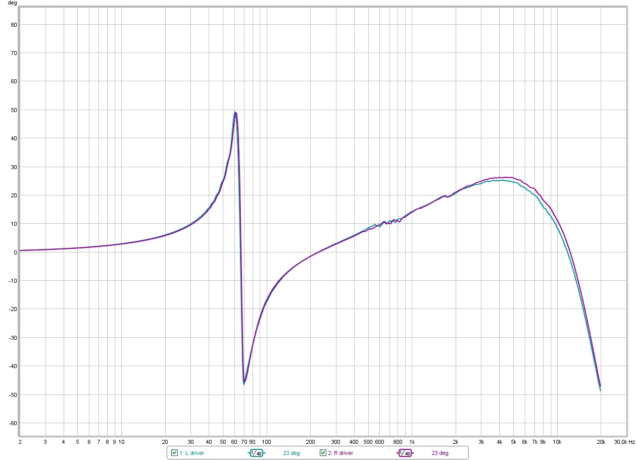

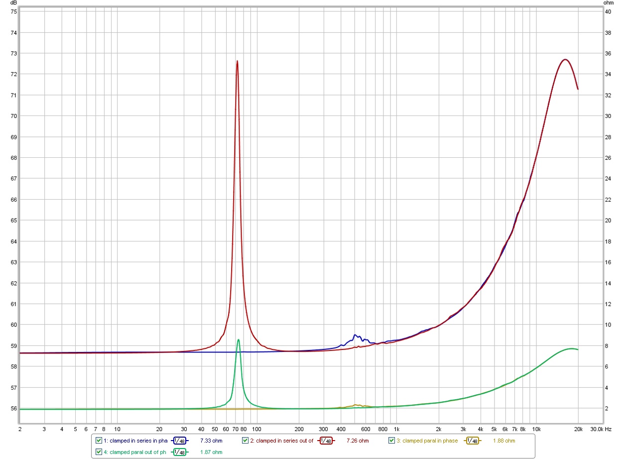

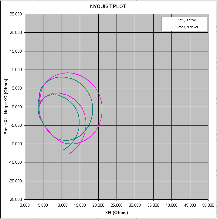

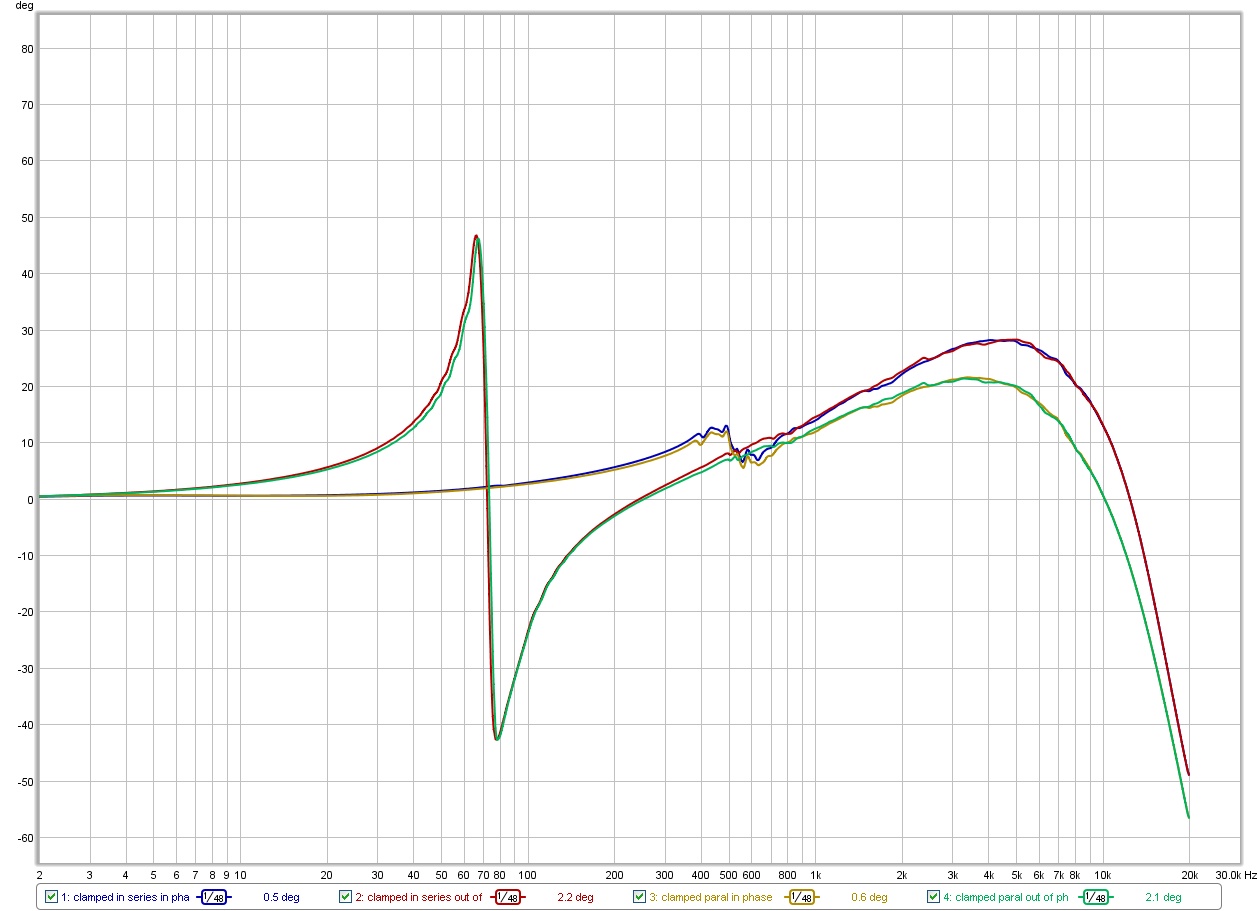

With the means I have and under the restrictions (if any) of sinusoidal continuous excitation, I tried to test the idea that an external force due to adverse acoustic loading may make the moving assy resist the action of the Lorenz force in an awkward way and reduce the Z of the coil below it’s RDC value.
I took impedance plots from two bare drivers of the same type connected in all possible combinations on air (not boxed).
I) Each one single.
II) Both physically placed at a distance to each other to reduce acoustic coupling and electrically connected in series
IIa1) in phase and
IIa2) out of phase.
Then electrically connected in parallel
IIb1) in phase and
IIb2) out of phase.
III) Both physically placed face to face, clamped against each other to maximise acoustical coupling and electrically connected in series
IIIa1) in phase and
IIIa2) out of phase.
IIIb1) in phase and
IIIb2) out of phase.
DC resistance as measured with a Keithley 175 bench multimeter is
1st driver: 3.53 Ohm
2nd driver: 3.84 Ohm
Drivers in series: 7.4 Ohm
Drivers in parallel: 1.86 Ohm
By looking at the impedance plots, there is no case which shows an impedance lower than the DCR of the respective electrical connection.
Arrangement III (speakers face to face, clamped against each other) presents a strong acoustic coupling of the cones.
When coils are electrically connected in phase, cones are moving in opposite directions and so acoustic loading hinders cone movement, thus no impedance peak at resonance.
The motional impedance at resonance is nullified, the Z drops down to the DCR value.
