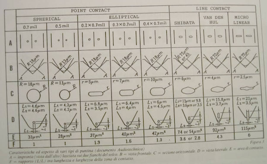

The gist of all those pictures...
"articles by Reto Luigi Andreoli, in "HiFi Scene Schweiz" ("The Truth about Cartridge Sound" etc.), where, after a thorough analysis of the geometry/mechanics involved, a major conclusion is that a spherical stylus point of appropriate radius should result in lower distortion - and that in his opinion most of the fancy "audiophile" (VdH etc.) stylus profiles appear to sound more detailed and with better HF extension BECAUSE OF added non-linear distortion in the upper octaves. (Any non-spherical stylus will fail to track the groove at a constant depth due to groove amplitude and cantilever deflection, thus introduce non-recorded vertical distortion components to the signal - in proportion to lateral cantilever deflections. Quite obvious once one gets the whole picture.) The well known "pinch distortion" is part of the same issue, and opinions differ as to which practical approach results in the most "correct" reproduction - which may be a matter of choice between different evils."
I wish I had a translation, seems provocative.
Thats what i want to say all the times to you all.
ONLY SPHERIC tips work well with Cantilever based cartridges! All other shapes make no sense, just a different sound due different distorsions and resonances.
Mr. Andreoli ( the maker of my Silver Spirit) shows clearly WHY this is true.
Because grooves cutted are tangential and cantilevers work NOT tangential.
Someone should really translate this article in english. No need to be an engineer to understand it.
Joachim can read it in german and explain.
It had to read it many times to fully understand.
In short, he explains, why spheric is better than ANYTHING else on CANTILEVER based Cartridges. And that the damping rubber makes the biggest sound difference at MCs. And that a proper mounting and alignment is important. And that the cantilever has no defined absolute position, this say, short cantilevers give higher output and higher distorsions, long ones vice versa. But long add mass and so on...

The eliptical stylus was developed in the 1960s in recognition of the fact that for a pivoted tone arm, a spherical stylus would not maintain contact with the same points on the disc as the radial arm cutter and that a spherical stylus in a pivoted arm would result in "pinch distortion" especially evident at the inner grooves. Careful design of the geometry of the arm including optimal overhang for its length, mounting location with respect to the center, and optimal offset angle of the headshell was used to further reduce this pinch effect.
Anti-skating was also added in the 1960s in recognition that the spiraling of the stylus inward would result in uneven distribution of force between the inner and outer wall of the groove. This was made even more imperative because the reduced area of contact eleptical styli offered increased the stress on the vinyl. At high modulaton especially at high frequencies the forces on the stylus were great enough to cause mistracking unless additional vertical force was applied. Anti-skating is a lateral outward force applied to the tonearm to compensate for this effect and equalize the inner and outer wall force on the groove, the goal not to exceed the modulus of elasticity of the soft vinyl and accelerate record wear. The amount of anti skating force has to be adjusted taking into account the amount of vertical tracking force.
Two other trends emerged in the 70s. the multi geometric tetrahedral or Shibata type styus was designed to increase the contact area reducing stress. This was especially necessary for playing CD 4 discs because the rear channels were encoded in frequency upshift bands between 20 khz and 40khz. When these discs are played with styli with relatively high stress levels, these parts of the groove are easily and quickly shaved away. The other trend was the micro-ridge geometry which seemed to carry the eliptical concept in the opposite direction.

Cutter Stylus Geometry vs Playback Stylus Geometry
I have spent a little time examining cutting lathes, and the axial orientation and cutting action of the voice coil motors is radial to the center of the disc, and at + or - 45° to the plane of the disc. However, the considerable tangental reaction force to the rotation of the lacquer or copper being cut is borne by a cantilever at the back of the cutting stylus. This would seem to me to be translating the cutting action from a purely radial motion to a spherical section motion just as in a playback stylus/cantilever system.
The length of the cutter cantilever would determine the radius of the spherical section being circumscribed, just as is the case with a playback stylus. The difference in cantilever length between the cutter and playback head would determine the amount of differential tangental modulation due to groove amplitude (there is no tangential error with zero modulation). Does this paper we are referencing here delineate this effect? It would seem (oddly enough) to be a time-domain distortion dependent on amplitude, since a tangential error is forward or backward in time as the disc rotates (yet another source of FM?).
As far as spherical stylui being optimum, considering the diameter of a stylus as it enters the groove, a purely spherical cross-section stylus will have a contact patch too long in the tangental axis to allow for accurate tracing of high frequencies, this is the reason that there is back-clearance ground into the cutting stylus profile. If the spherical radius is reduced to allow for accurate high frequency tracing, the stylus will ride to low in the groove and interact with debris.
I thought (probably in ignorance) that was the reason for taking small radius contact patches and moving them farther apart on an ellipse with it's major axis oriented radially? It sould seem to have the advantages of a small-radius spherical contact patch with the proper positioning on the side-wall of the groove. I guess the devil is in the details, but couldn't the shape of the ellipse be just so as to approximate a sphere at the point of contact?
I wish an expert in stylus design and grinding could chime in here, not just the hypothesizing of users like myself.
Thats WRONG!!!
The cutter works radial. Yes
The stylus tip on cantilever never, because it is similar to a pivoted tonarm.
As the groove is modulated, the cantilever move up/down and left/right to generate signal.
Normal pivoted arms also change the tracking angle,due this circlelike movement while (perfect) radial arms do not. Can be reduced by overhang and offset angle.
Cantilevers have the same problem, but no offset and no overhang!
The cantilever movement on the circle create a phase distorsion, it does not matter, if it will be it a spheric or elliptic or hyperbolic stylus.
BUT : Any non spheric tip will change his radius when turned sideward or up/down, !
Thus the contact surface changes dependent of modulations and you have no real tracking control, this is like a moving target.
If you go for bowling, you will use a round ball, not an elliptic one! Why?

This paper of Mr. Andreoli give answer for all those things.
In the first part you describe what a cutter does and that the cutterstylus is somewhat angled.
Yes, thats why cantilevers are not mounted paralled to the record surface and why VTA setting is important.
At the inner end every record is not as good as outside.
You write that spheric styli should change diameter at the inner side. So it will be the same problem for elliptical ones.
Ellipitical is perfect for non modulated grooves. Yes.
As there is modulation, they create more errors than they try to compensate.
""The eliptical stylus was developed in the 1960s in recognition of the fact that for a pivoted tone arm, a spherical stylus would not maintain contact with the same points on the disc as the radial arm cutter""
I agree.
As long as the spherical stylus is normal to the plane of the disk, it will contact the same lines.
Why is a pure conical geometry called a sphere?
