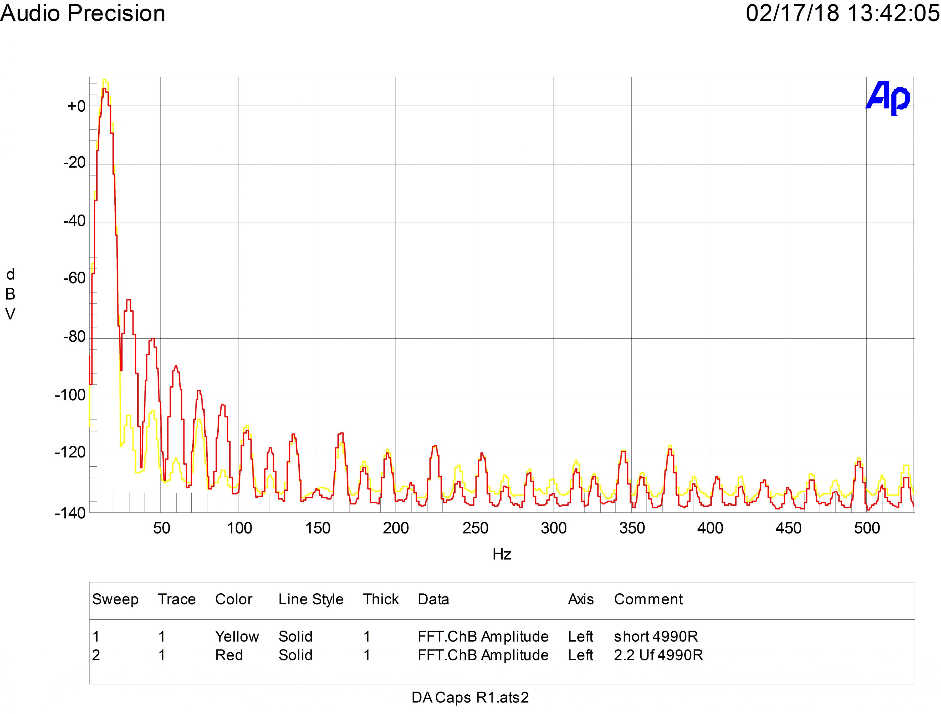

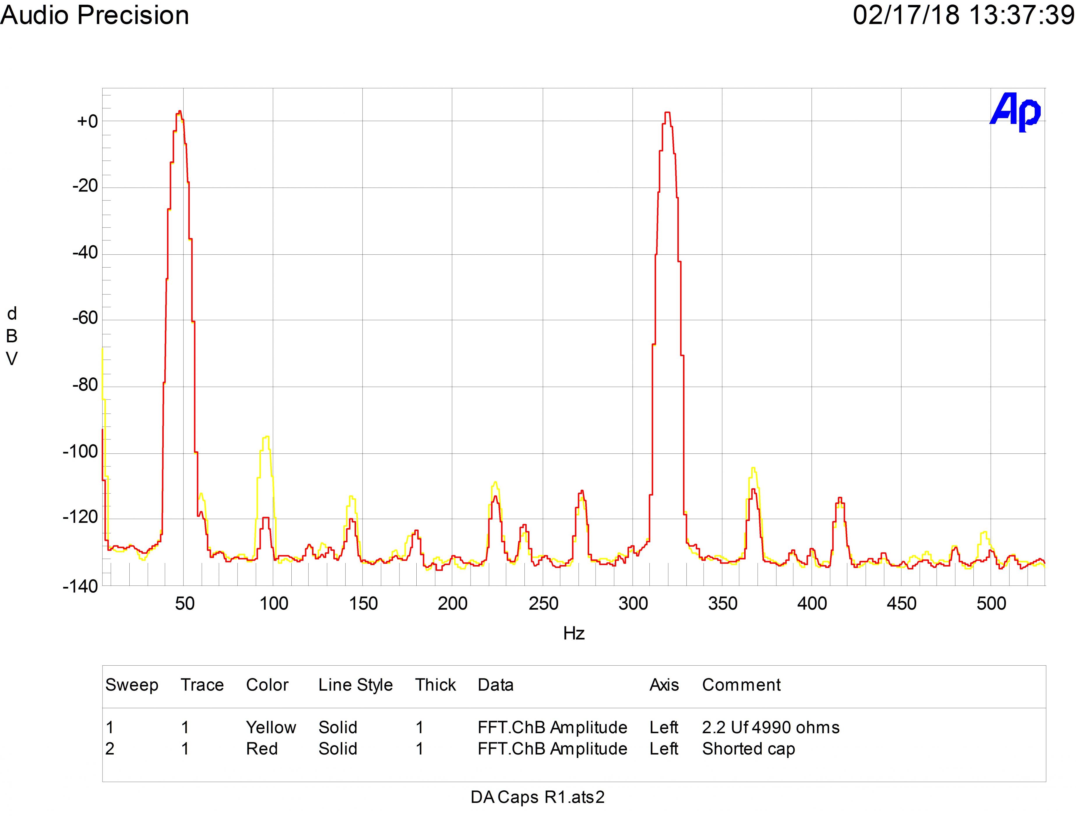

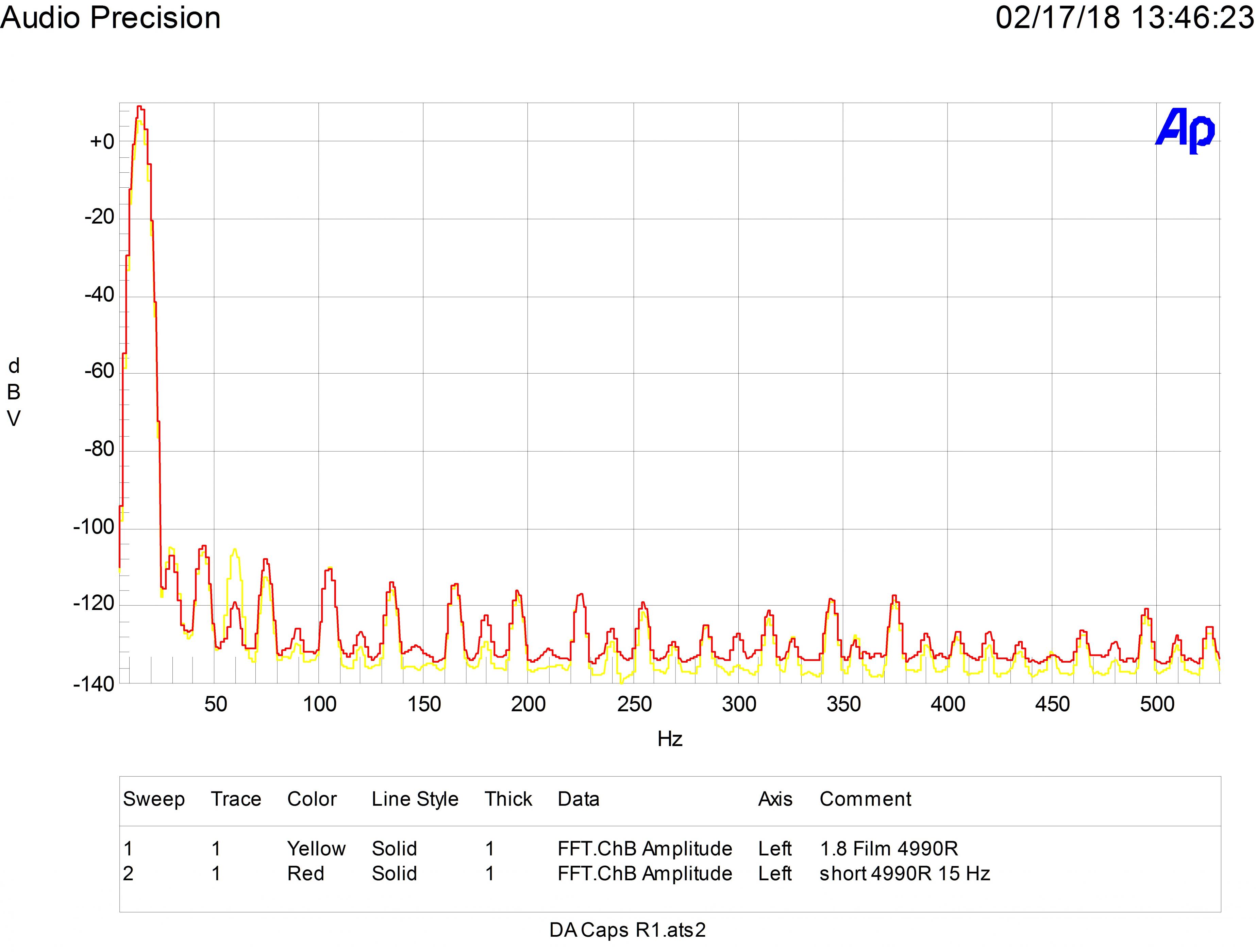

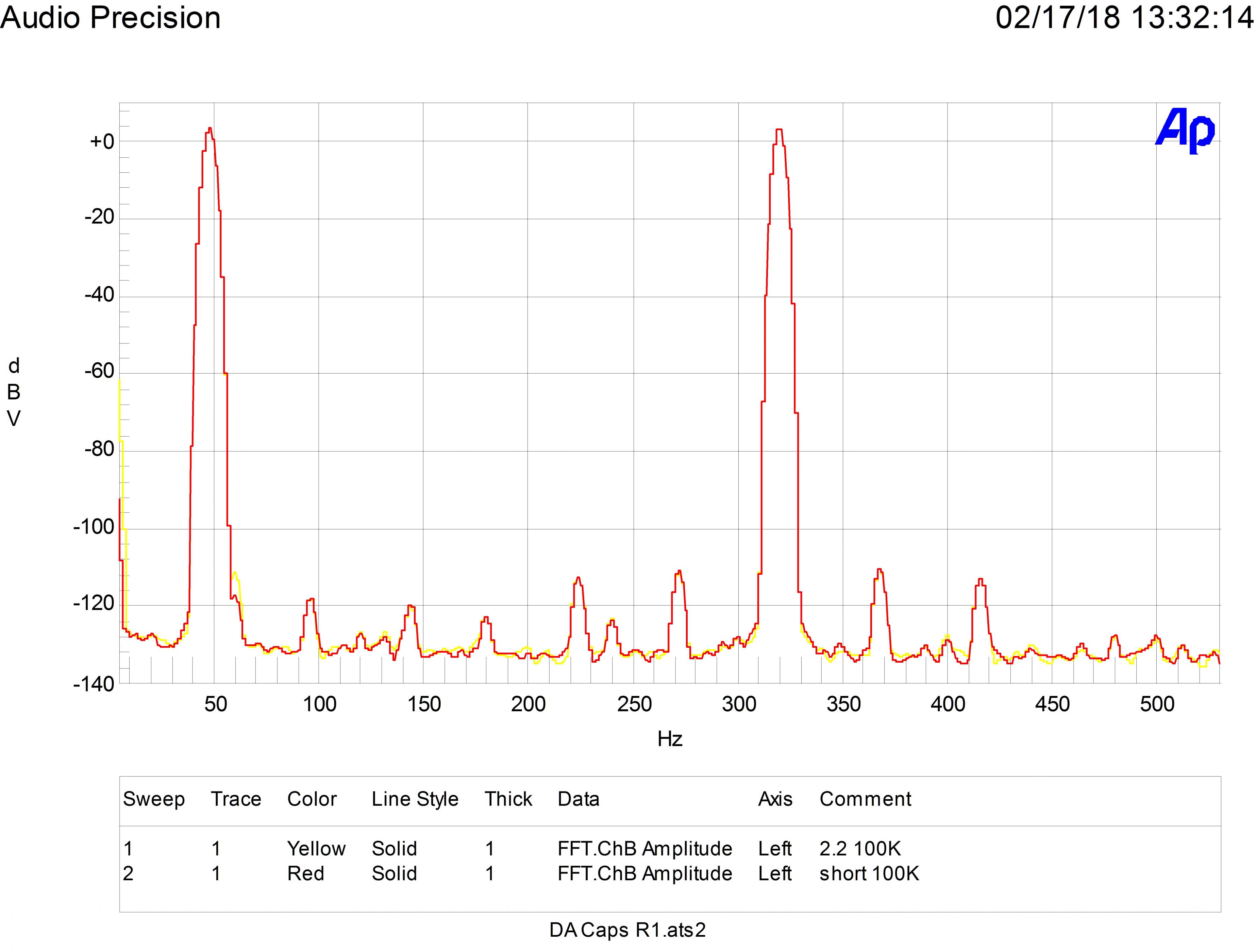

Attached are the runs.
First is 1 2.2 uF 100V electrolytic into a 100,000 Ohm Load compared to just a 100,000 ohm load.
Second is the same but with a 4,990 ohm load.
Third is the same capacitor into a 4,990 ohm load at 15 hertz where the impedance is close to the resistance, also compared to no capacitor.
Fourth is a 1.8 uF polypropylene capacitor under the same conditions.
I think it is very clear that where you develop voltage across any capacitor then the distortion of that device comes into play.
I also used the B inputs and outputs on my AP to be check that both chains worked the same.

As to synchronization of the FFT that is done in the runs shown.
Then why window them? In either case I doubt the first plots of 20Hz and 200Hz were in exact FFT bins.
