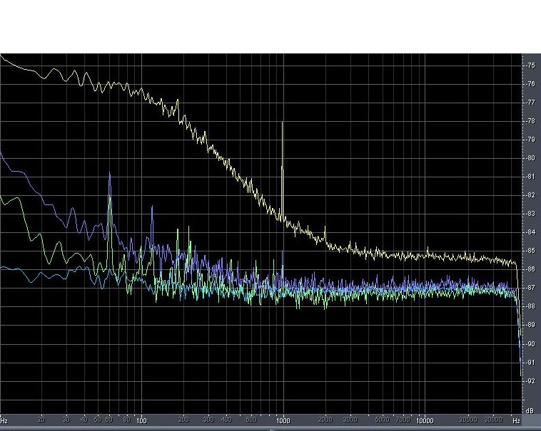

PMA, you are, of course, correct in the recommendation of the 2SK369, IF it is as good as a 2SK147, BUT is it? Have you noise tested it for 1/f? Different process means different 1/f. Trust me, I had to return 100's of 2sk147's when they changed the process, 20 years ago. Perhaps this should be checked out.

They changed to ion implantation and destroyed many 1000's of parts, around 1990 We caught them with a Quan-Tech, and returned the REALLY BAD ones, greater than 10nV/rt Hz at 10 Hz. Sorted out the others, using them for second and 3rd stages, instead of input stages.
You must not read Nelson's forum. It looks like the SK170's still can have problems (top plot). This one is 3nV at 10Hz, luckily. The lower plots are various SK369's and SK372's all better than 2nV at 10Hz. -87dB = 1nV
Why should I read Nelson's form? To clarify this, I am an expert in my own right, and I don't want to 'steal' anything from Nelson, consciously or unconsciously. If I contributed to many threads here, then there might be a good reason for my constant moderation. I can be brutally honest, it comes naturally, and not tempered by 'prep school' training that many have had here, to use diplomacy, rather than direct honesty, which protects tender feelings, with the exception of when one is actually aware of what they are saying, below the polite phrases. I am continually insulted on this forum, both politely and impolitely. Apparently, as I am a known figure, it is OK for many to take cheap shots, usually poorly thought through, such as SY's pricing of input transformers, on this thread recently. Then, I have to respond, double check my figures, and then patiently wait while an overworked moderator finally gets to my input and clears it, for affecting any tender feelings of you grown up guys out there. And so it goes.
