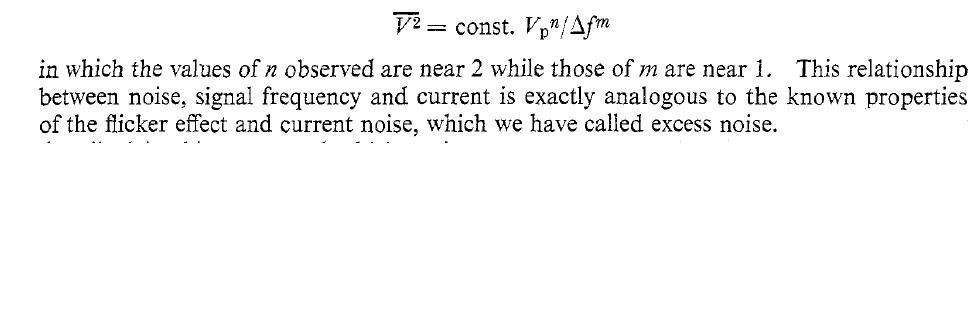

As I mentioned earlier I was disagreeing with the use of the word "excess" noise because it is confusing. Active mixers for instance have modulated noise due to the fact that the operating currents in the Gilbert cell are shuffling back and forth. This signal dependent noise has been studied since at least 1962. The 1/f behavior only will show up (simulation with R, L, C) in a distributed model for the system. This is different of course from when one puts a carbon comp resistor as one leg of a bridge. There you extract the excess resistor noise from the excitation by subtraction. Walt Jung and I built a "perfect" pink noise generator based on this and now I can't find a resistor horrible enough to repeat the experiment.
Sounds like time for an experiment with an ultra-pure sine wave and a transformer. BTW I found some good papers from SLAC on magnetic shielding falling apart at nano-Tesla levels, I would love to see some science applied to this issue it is obviously not nonexistant.
EDIT - I might also disagree a little on this, yes eddy currents are a loss but it is not a given that they generate excess noise (coupled back into the system) especially in a fairly pure conductor.
I have to agree with jcx in this case "no signal no noise" does not really apply the noise in the system is a signal. At thermal equilibrium the eddy current losses will be accounted for, i.e. if I take a transformer and resitively terminate it at both ends the losses will show up in the resulting input/output terminal measurements.
Which is another way of saying I have not observed a transformer losing the ability to pass a low level signal even to the point of the thermal noise of its terminations.

My disagreement is a very fine point. You induce eddy currents and they dissipate heat so you have a loss that's OK. The claim that these eddy currents experience excess 1/f noise as in a carbon comp resistor and this loss is also coupled into your system is not a given.
Yes, thanks for the clarification. The devil is most certainly in the detail.
In the way I read Mr. Neutron, I don't see him making such a claim (that being about excess or 1/f noise). Just pointing out a signal dependent loss - one which you acknowledge already in accepting fractional f.
