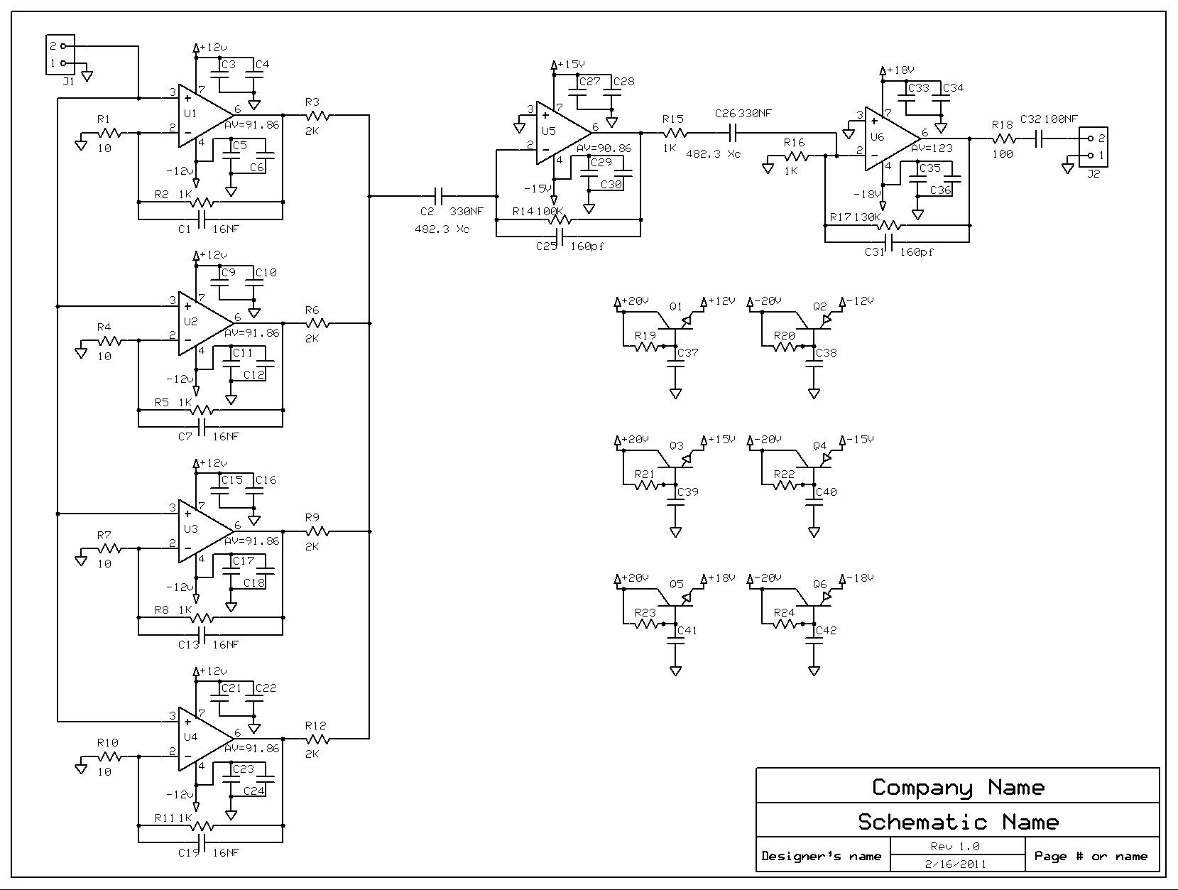

I am making some progress on doing 100nv signals and then bring them up to an easy to look at level. Attached is my current amplifier design. I was planning on using AD797s for the input stage. There are some old notes left on the image.

Show me a JFET circuit that gets 1dB noise figure from 10 Ohms.

Moving back to moving coil phono stages, if possible, it might be useful to talk about the 2'd stage, or the IC op amp with feedback. While it is possible, but difficult to make an open-loop second stage, it is easy enough to make either a discrete, or an IC based second stage with negative feedback. The 627 is supposed to be an excellent design, so we might start with it, rather than something cheaper and potentially more problematic.
The second stage should always be jfet input, no matter what, in order to handle the relatively high input impedance that is often presented, depending on the input stage optimization. Here, the feedback loop should consist of 4 major elements, 3 resistors (precision) and one cap (1%) if possible. 2 of the resistors will set the breakpoints at 500 and 50 Hz and the third resistor should set the gain. There is some slight interaction, so be aware that final 'tweaking' might be necessary.
What I am on the look-out for is the worlds best (in subjective terms) DUAL, mini dip or surface mount, unity gain compensated, jfet input IC op amp. Anyone have any suggestions?
Now, in this position, absolute slew rate, etc, is not so important, because of the early (2KHz) rolloff ahead of the stage, that keeps the signals fairly polite and relatively easy to process. (more later)
