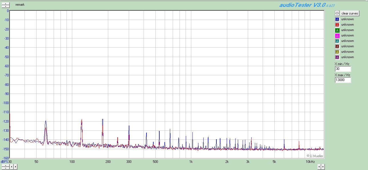

This isn't engineering, it's insanity. This is the same advertising hype that came straight out of the 1960s. University Sphericon tweeter, response to 40 khz. HK A1000 amplifier, flat from DC to light. Audio Fidelity's Frey Stereophonic Curtain of Sound with response extended to 25 KHZ. This kind of talk is a complete rejection of the mathematical principles of Fourier which leaves no room for doubt that response beyond 20 khz serves no useful purpose. But it does have a down side. It not only makes the system susceptable to noise from stray RF and magnetic fields which can interact with the signal at lower frequencies, it wastes power (signal handling capability) at best and at worst can result in spontaneous oscillation that can damage amplifiers and tweeters. A bad choice.
:moon: :wave2s: :moon:
:moon::moon::moon::moon::moon:
Yet, there is no coupling mechanism between the two if there is no current.
No, that is the whole point I am trying to make. The mechanism exists anyway. The random thermal fluctuations in the core sum do not sum to zero, but sum to a thermal energy - just like a resistor. They generate a field which induces a noise voltage in the windings.
Transformers with identical windings, but different degrees of coupling to eddy currents in the core, will give different thermal voltages. You can calculate the thermal voltage by first measuring the resistance at a particular frequency - this will be greater than the DC resistance. The increase may come from skin effect, proximity effect, core coupling (the mechanism for eddy currents), radiation resistance etc. etc. Which ones dominate will depend on frequency. The appropriate temperature to use for the calculation may also depend on frequency, but is likely to be transformer temperature for all except radiation resistance. Sorry to drag us back to this point, but I think this is still not understood by some in this debate.
To try to settle another point, current in an ordinary wire does not generate shot noise. How do we know this? Well, for a start how could we measure shot noise in a valve (which is much smaller than sqrt(2ei)) if the wires attached to the valve contributed even more shot noise too? No, in a wire the electrons can 'see' each other so their flow is correlated - they behave in a similar way to a classical gas. If an electron is 'here', then other electrons are repelled so less likely to be 'here'. As a result they tend to arrange themselves in a fairly uniform way so there is no shot noise. If wires gave shot noise, then any junction would also generate partition noise - all our electronics would get a lot more complicated!
I now want to toss in a new thought. Is it possible that the insulation between laminations may permit some electron tunneling - it is very thin. If so, this may be a source of shot noise which would be signal dependent. I have no idea what the magnitude might be, so this could be a red herring. It would get smaller with thinner laminations, provided that the insulation did not get much thinner too. This is because there would be more insulation layers in series between any two points, so presumably less current.
