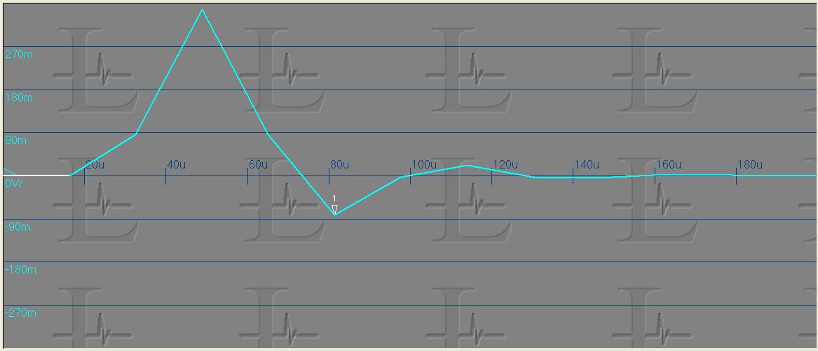

The transient signal I used had some special properties: it was not simmetrical, transient and I made it non periodic by using a single pulse (see image): it was quite similar to a musical note!!
By looking at the time domain shape modification of this pulse I got the "time distortion" qualitative informations I needed. I used the response of the DUT at this signal only on a comparative basis: I needed to get the same response from my device as from the reference. Effectively, I thought, I'measuring the pulse response of the device and this lead me to the first great mistake: to get the same pulse response I have to replicate the frequency response of the reference device, I said me. Nothing more erratic!! This is only theory that works within simulators. But, in real life circuit, the pulse response is affected by the power supply too, by the wiring and all other sort of parasitic components in the real circuit built (capacitances and inductances). The task to replicate a pulse response with a different circuit is not so easy!! Have you ever trayed?
I learnt a lot from this experience.
Well, at the beginning, this was only a sort of theory for me, so I had to validate it. I took a more manageable circuit, a line level pre, and started the tentative to make a "clone". The candidate was the pre that I found as the best sounding in my system: a Threshold Fet Ten (of Nelson design). I built two circuits: one with an ECC88 and one with an LF411. I succeed with the tube circuit only. The reasons are that the open loop topology of the tubed circuit give me more freedom in shaping the pulse response; with the IC I had to fight with its internal constrains and I failed at the end.

I'm only making two devices have the same pulse response on a time basis.
I made an iteresting experiment many years ago: a comparison between two pre with the same pulse response but with very high THD difference (a discrete op-amp with high NFB and a 2 Fet open loop with 1% THD): I was unable to distinguish any differences between the two devices with normal musical signals.
I believe that our ear is more sensitive to minimal time differences instead of frequency differences.

Ivigone, now i understand better. You feed in an only positive going pulse in the form of a raised sine or approximation of a Dirac. In that case i must disappoint you. This is nothing new. I use this test since the late 70th and learned it from Herr Manger. In the old days we made that with an analog pulse generator and a scope. Modern digital analysers like the DAAS have that implemented as a raised cosine waterfall. I will post pictures of other dynamic tests too. Unfortunately that does not give any new information. Frequency and time are entangled by the Hilbert transform so measuring the transfer function ( amplitude over frequency plus phase ) gives the complete information. You could only argue that the measured bandwidth is too small because of the confines of the sampling rate. That is the reason Daniela Manger still uses an analog stimulus generator with wide bandwidth. Provided your opamp stage has much higher bandwidth then the stage you want to copy by simply bandwidth limiting ( although with a particular shape ) you can copy the impulse response of the slower stage so i could destroy your argument about that problem too. Concerning harmonic distortion i agree with most that you say. Even under the most stringent tests the ear is not better then picking up 0.4%. I found a paper somewhere that sums up what we know about that. When i find it i post it.
