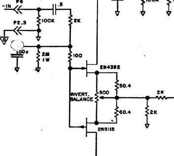

I know I can add the buffer. I am not sure if the decent buffers were available in 1976 ;)
Regarding noise, try it with very sensitive tweeter, add 10k to your low noise input.
The final commercial product, the ML-2 (yes I know it
was modified in several ways compared to the JC-3, but
anyway) a buffer was used. It´s production started 1977.

Hi
Well, you could have used the same J-Fet's JC used in the VAS stage as complementary Class A Buffer...
So, what value volume controls are you using in your preamp? 100 Ohm...
Ciao T
