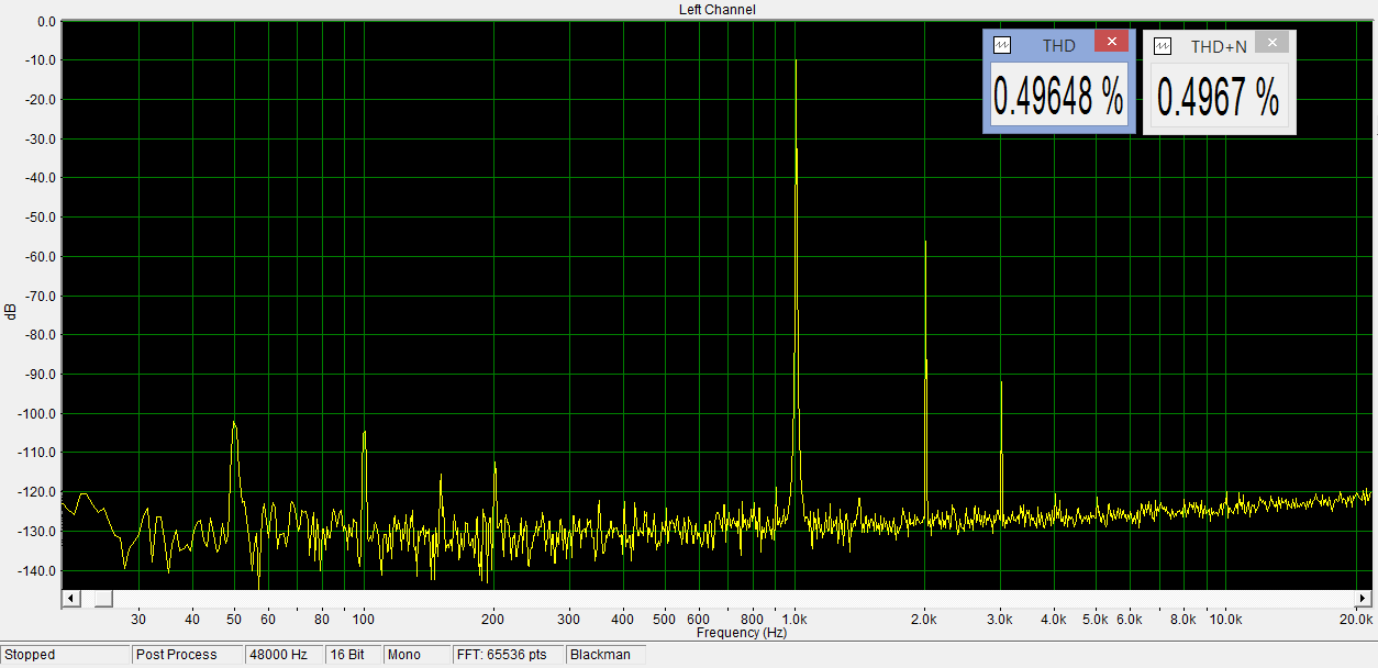

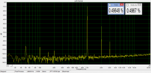

For you guys with extraordinary hearing abilities, I have two files, a wire vs. tube with distortion shown in
John Curl's Blowtorch preamplifier part III
The files are at http://pmacura.cz/ella.zip
Can you tell the difference by listening, can you tell which is which (wire, tube) by listening? Are you positive in DBT? I may start a thread on this.
File 2 is fatter and more compressed with some loss in vocal articulation and I can't hear the room as well so that is probably the added tube circuit. You used a mono source that is a tube recording from the get go so that means I had to go through it three times rather than once to get my bearings.
