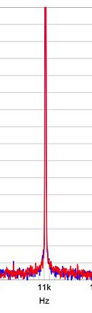

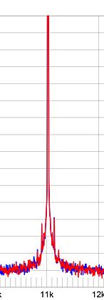

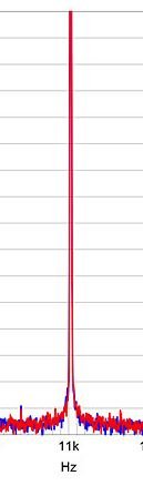

The tiny fattening of the fundamental on the jitter tests will have the jitter chasers up in arms though...
Not necessarily. Different DAC designs have different sensitivity to jitter. Unfortunately, today's high performance S-D DAC chips tend to be very sensitive. That is to say, sensitive in terms of the extent to which sound quality is affected by jitter.
the 19/20k IMD isn't amazing with a lot of spurs but like you say no real music produces that.
I mean you won't find me buying it or anything! The IMD is pretty ugly, replete with a combination of aliasing product and general messiness. It's also 90 db down, so my concerns are generally less. A chinese board mimicking the EVM of the nicer chips of the big players (the BS chips everyone uses.
The jitter looks more like mains injection, which itself is plenty problematic.

Exhibits A and B are close in jitter performance of EMM vs benchmark. The DAC that costs one tenth measures better. On a parameter I do not believe I can hear. But I could not spend 30k on something that is no demonstrably better other than in terms of 'look at my wad'.
