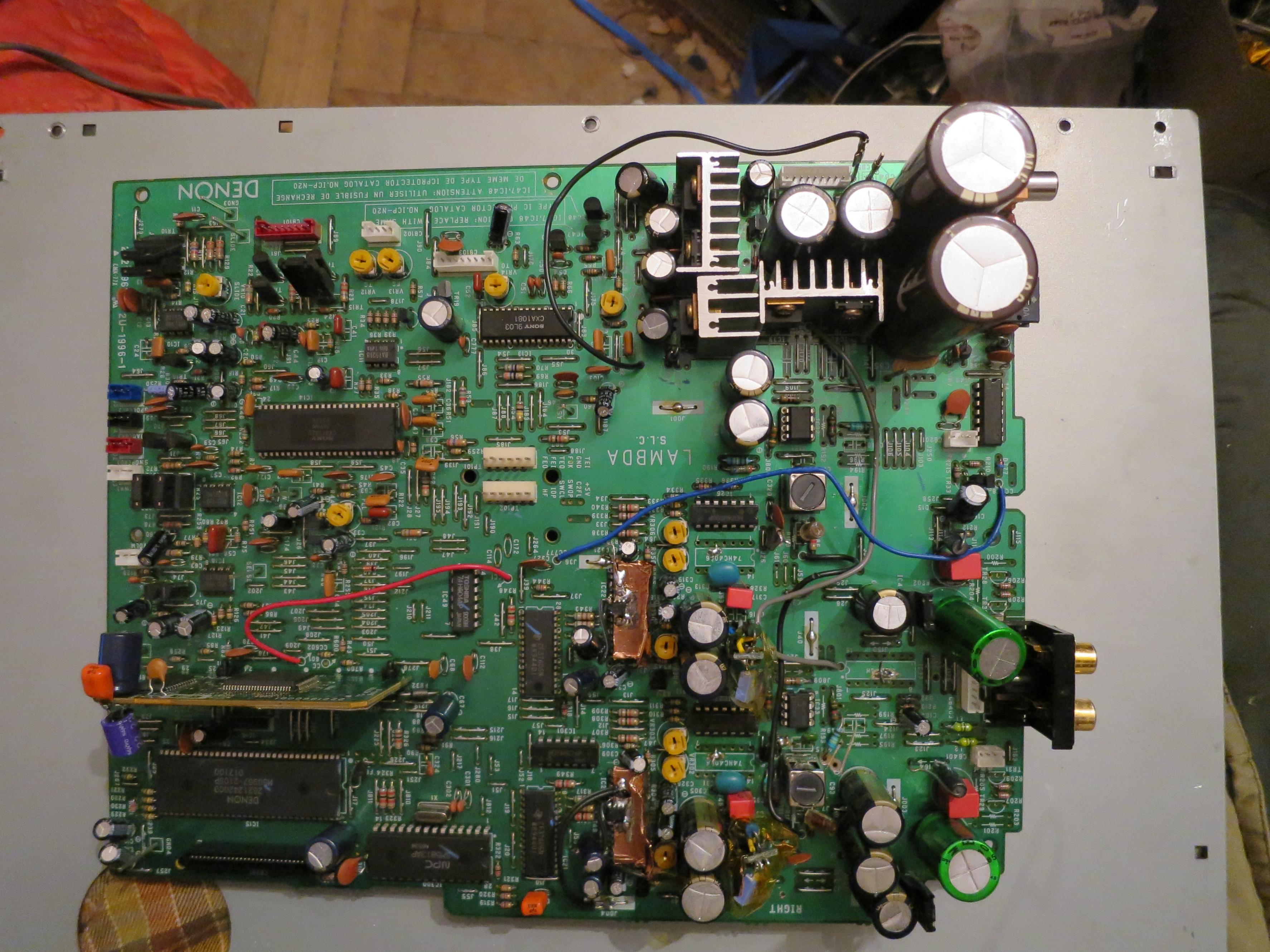

Has anyone else tried shielding their VLS IC's....DSP IC, DAC IC etc. These high speed, high density IC's produce a lot of EMI/RFI. Not enough to escape the steel chassis but within a mixed signal pcb, I thought I would shield them.
I put some 3M Scotch copper foil tape with glue on one side on the tops of these noise generators. Then a stiff short grounding wire soldered to the shield.
DigiKey has the fix you seek, today, ready for sale and on the shelf. Part numbers 903-1057-1-ND and 903-1020-ND . Easy.
I used snail copper foil tape (gardening irem) on my dacs , connected it to ground used for both 78l05 regulators on top of it and for the dac itself.It actually saved one of my dacs the other day as i soldered the iout to v- by accident , the foil got hot dissipating the heat so i had the time to turn it off.Has anyone else tried shielding their VLS IC's....DSP IC, DAC IC etc. These high speed, high density IC's produce a lot of EMI/RFI. Not enough to escape the steel chassis but within a mixed signal pcb, I thought I would shield them.
