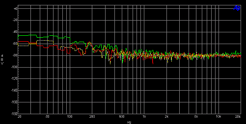

Just checked, BF862 has very bad 1/f noise in reality. 80nV/rt.Hz cited at 10 Hz.
green is BF862

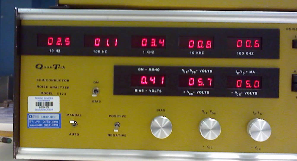

Dimitri, an associate of mine also measured the BF862 and found it fairly quiet. He used a calibrated Quan-Tech and I trust his results, also. It may be batch dependent. That is something that I worried about, initally. The manufacturer does NOT promise or even rate low frequency noise on the spec sheet.

Dimitri your plots only go down to 20Hz and the last 1/2 a decade is flat. You really need a Quantec or something with more spectral resolution at the low end.
John is right, there is no guarantee but this is like the 2N4401 a designer "secret". A large portion of the population is 2.5 nV at 10Hz (see picture) you just need to sort (and they are cheap). The general feeling is that even the LSK170's fail noise for some batches.
EDIT - note our Quan-Tech is leaking some of the 1kHz calibration tone during the measurement, I'm probably the only person who knows this.
