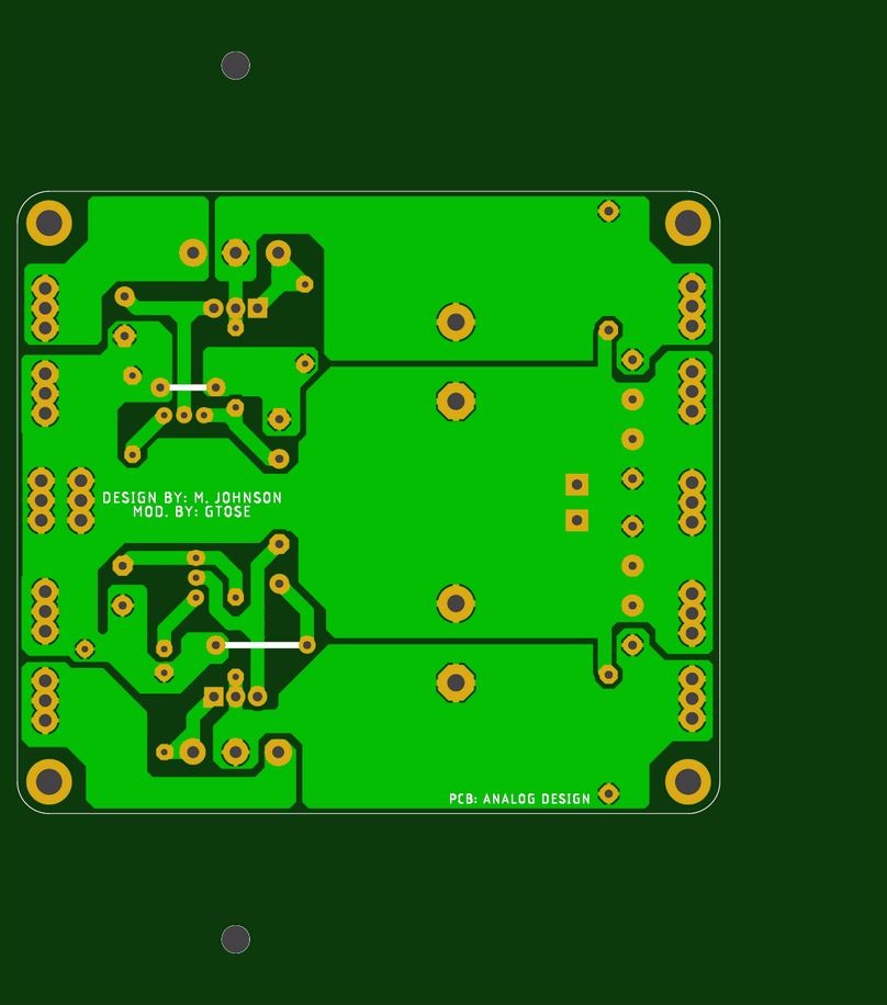

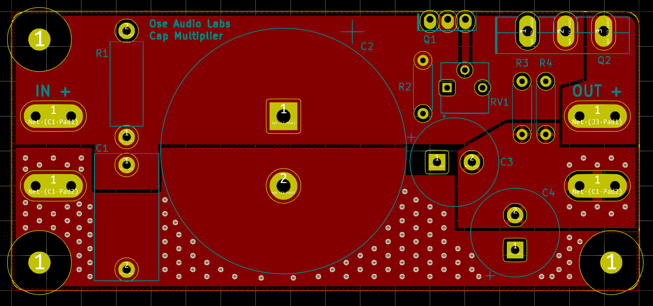

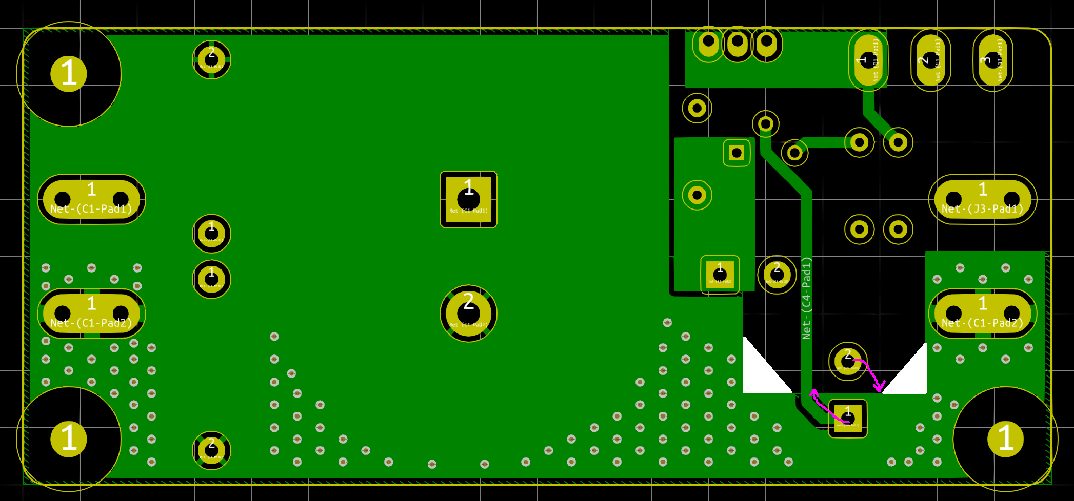

Prasi, your mastery of PCB layout has inspired v2 of my design. I have attempted to move "all the action" to the output ground connection.
The grounds of C3, C4, R3, R4 have been moved to their own ground plane. The grounds of C1, C2, R1 are run to the output in their own planes (top and bottom). The two only connect at the output faston and surrounding vias.
What do you think?
What do you think?

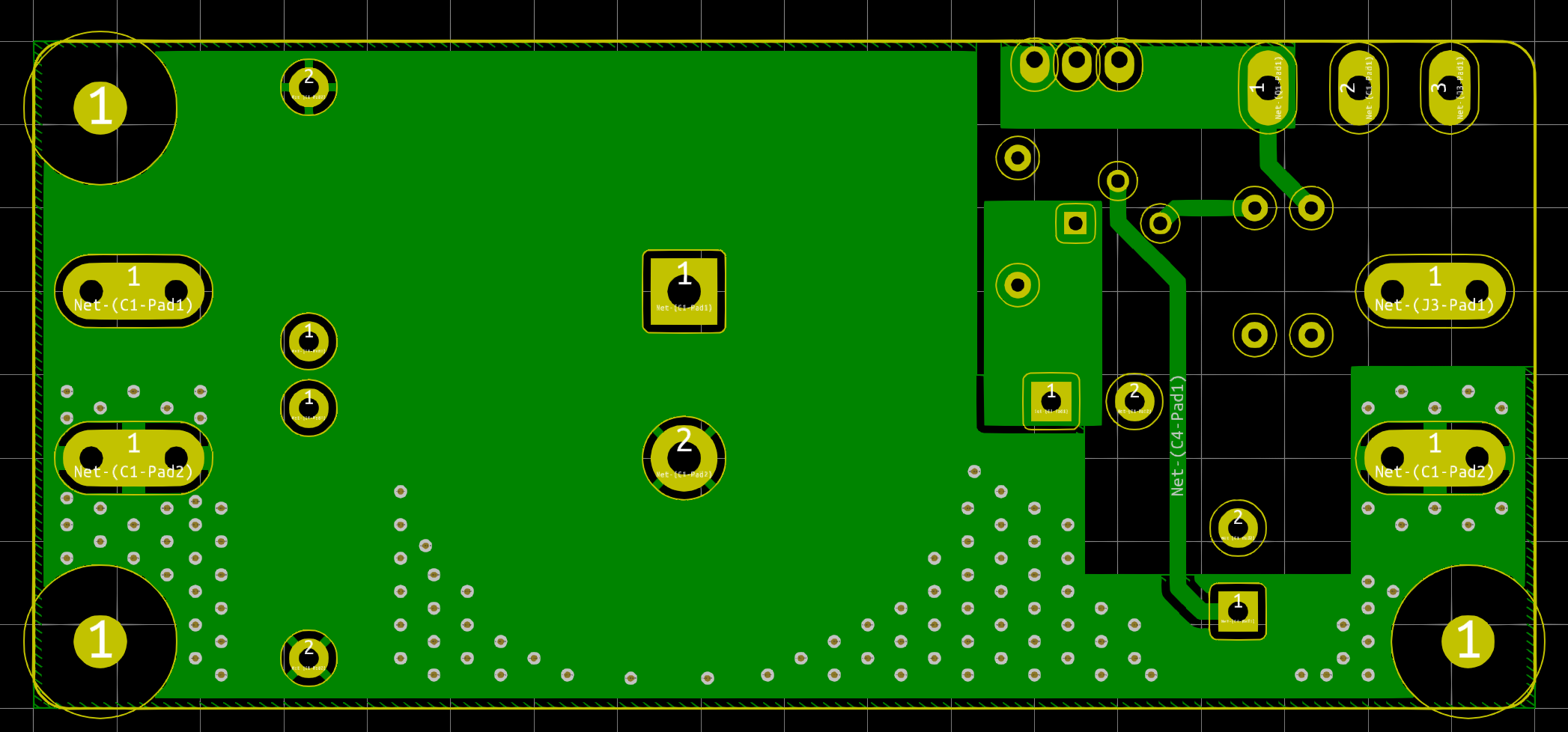

gtose, if you decided to rotate capacitor C4 by 90 degrees, clockwise, you could get much better continuity on the green plane. The green signal track between C4 and the potentiometer, would not interfere with the green plane as much.
Also you might consider adding the two white triangles shown below, onto the green layer.

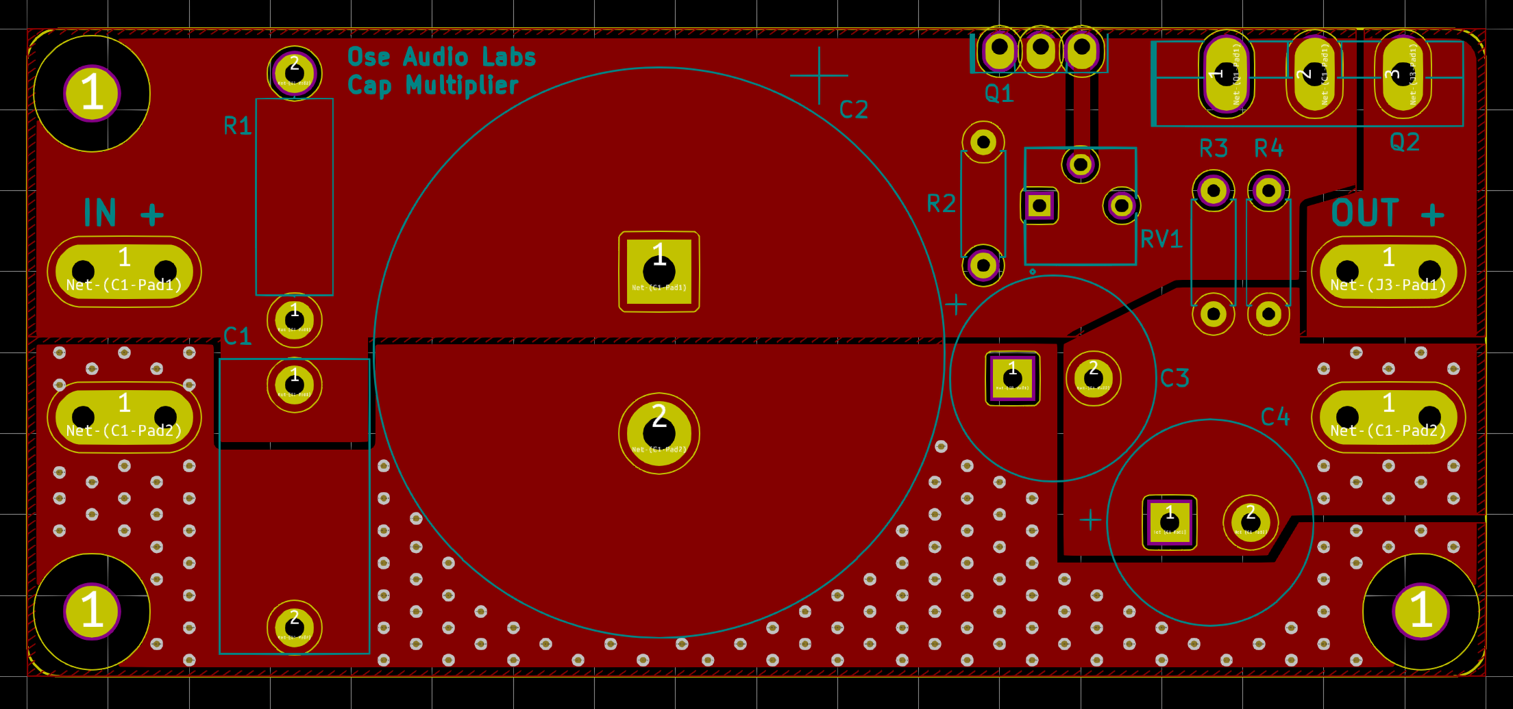

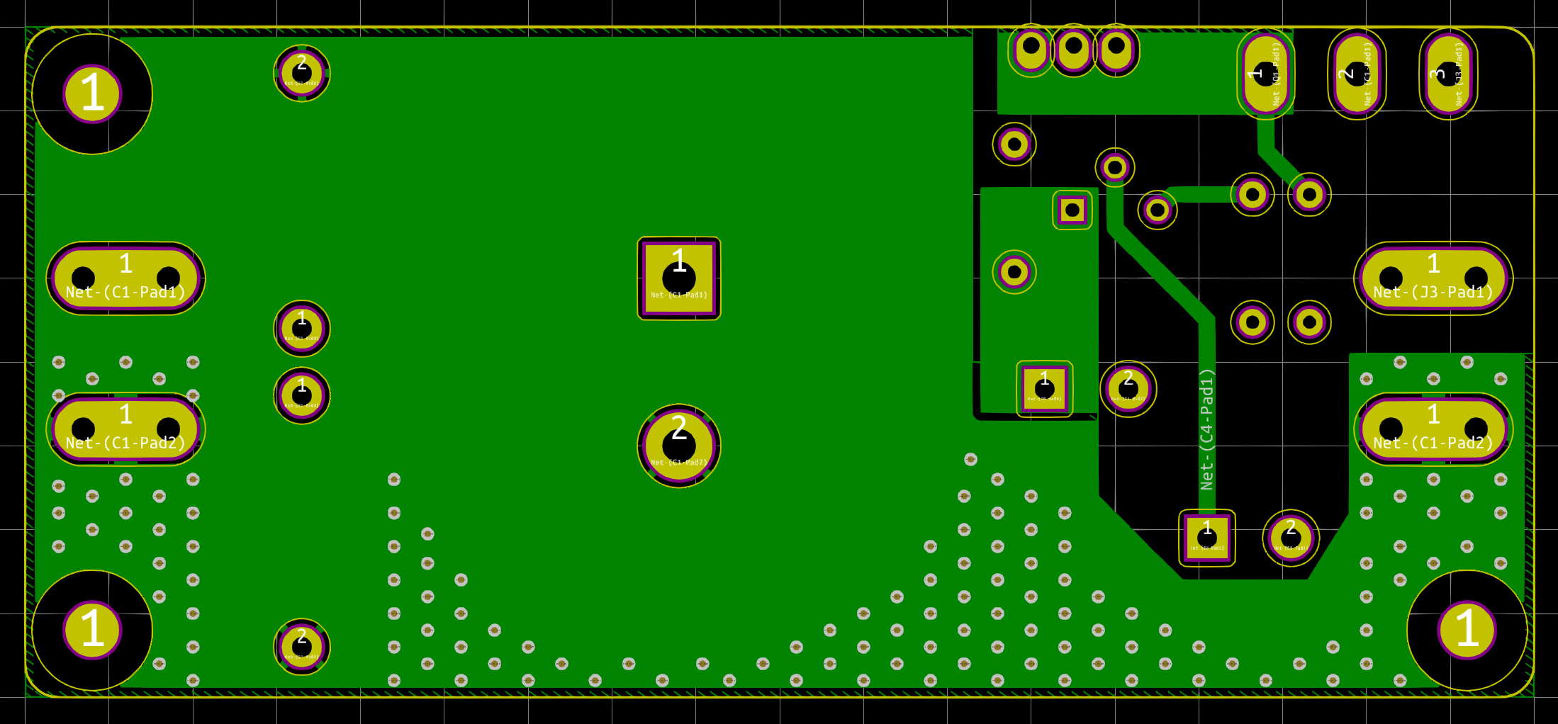

Mark, great suggestion! I've implemented this in version 3 below. I've also reduced the keepout size around the m3 mounting holes to get more width on the input ground plane on the top layer.

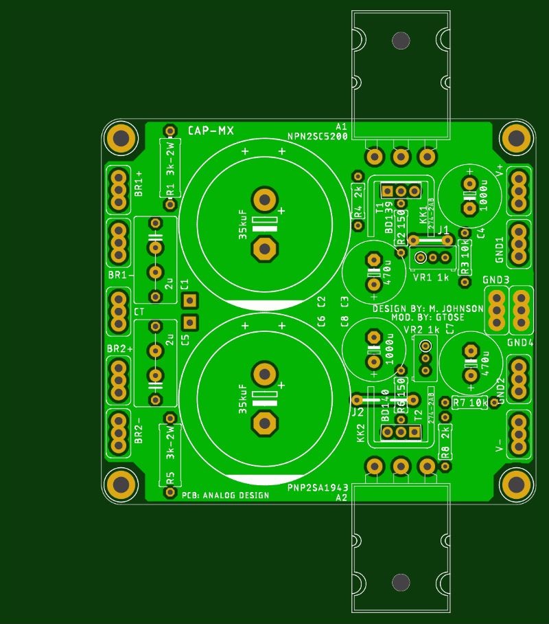

Yes, its a 15mm pitch alright, plus now I have put some options for 5mm and 10mm just in case someone wants to use something else.
you can order boards yourself. attached are the gerbs and stuffing guide , also pdfs in case someone wants to etch at home.
Let me know if you have any problems with boardhouse with these gerbers, I can clarify / use older method. I have now moved over to eagle 9.0.0, pcbway didnt like those 9.0.0 gerbers initially. Now its settled with them.
Top plane is a ground plane thats only connected at output.
regards
Prasi
edit: logos are on the bottom silk, so don't affect the functionality or beauty of top silk![]()
The gerber zip file in the quoted post above is missing the drill file. Sorry for the omission. It was a mistake. I just came to know about this from xrk.
The correct gerbers are attached herewith. The diy pdf files in the quoted post are ok.
