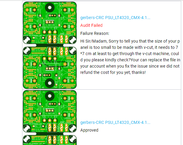

Seems jlcpcb needs the panels to be atleast 7cm x 7cm for it to process v-score . So i have removed the v-score layer in the attached gerbers.
one could manually score it and separate the pcbs if needed.
When i replaced the gerbers , it got approved immediately. see attached image.
Hi Prasi
This is strange because I sent your file (91mm x 56mm) to the same PCB house and there was no issue during the review, production was completed today. Have you tried twice?
BR
Eric

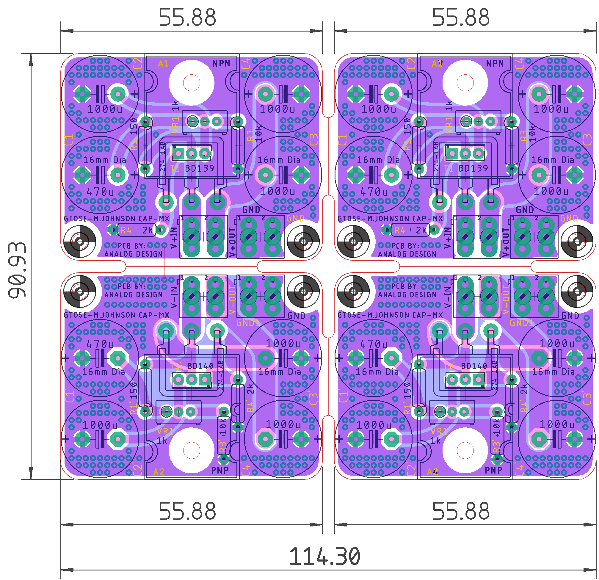

Prasi, what about laying out another pair horizontally, separated with a v-score. The PCB price at JLC only goes up by $4 or so for 100x120mm and then you get double the boards and reach the minimum size for v-scoring.
Hello gtose,
Here is 2 side by side layout with v-scoring all around.
regards
Prasi

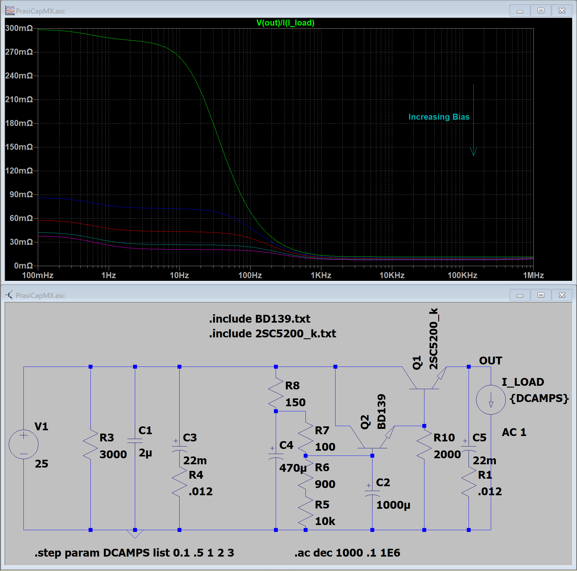

It's pretty instructive to calculate the output impedance (vs frequency) of the two alternatives. ESR and ESL of the Big Old Bohunker Capacitor Bank prevent it from delivering all of the goodness that an ideal perfect "university chalkboard capacitor" would give you, in theory. While the "Capacitance Multiplier" benefits tremendously from high bias Class-A downstream circuits, and from modern power transistors with high fT. Crank the algebra, or run the sim. It'll be fun.

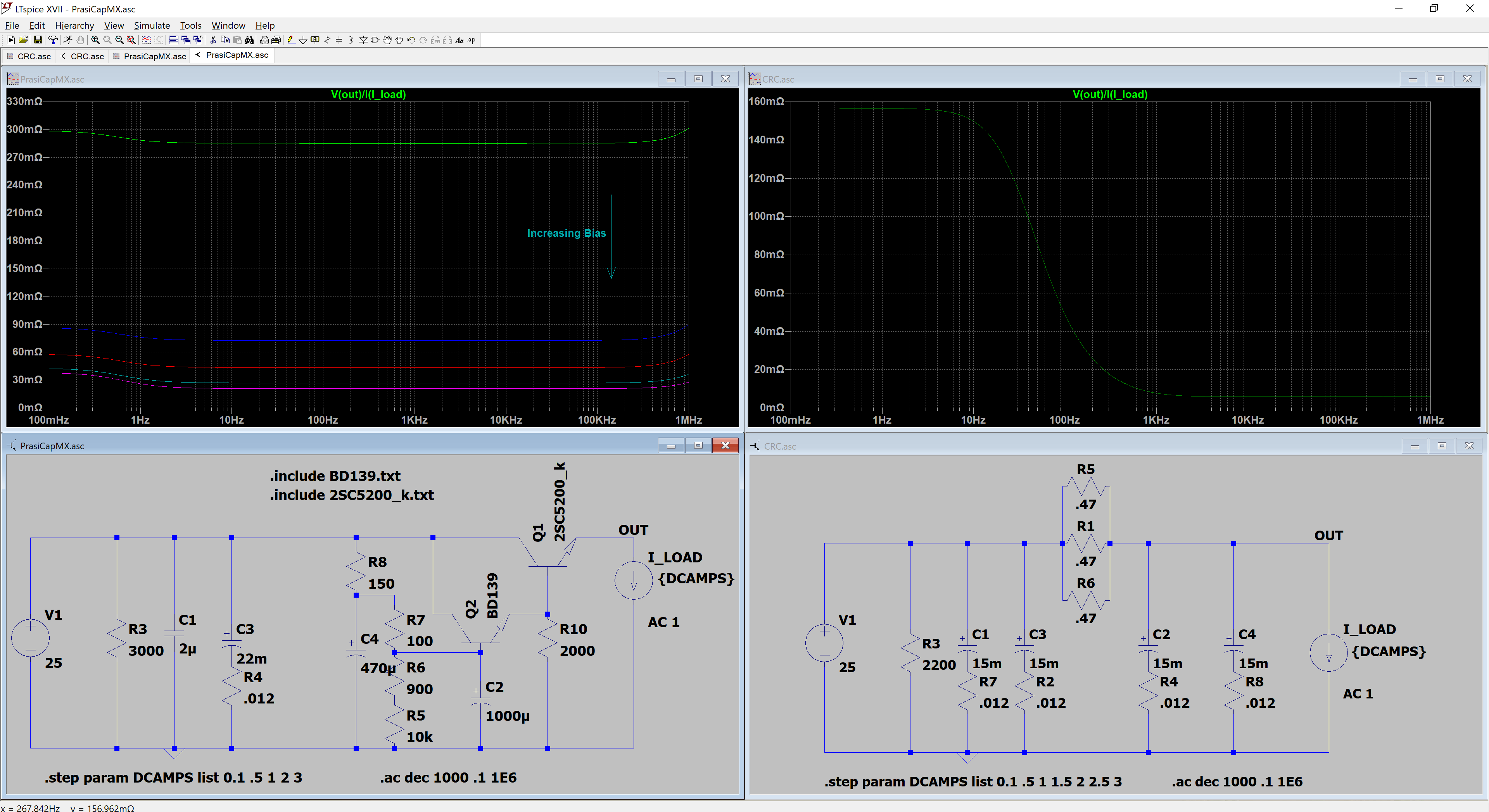

I was curious how the output impedance of this popular CapMX (based on the schematic in #477) compared to the standard PSU used in FirstWatt designs.
Based on the Mark Johnson Happiness Threshold™, the CapMx does great at normal class A power amplifier bias levels (see first attached photo).
If class A output stage is push-pull, let X = 2 * output stage bias current (in amps)
Then I would be happy, personally, if my power supply's output impedance remained below Z ohms, for all frequencies from 10 Hz to 100 kHz. The number Z is calculated thus:
  • Z = 0.5 / X
Example 1: A class-A amplifier with a constant current source pullup in its output stage, runs at 3.5 amperes of bias. Then Z = 0.5 / 3.5 = 0.14 ohms
Example 2: A class-A amplifier with a push pull output stage, runs at 2.0 amperes of bias. Then Z = 0.5 / 4 = 0.12 ohms.
But of course, my preferences and "happiness threshold" might be different from yours.
Notably, the CapMx far outperforms the CRC below 100 Hz, where the CRC does not meet the Happiness Threshold. Adding massive amounts of capacitance only shifts the slope slightly to the left: 200mF gets about .12 Ohm at 10 Hz.
Adding another cap on the output of the CapMx seems to offer marginal improvement at higher frequencies, so long as the bias current is reasonable (see second attached photo).
