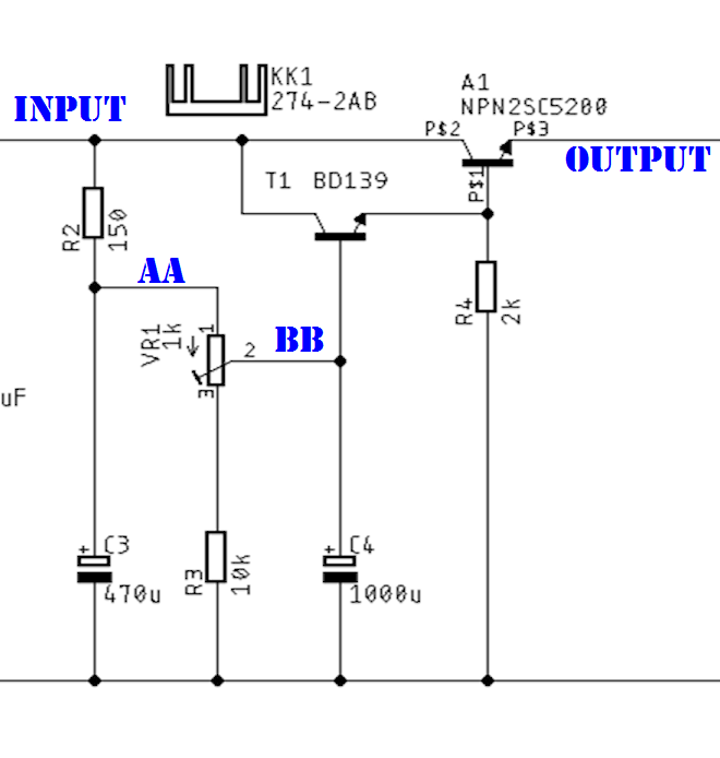

Fran, the Cap Mx boards you have take DC input and you say you need to drop from 43V DC to 35V DC. As pointed out the pots on the Cap Mx boards are for balancing the +/– output rails. You will not be able to drop down to 35 or 38V. I suggest using DC DC step down converters. They are cheap and work very well to balance the +/- rails even before you feed the Cap Mx. Just get ones that can handle sufficient current.I'm using an old but beefy transformer for a build, (37VAC) and I have about 43V DC at the bottom of the range. I need to get to about 35-38 V if at all possible for the amp circuit that its to power.
The output is simply the voltage at node BB, minus two emitter follower drops.
To decrease the output voltage, either change the emitter follower drops (difficult), or change the voltage at node BB (easy). Increasing the resistance of R2 will decrease the voltage at node BB. Decreasing R3 will do the same thing. Personally I prefer increasing R2, because it lowers the lowpass corner frequency set by R2 and C3.
The trimmer pot intentionally has a small adjustment range, and is only used for final tuning. Its original purpose was to let you tweak the circuit for minimum possible in-to-out drop (i.e. the maximum possible output voltage) with little or no output ripple. Connect the heaviest possible load, monitor the output with an oscilloscope (AC coupling), and dial the output voltage upwards very slooooowly. When ripple just barely appears, dial back a teeny bit, then stop.

Many thanks for your answers on this. I installed a pot for R2/R6 on that schematic this evening, and adjusted to get the voltage range I needed. I took back out the pot and put back in a fixed resistor of the right value then. This gives me about 4V adjustment either way and I can hold the voltage where I need it.

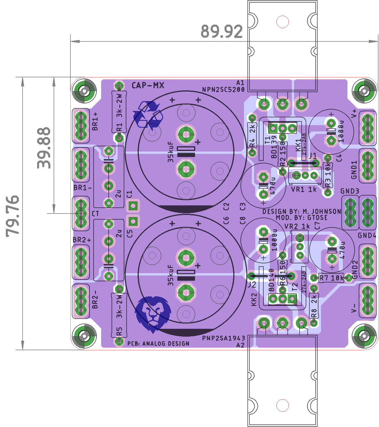

diyAudio member Prasi did all the work, converting a quick and dirty thread-message schematic I sketched off-handed, into a very nice PCB layout. BTW if you own a curve tracer that'll go up to 1 ampere, you can choose transistors that will give much better ripple attenuation in Cap Multipliers [both darlington and Sziklai/CFP]. The trick is to find power devices with acceptable Safe Operating Area limits, that also have the very highest Early Voltage of all the ones you tested. It'll cost you $40 to buy plenty of different candidate parts to test, and then another $3-4 to buy some more of the winner.

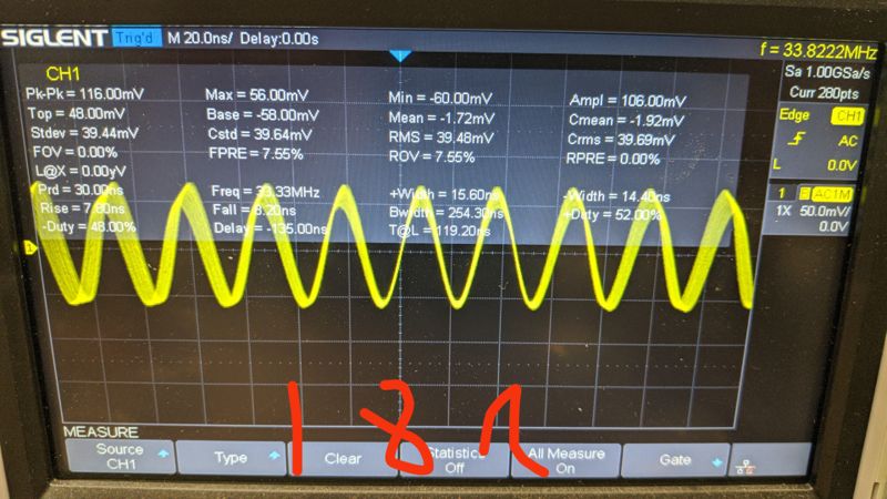

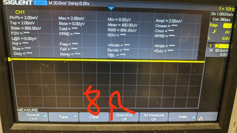

Mmmm. So i did another experiment there now. Testing the same cap-mx with both 8R load and 18R load (same load on both rails), representing 3.5A/1.5A or thereabouts. I get very little noise at 3.5A, but quite a bit at 1.5A. What am I doing wrong? This doesn't look like ripple to me, but some other noise or oscillation up at 33mHz?
The two scope shots are with the same settings, excuse my bad doodling, and yes there are extra stray wires used to hook up the extra resistors to give 18R.

Anyone able to hazard a guess? I hope to get back at this in the coming days, will test a second build to see if I can replicate what I'm seeing.Mmmm. So i did another experiment there now. Testing the same cap-mx with both 8R load and 18R load (same load on both rails), representing 3.5A/1.5A or thereabouts. I get very little noise at 3.5A, but quite a bit at 1.5A. What am I doing wrong? This doesn't look like ripple to me, but some other noise or oscillation up at 33mHz?

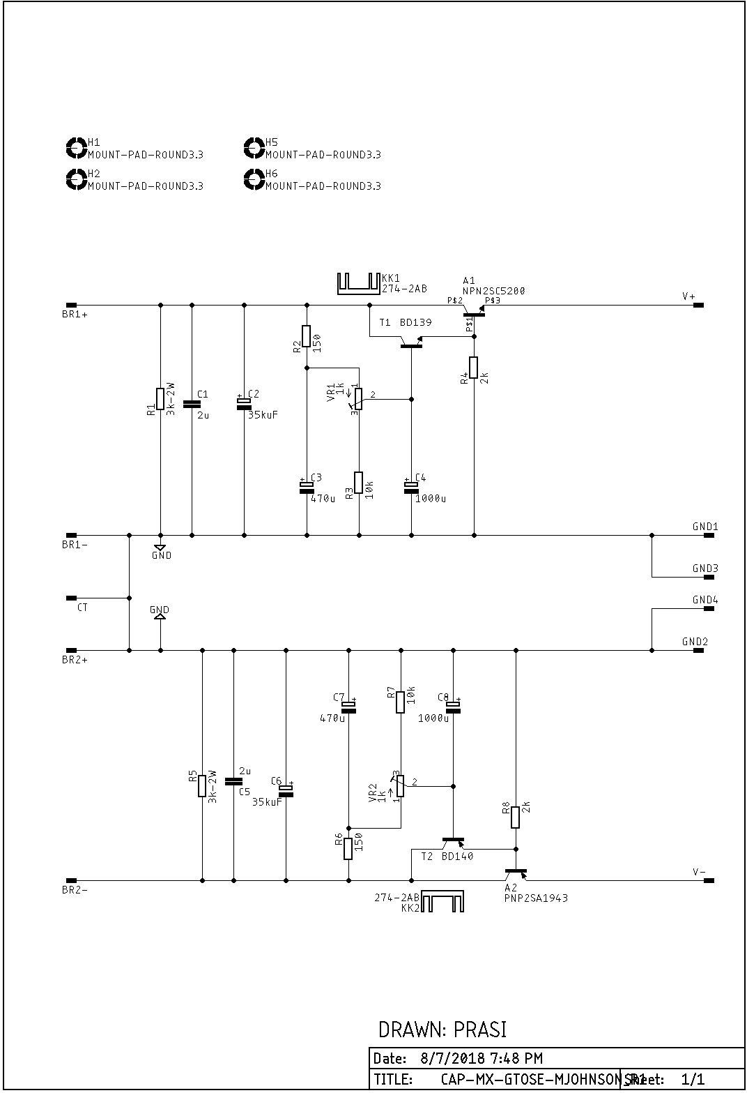

The schematic is attached, and the board is shown below - its the one linked in post 497. I don't have pics of the setup - but it is rough, test bench stuff. Transformer sitting on the bench, feeding a 25A bridge rectifier, then into the cap-mx board which is mounted on a heatsink, and then from the outputs to a resistive 8R/18R resistor load using jumpers with crocodile clips. So very much a quick test setup.
