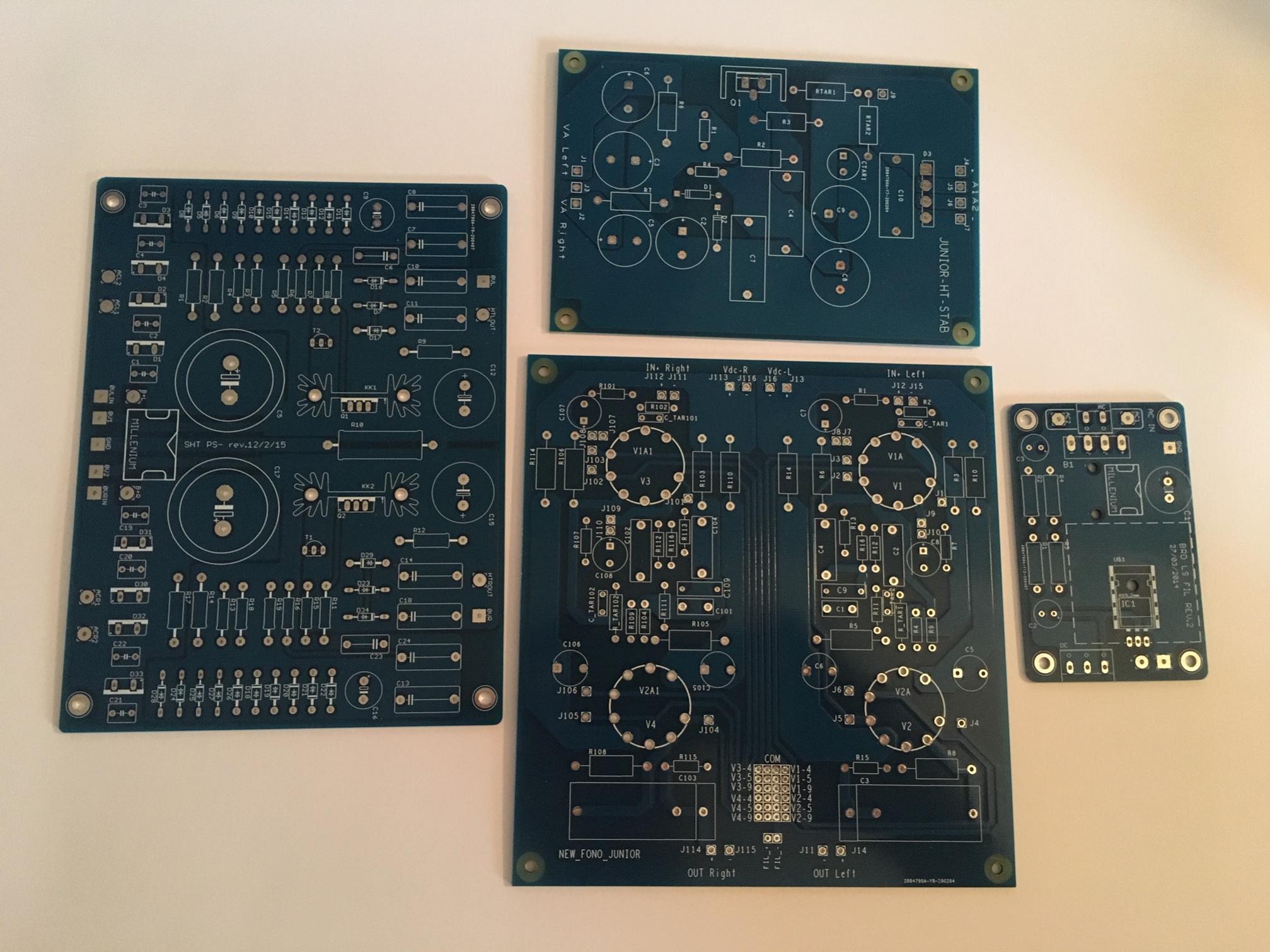

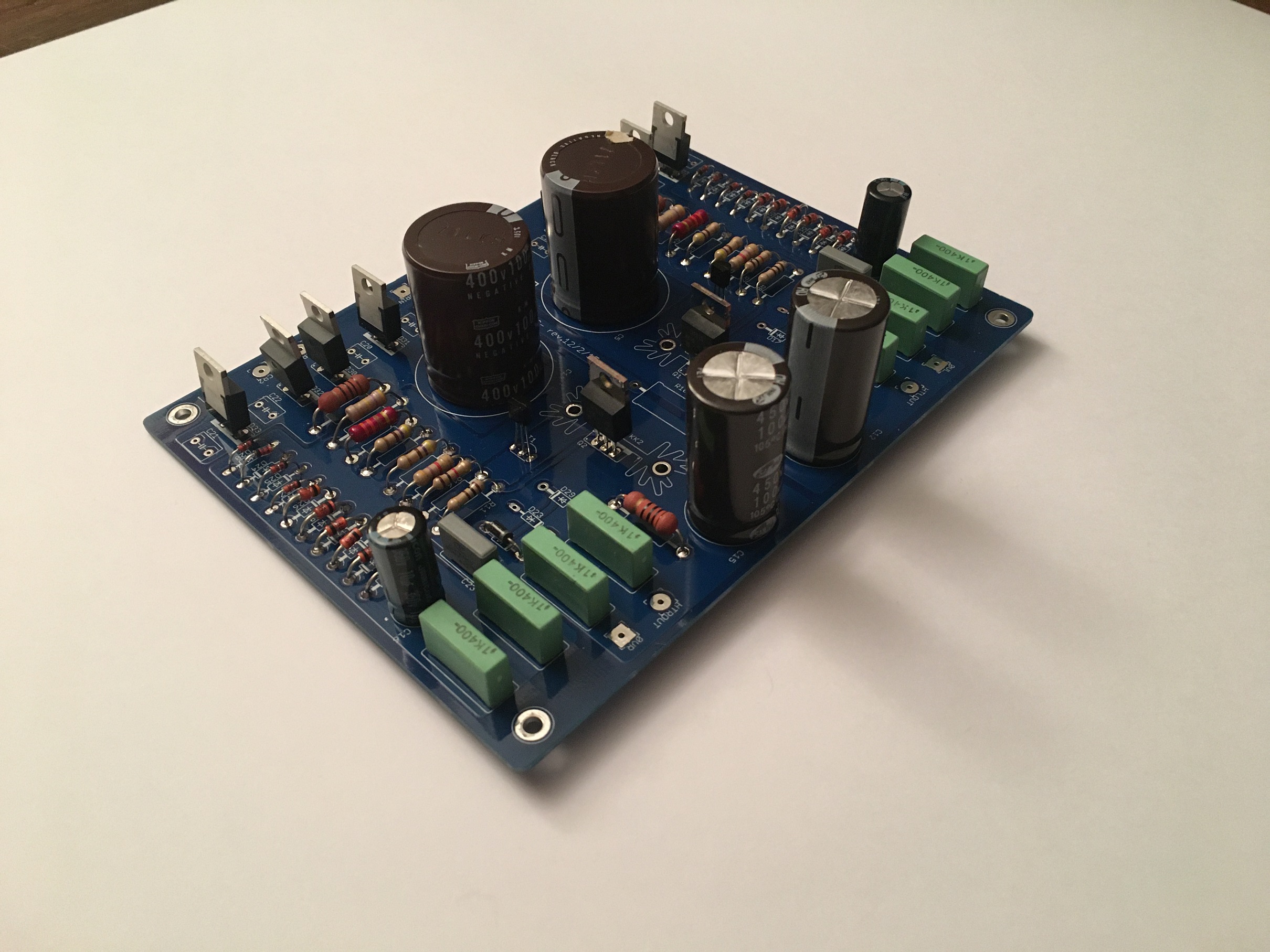

with the nr. 418 of Audioreview in Italy I have presented a phono tube circuit with the pcb.
In photo the boards completely mounted.
It is a passive riaa.

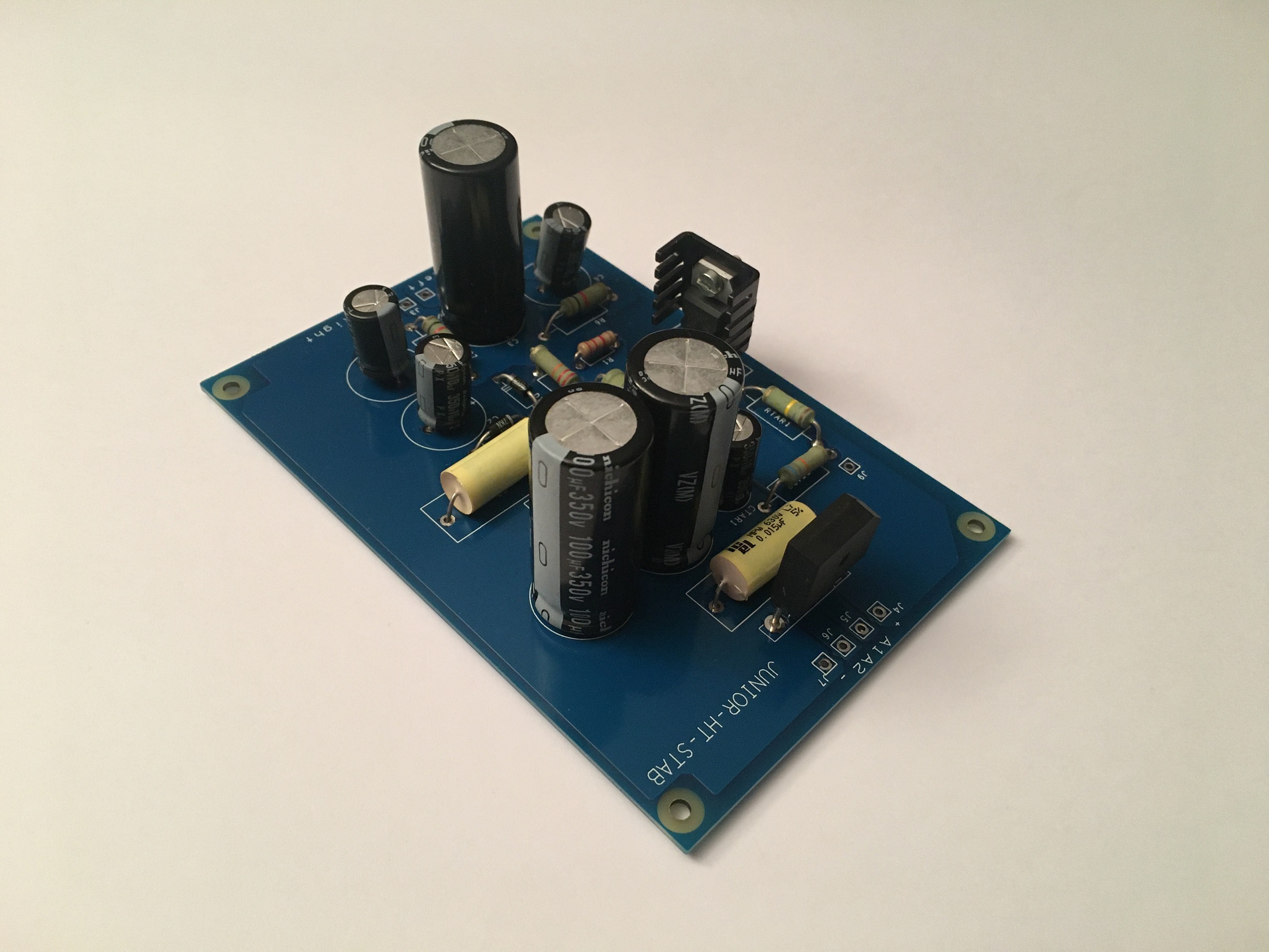

In the second photo there is a board for HT regulated with fet; it is dual mono.
In addition there is an other HT regulated but with a single Fet. This is a less complicate otpion.
Last photo is a pcb for supply for filament with a LM350T.
Walter

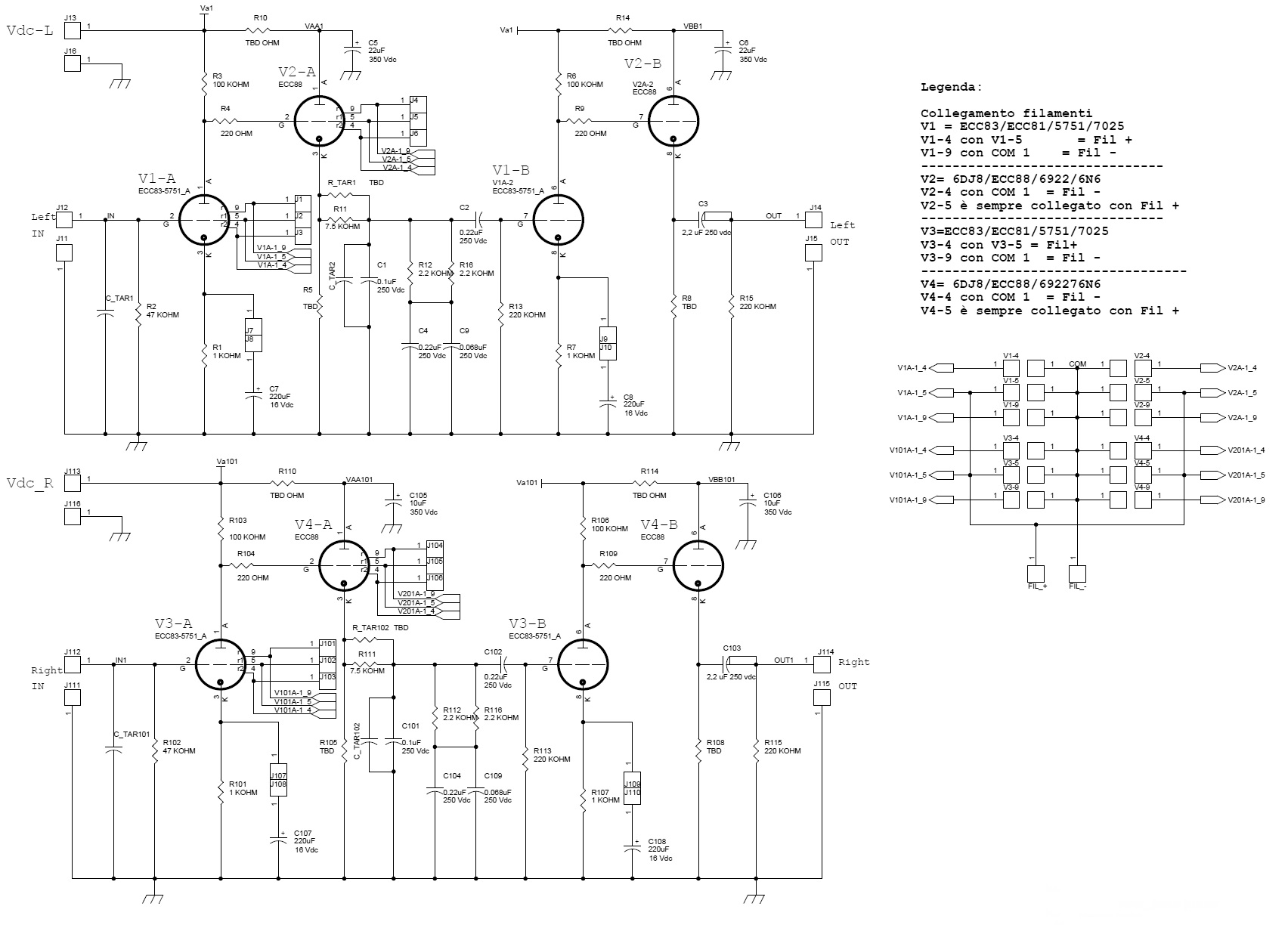

In attach the circuit.
Each gain stage has a CF.
Two gain stage, in the middle the riaa circuit.

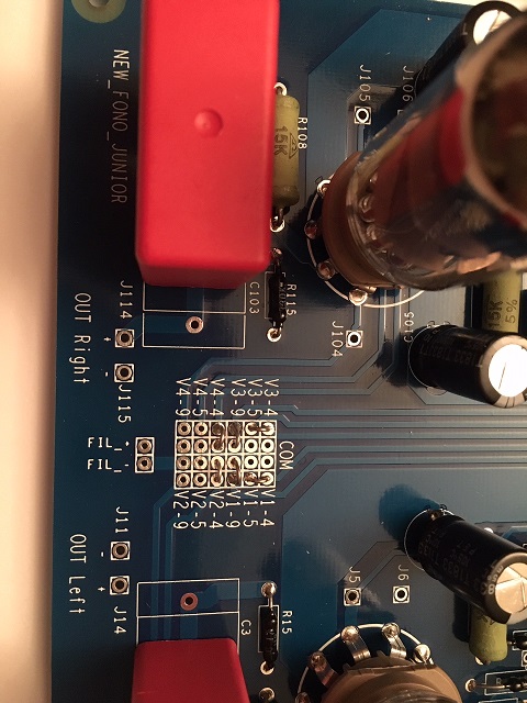

The board ( on the right side there is a legend, in italian) has the filament configurable to use the 12xxx or 6DJ8/6N6/PCC88/6H30/6922/ECC88 simply connecting few jumpers.
In the photo the details of the matrix.

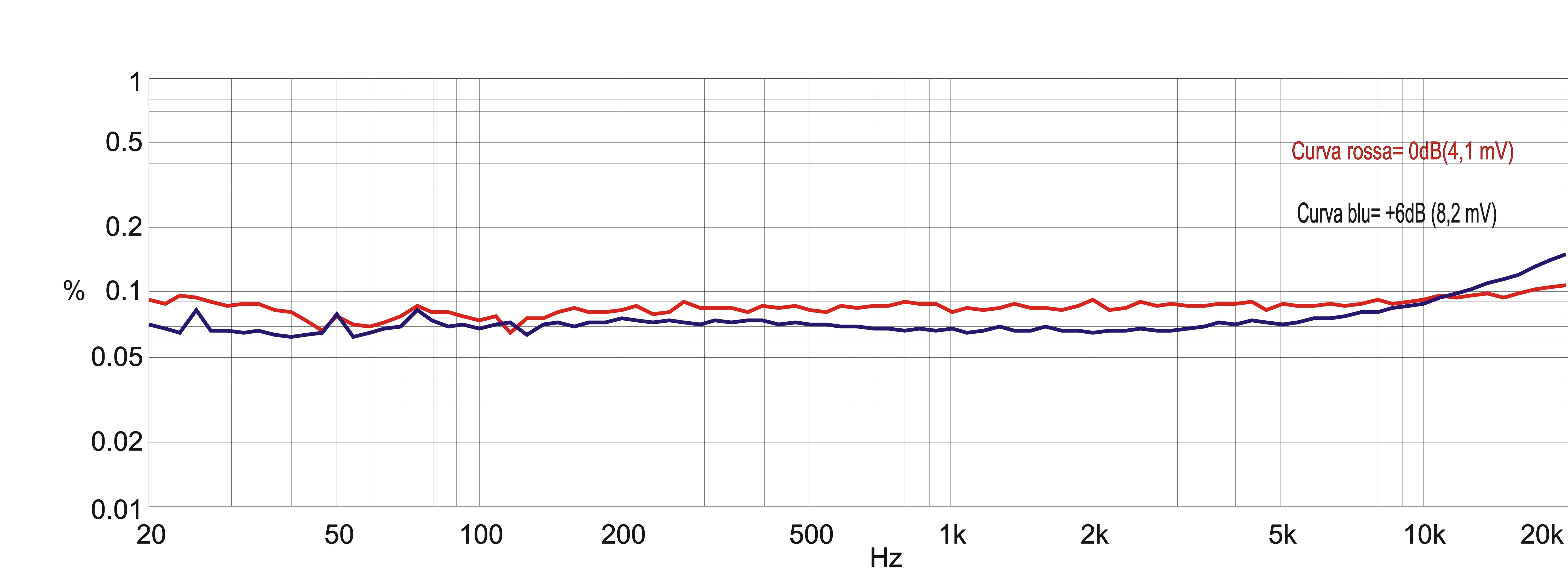

The other test is the THD vs Freq at 4,1mV and 8,2 mv (+ 6dB)
It is a good prefromance.

Listen, I use the standard procedure that Audioreview is using
And the resuts are published and are ripetitive; in some case I got a better results with differente brand of same type ( but also same tube, same brand), as you know you can get few dB of difference.
For MM stage, 5mV in input then short the input with 600 ohm and read the output.
With 5 mV in this phono I have 610 mV out (41,7 dB of gain)
-78 dB are 7.943 times less than 610 mV = 0,07 mv ( residual in ouput)
0,07 mV divided by 122 = 0,5 uV this is the noise voltage reffered to the input.
For a 83 is not bad.
This was done with AP One and AP Two for check
note: for MC stage the input voltage is 0,5 mV as standard and the measurement on output (no signal) is done with the input shorted.
Walter

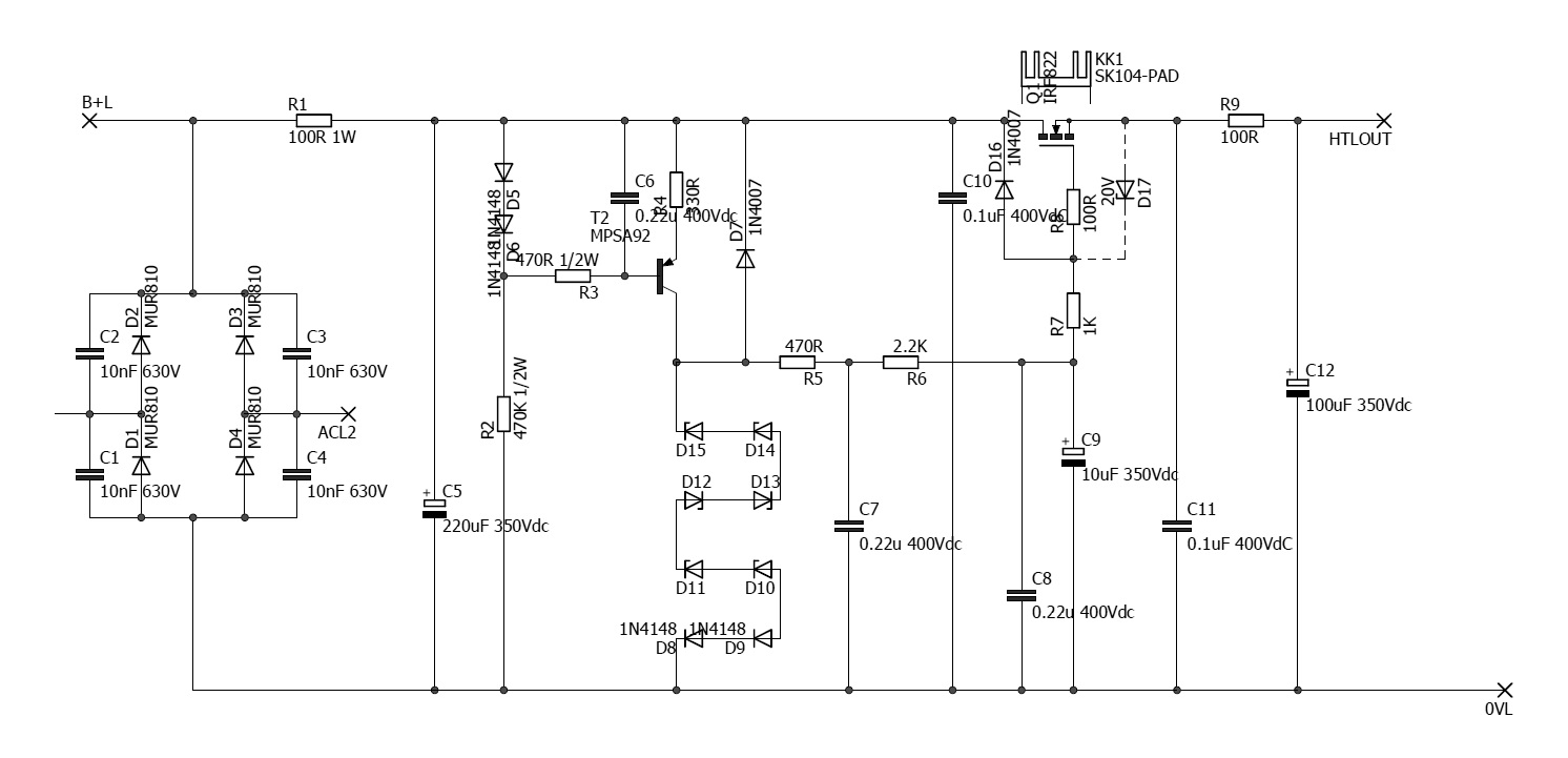

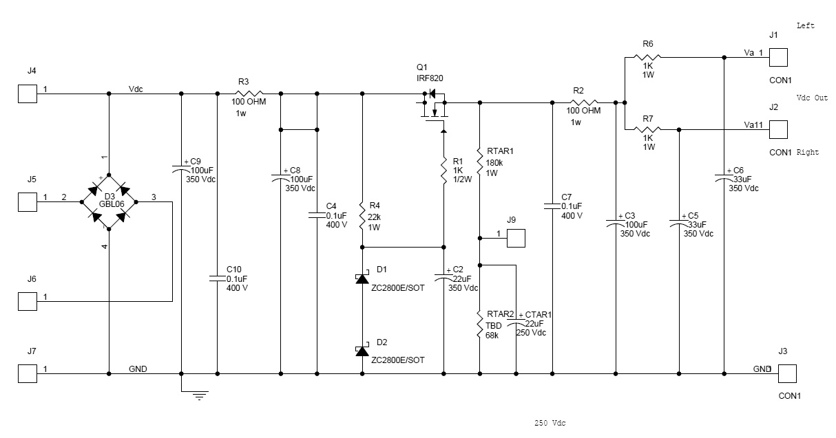

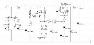

In attach the schematic of the two version of the regulated power supply.
For the dual mono one channel is shown.
The ac in input is 200 volt
For the dc the range is 200-240 vdc. Nominal 220-215 vdc
Walter

Finally I have the set of PCB.
Some are available .
1,6 mm of thick; the copper is 70um.
Two type of HT stabilized board, one dual mono or single.
If interested please send message.
Walter
