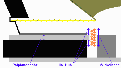

Ya, there is always the question if the parameters are true.
Mostly the plus minus travel of the cone can not be easily found out.
One method is tearing one driver apart and measuring the thickness of the pole plate and the winding depth of the voice coil. The other is making distortion measurements with different levels of loudness which is not invasive.
The only hint that the parameters as such function is the calculation of parameters in WinISD. If these do not work - WinISD calculates different parameters -if you put that function on - than you have to measure Thiele Small parameters by yourself.
Mr Herget from Germany is discussing cone travel on his website.
Sorry its in german but maybe some translator can help you out:
HTH Hub-Info
Image is from his website.

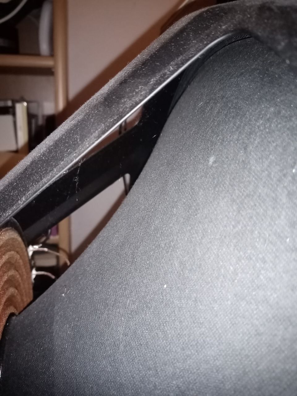

I really like the Mivoc WS 1865 C4 because the diaphragm is special. Its the first time I saw that a bass driver has not only a Nawi diaphragm but a diaphragm formed like an "S" - like a "double Nawi". Small detail: The edge of the cone has a 90 degree L - type form of approximately 1mm.
And I chose this driver because it is lightweight - so I managed to build a 150 liter enclosure with two 18 inch drivers which I can still carry without help. This is impossible with heavy drivers with bigger magnets.

Interesting! Can't recall anything like that. That said, based on some Altec measurements of straight Vs curvilinear diaphragms I assume its polar response won't be much different than a piston's.

Here you can see the special double Nawi diaphragm of the Mivoc WS-1865 C4 18 inch bass driver. The curvature of the membrane is "S" - type. At the end of the diaphragm towards the surrounding it makes a second bending facing to the front. This helps against radial break up of the diaphragm on the edge of the paper cone.

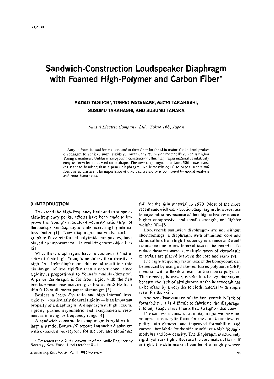

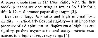

I would greatly appreciate if someone could post this article from the AES library, I have no access to it:
https://aes2.org/publications/elibrary-page/?id=5236
Sandwich-Construction Loudspeaker Diaphragm with Foamed High-Polymer and Carbon Fiber​
Acrylic foam is used for the core and carbon fiber for the skin material of a loudspeaker diaphragm to achieve more rigidity, lower density, easier formability, and a higher Young`s modulus. Unlike a honeycomb construction, this diaphragm material is relatively easy to form into a curved cone shape. The new diaphragm is at least 300 times more resistant to bending than a paper diaphragm, while nearly equal to paper in internal loss characteristics. The importance of diaphragm rigidity is confirmed by modal analysis and tone-burst tests.

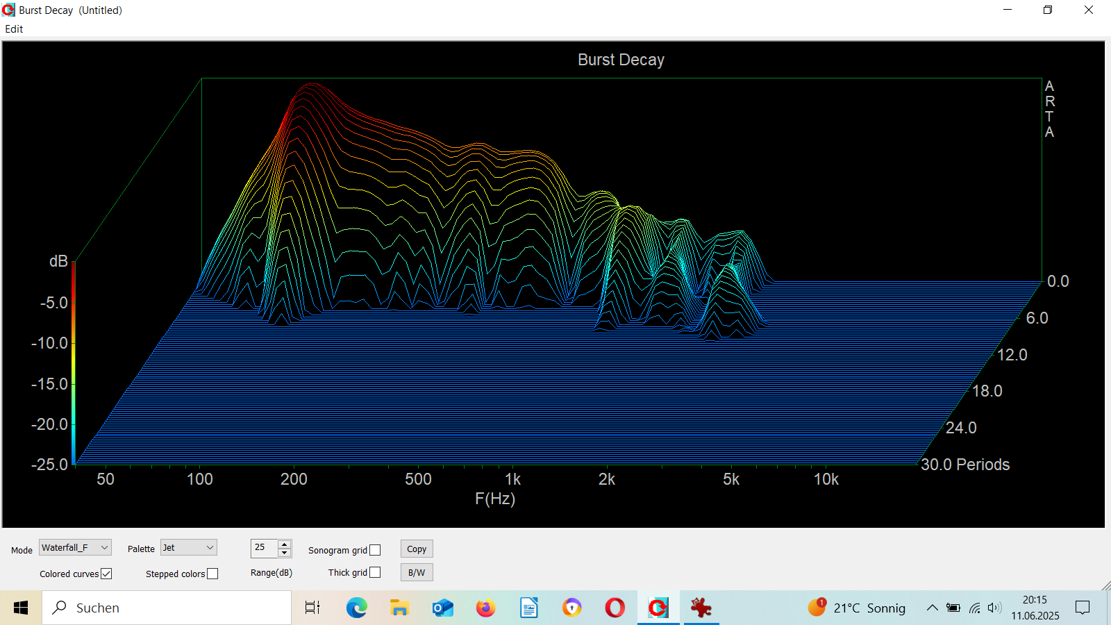

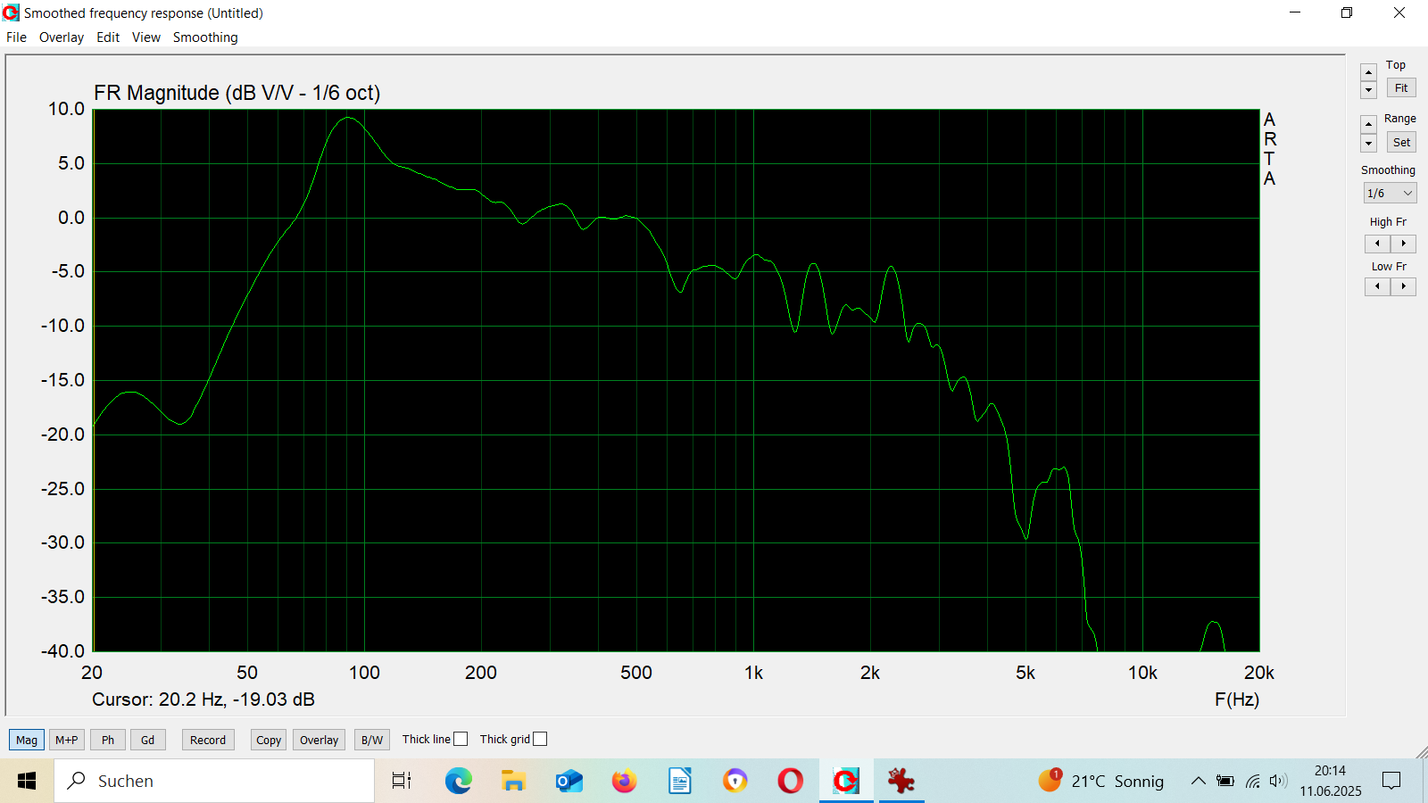

measured the Mivoc bass driver in its box (150 liters for two drivers).
These are nearfield measurements (5cm close to the loudspeaker cone)
Nice burst decay for an 18 inch in the mids.
Nice to see the efficiency gain above 70 hz due to the small enclosure.
Below 70hz there is some heavy linearization used but electrically the gain above 70hz puts the current in the voice coil in this important musical region down (after linearization).
