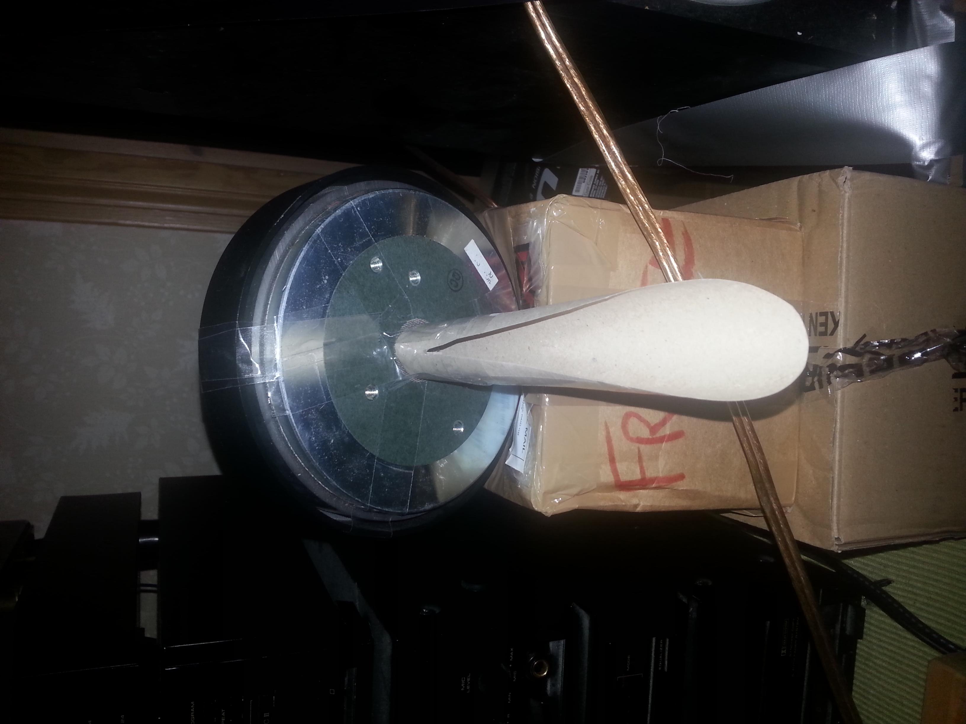

I have use a paper version, I am stunned how wide it go in room, I make picture tomorrow to get a idea.
now I go sleep en dream of a nice wife.
vrg kees
you will have to turn your head I cannot make the picture rotate. Tube at ear level three sided equal sided triangle stage and image are excellent. Best regards Moray James.

a little K-tube approximately the same size as the Transylvania tube, has probably a bit more than 100dB sensitivity from 2KHz up as it seems a bit hot with a 99dB woofer. If setting on top of a speaker, then I think a baffle at the compression driver's plane may help offset baffle step fold-backs and low end droop. Get some cardboard and experiment with baffle size.
I tried Karlson horn for the HF units. And I can say that sounds very good.
No directvity, no hard jet. Very good dispersion, much easy to listen for long sessions.
On impedance measurements acts like horn load. I am very satisfied with this for my opinion, significant design.
