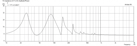

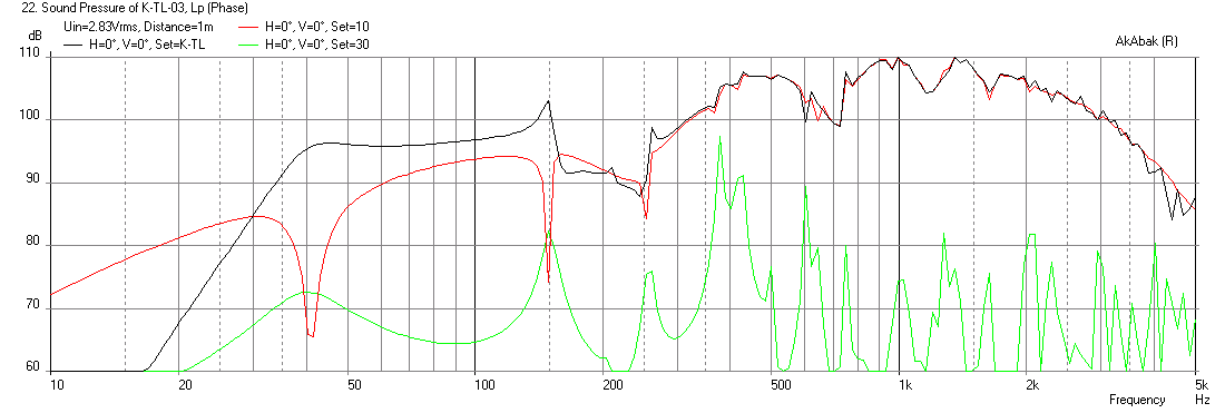

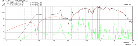

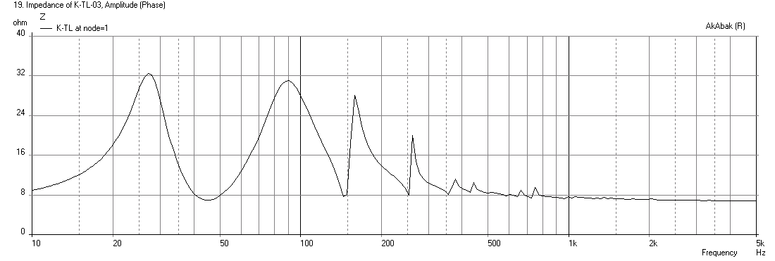

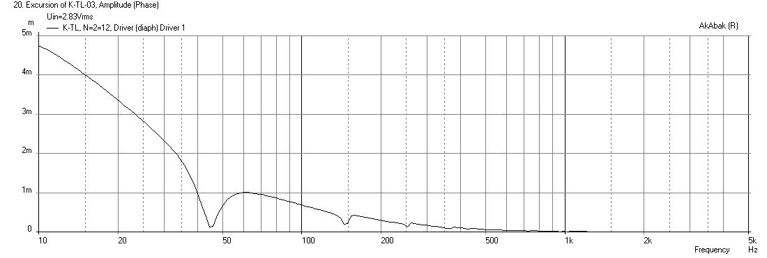

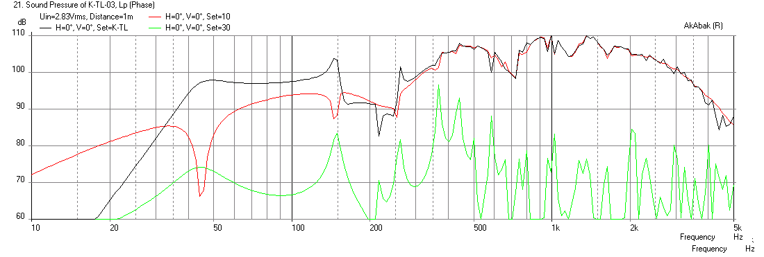

Here is the simulation. First plot is freq response in stock 12 in Karlsonator (full size, smaller did not work as well). It has a nice flat bass shelf and great SPL, but the higher bass and mids are a bit bright. Second plot, I boosted the vent by 2X scale to increase the bass output to balance it out but still not enough. It can work with a BSC or EQ'ing I think. Third plot and fourth plot are impedance and cone displacement, respectively.

Thanks for the sim and info, that was quick. I have them currently in a Bob Brines TL with a line level bsc so that doesn't concern me.
Can you explain what you mean by boosting the vent? Is that the space between the top of the fold and the top of the speaker? Also, if using a bsc which would work better? Is the vent something I can experiment with, or would that take a seperate build?

You are welcome. The vent is the narrow top constriction leading to the front chamber. The easiest way to make that bigger is to slightly reduce the length if the closed end of the TL top. An inch or two won't be that noticeable and it will expand the vent gap. You can then fine tune the gap by adding strips of plywood or whatever to reduce the cross sectional area. Line level bsc is best if you have it already. Good luck.

I was wondering about that too - maybe one of the T/S params I entered is off?
My guess would be only B*L or Mms could affect things in the midrange as they do here. It is getting close to 110dB, no way!
