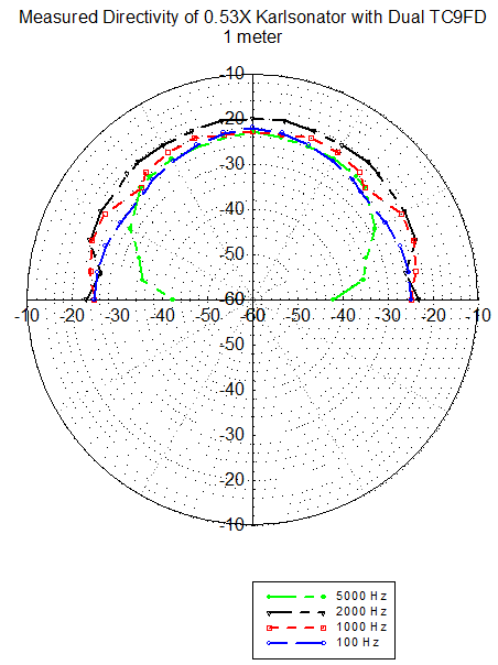

Directivity Measurements of Mini Karlsonator with Dual TC9FD
Squeak,
OK, here are the directivity measurements you have been wishing for... My PC sound card craps out at above 8 kHz so I am only presenting results up to 5 kHz. The human vocal range is really only up to 3 kHz and below that range is where 'spatial imaging' is really important for vocals. The measurements were made using a tripod mounted Panasonic WM61A mic capsule mounted at the end of a 12 in long 0.250 in OD aluminum tube, Holmimpulse was used, a ruler was used to set the 1 meter distance for each angle. The measurement height was 50 cm above the floor, speakers were mounted 2.5 cm away from back wall. The data was collected in approximate 10 deg increments and folded to produce 180 deg polar plot. The plot is shown with data at 100 Hz (Blue), 1000 Hz (Red), 2000 Hz (Black), 5000 Hz (Green). As you can see, the performance of the Karlson aperture appears to provide quite an even performance up to 2 kHz, and start having fall-off at 5 kHz when going past 50 deg off-axis. From what I can see, this is consistent with my subjective listening experience that the directivity is very even and has a large sweet spot. It is also consistent with statements made by other Karlson owners that a 100 deg to 120 deg wide HF horn is required to match the pattern of the bass and mids from the K aperture.
Are you closer to being a believer in the effect of a K-aperture on directivity?

Post #20
Hi IG81,
I agree w/ Squeak's assessment in Post #26, that the standard Karlson enclosure will not make full use of the Paragon style reflector. Maybe using two Karlson clams pointed at the reflector while maintaining the Paragon style dual low frequency horns, and some JBL slot radiators for the very high frequencies? In other words replace the JBL mid-frequency horns w/ clams?

First of all, thank you X for going through all the trouble!
I'd hate to sound ungrateful or be irritating but that isn't better than the regular dispersion pattern of that driver naked, up to 5 kHz.
I have no doubt that Karlson cabs are doing some things right. What I'm not sure of is what?
Maybe what it does to the lower registers changes the perception of the higher somewhat?
Anyhow, I think it is curious how there is absolutely no polar/dispersion measurements to be found anywhere on all the sites praising just the cabs ability to disperse, even the high frequencies.
Not even simple listening observations done on music or test tones are to be found.
That turns on my "pseudo science alarm". Not that I'm against loose empirical observations and tinkering (indeed I'd say that's the real basis of all science and engineering). But at some point solid measurements have to be made.
To be able to share your results to name just one reason.

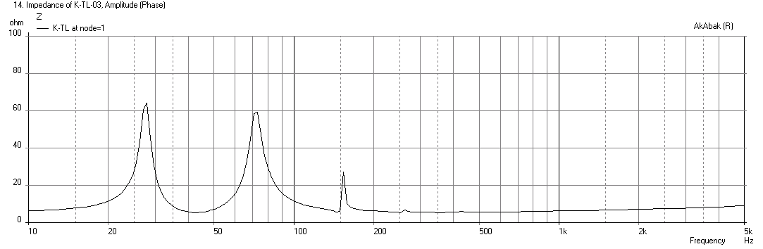

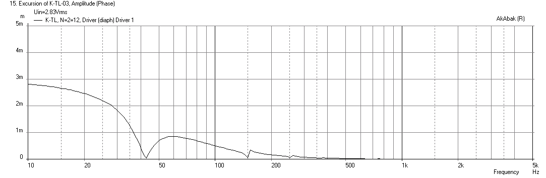

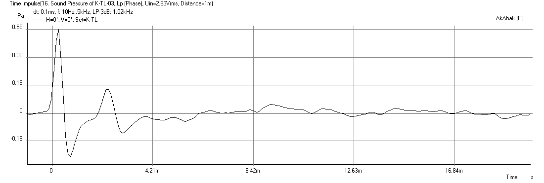

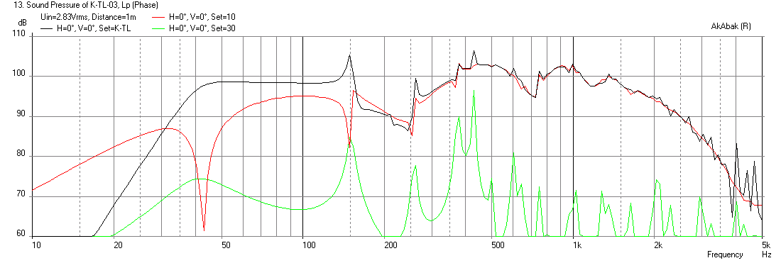

Karlsoator with Beta 10CX
Has anyone ever tried the Karlsonator with an Eminence Beta 10CX PA driver? This is a really nice powerful driver that seems attractively priced. It will need the coaxial CD for the built in horn, or add a K-tube CD externally. I ran a simulation and adjusted the top channel by increasing it by 1.3X to get more bass amplitude to balance it out a bit. The f3 is 39 Hz (95.6 dB at 1 watt 1 meter), not too bad. If I were to build a full scale K'nator, I think I might go with this driver for a bang for the buck consideration.
First plot is freq response at 1 m, second is impedance, third is cone displacement (well controlled), fourth is impulse response (very clean).
The flat bass shelf on this combo can't be beat (IMO).
