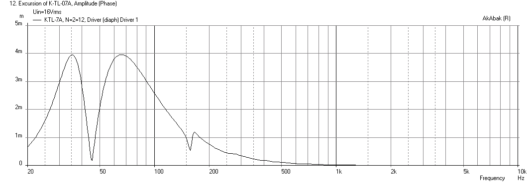

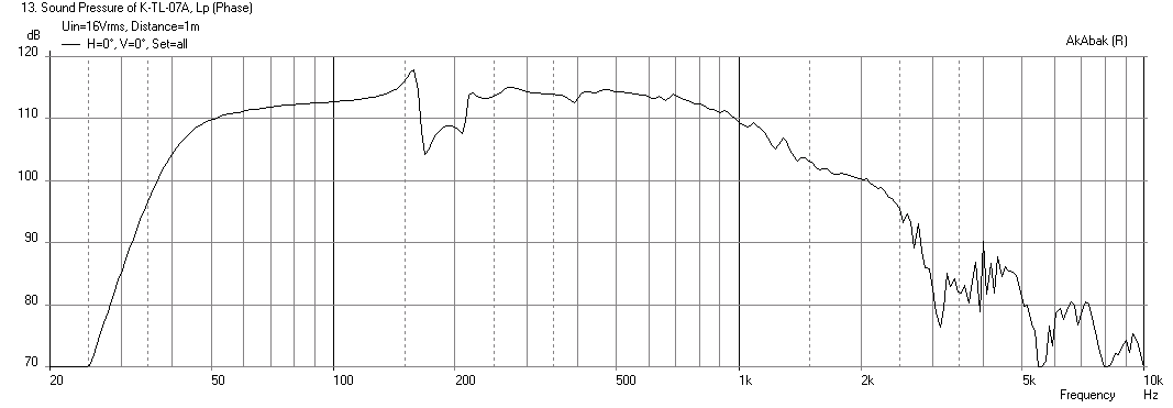

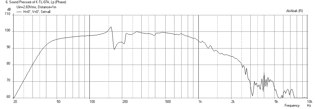

Sim of Buehgemeiste's driver in Karlsonator
This driver has a very large Vas, consequently, you need a specially modified Karlsonator 12 for it to work properly. Basically take the design and scale the depth by 1.5x. It will a deep speaker at about 23in deep, width and height leave scale alone at 1.0x per plans from GregB.
Here is SPL at 2.83v and 1m:
Here is cone displacement with 39Hz 24dB/oct high pass filter and 16 volts:
Here is corresponding max SPL:
You can see that the cone motion is not well controlled and hence max SPL is limited to about 110 to 112dB. Also, the HF fall-off may not be high enough for you to XO with a piezo horn tweeter - as they are typically above 2kHz.
