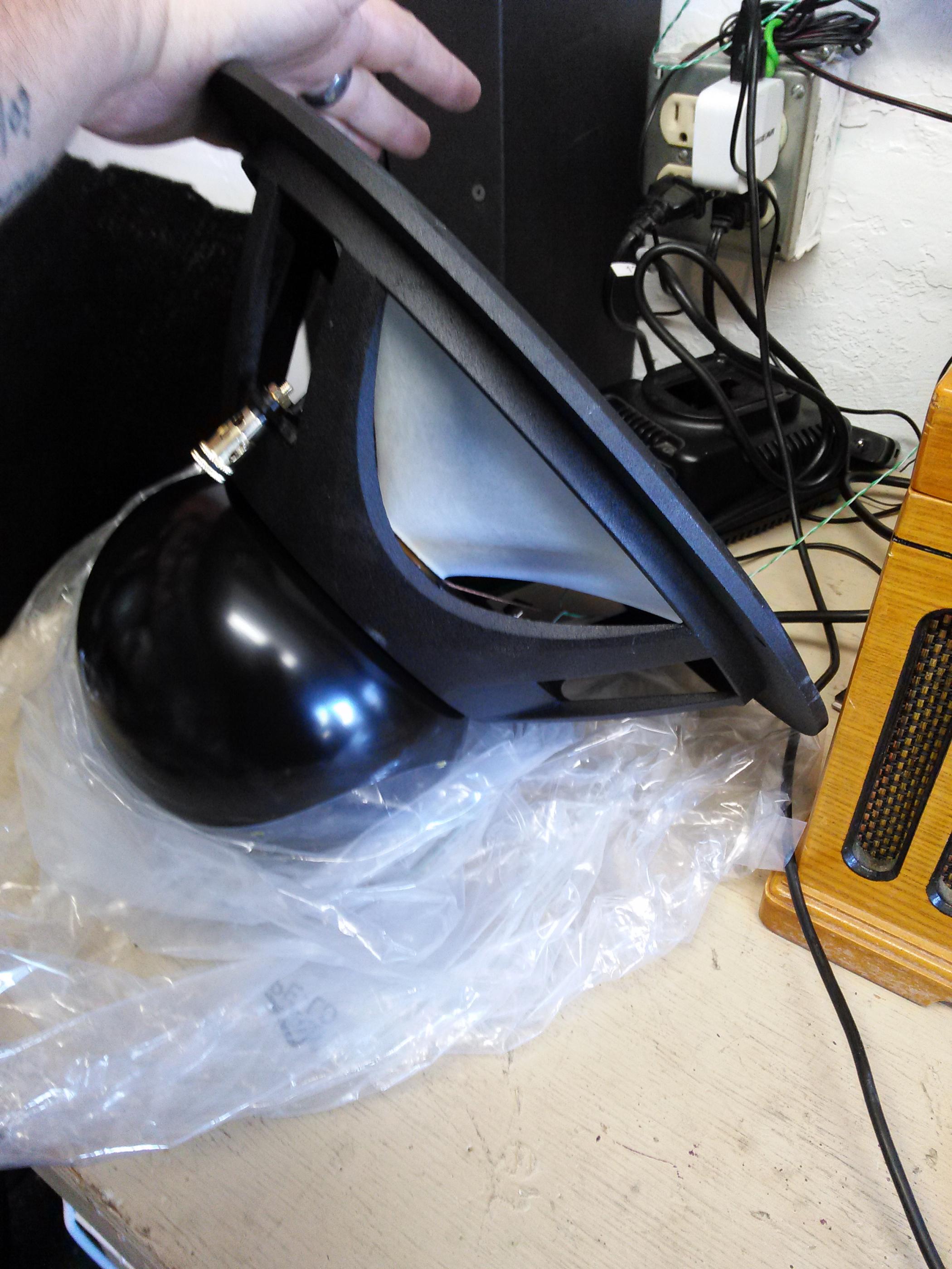

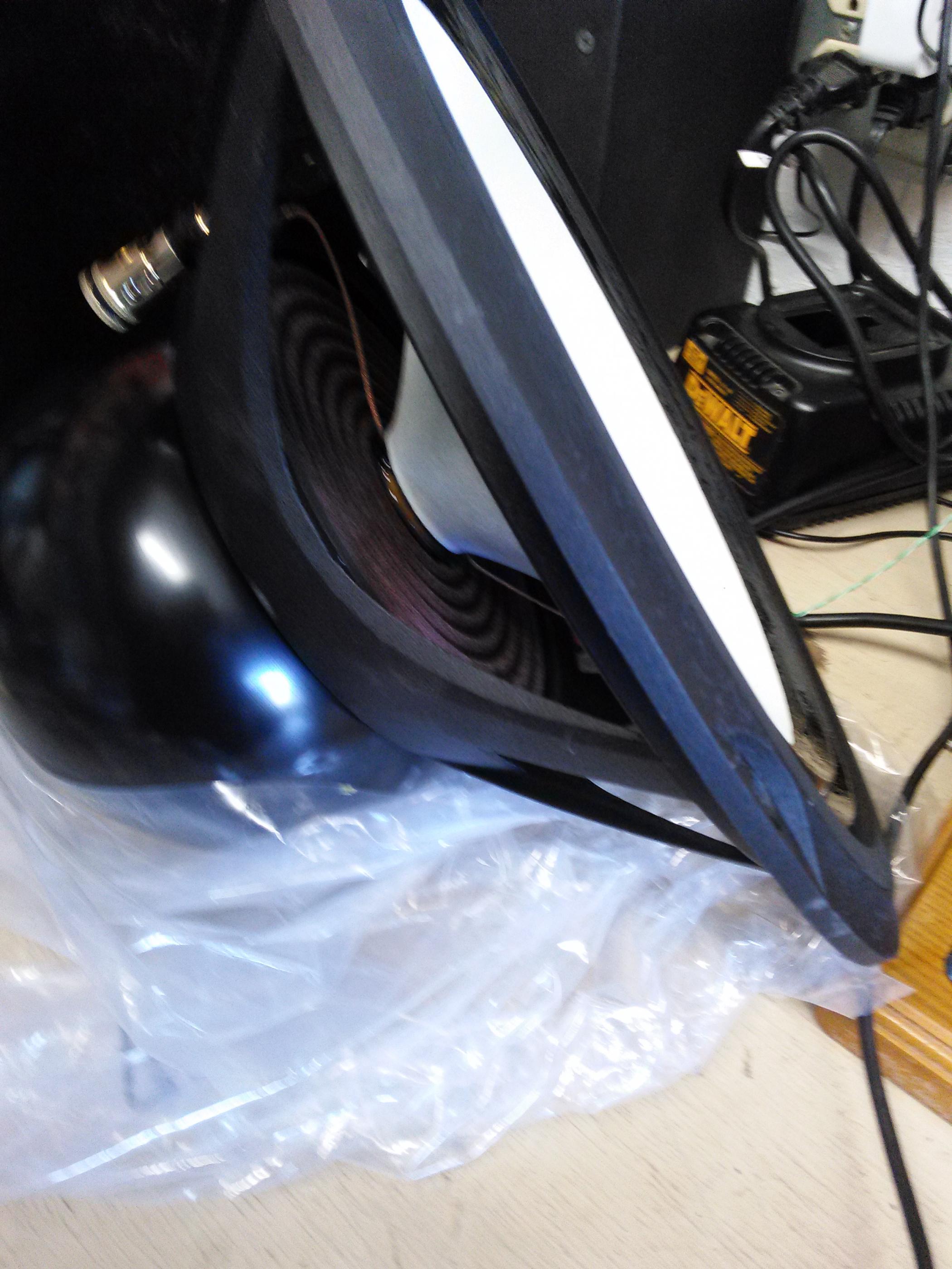

My only concern is that due to the large magnet/rear assembly, some modifications may need to be made to the overall design, possibly stretching the area behind the driver to accommodate it. Maybe the volume of the magnet would need to be taken into account anyway, and the cabinet made correspondingly larger?

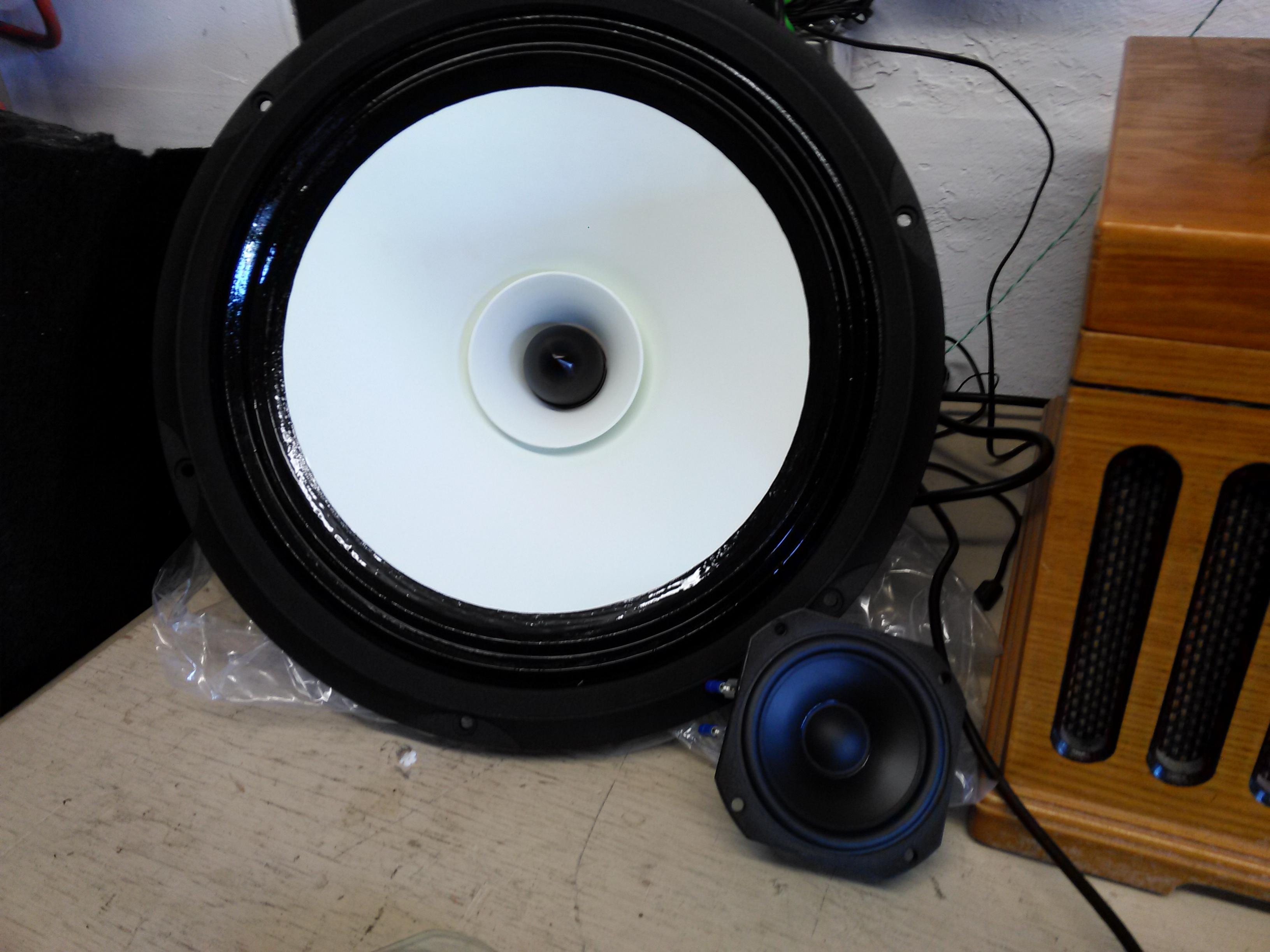

So, I couldn't help myself, and felt like testing out these drivers (12" UR330B8-11F) so I hooked them up on the workbench, no baffle, no nothing.
They sound absolutely wonderful, lack of bass from being open air of course taken into account. The shadowed areas of the off-white cone show an eery sage/greenish tinge, that is quite pleasant too. Very natural sound from a whizzer cone. Aluminum phase plug.
I can't wait to build these up into a huge K if they will work!
Posting some pics. I have a ubiquitous Vifa TC9FD for size comparison.

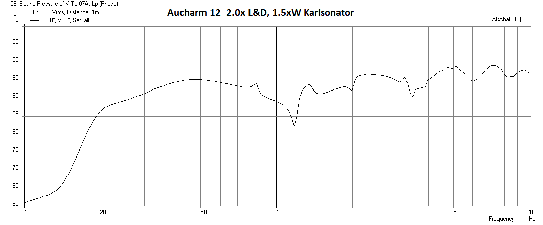

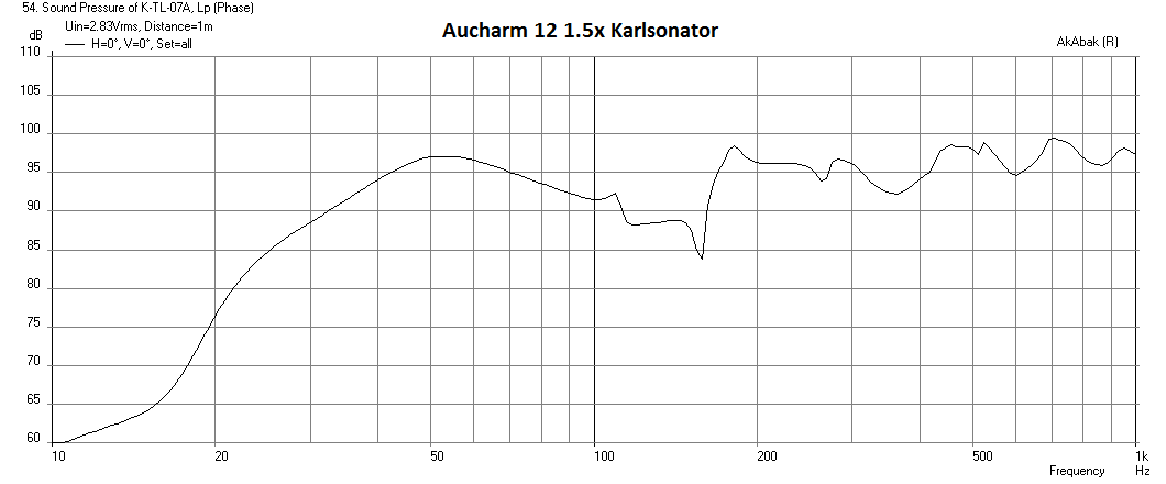

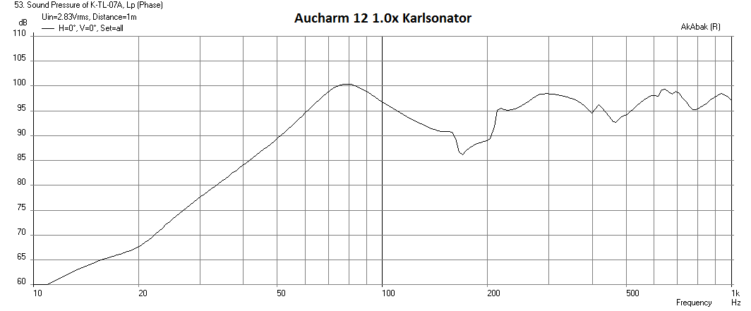

I just ran the simulations for this driver and it is not really suited for a Karlsonator, as I suspected. In a normal 1.0x scale (standard 12in Karlsonator as designed by GregB) the volume is too small and there is a huge bass overshoot around 50Hz and a big dip at 150Hz. As you scale up to a rather large 1.5x scale cabinet, it still doesn't look great. If I make it 2.0x scale in height and depth and 1.5x in width, it is a bit better but still not the best. These are terribly huge cabinets and I would not recommend it. I would use these for their intended purpose in maybe something like the cabinet used in a Saba Greencone (tear shaped cross section largish volume - make same as Vas at 229L and open bottom with a 2in gap from floor) or Rondo.
Here are the predicted frequency responses at various scales:

I figured it was a bit high Qts and would be large, but that response graph looks pretty funky and would likely need lots of EQ (which I'm not really set up for, or too hot on other than BSC or analog solutions) and it would be prohibitively large for sure.
Maybe I'll make a new thread for them and see what the groupthink ideas will come up with for any other possible box designs. I like those Rondo styles, but I'm not set up to do anything advanced in woodworking, like bent panels and curves.
